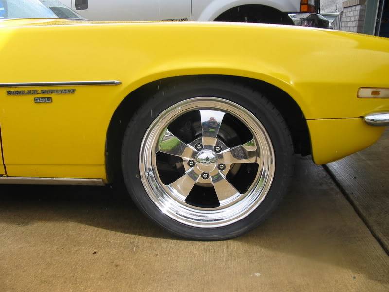

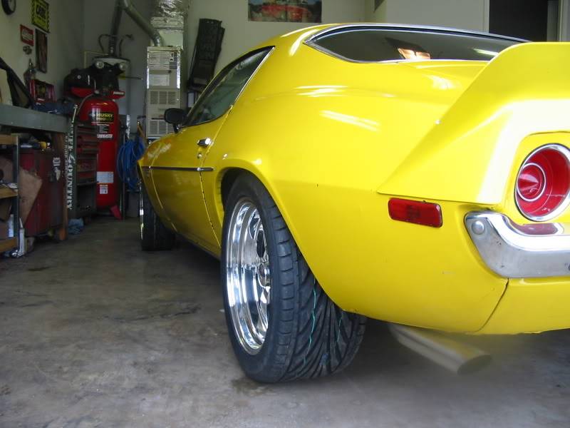

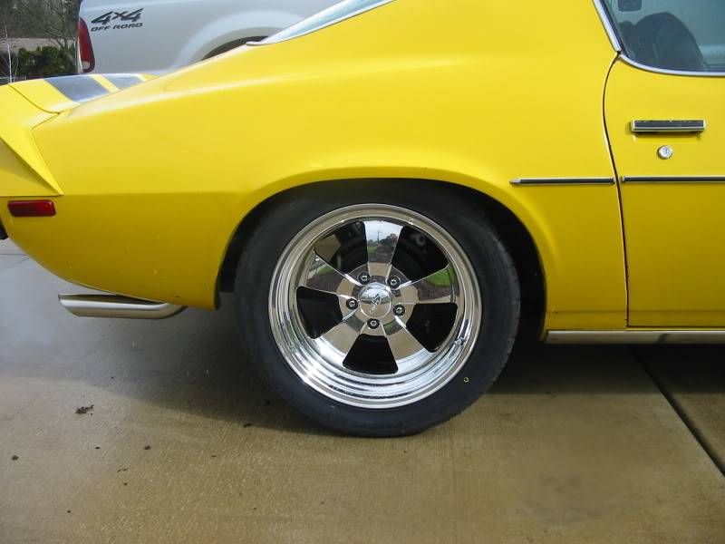

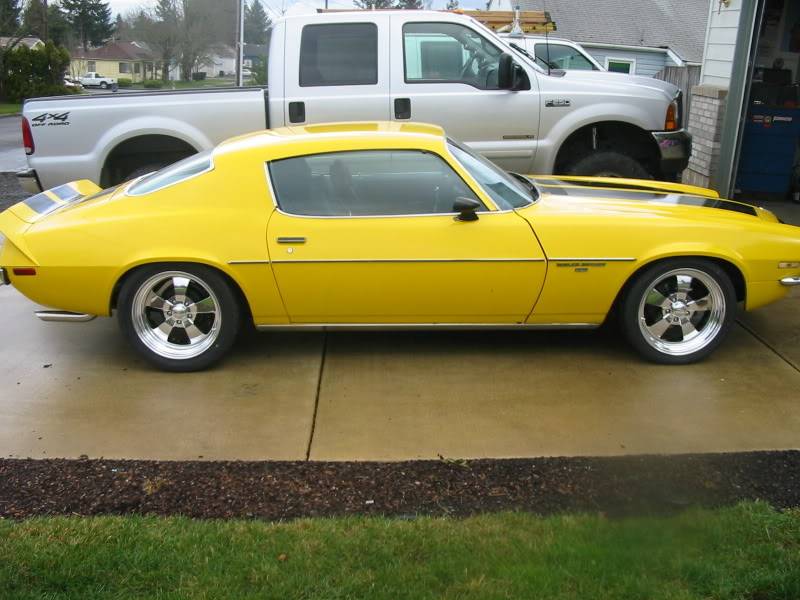

      got my intros
      finally got my car back together. new wheels, tires and suspension.

      looks good...nice choice.
      I'm trying to envision how they would look with brushed or p/coated centers...

      Nice,what size rims and tires are those?

      Very nice. Looks good and I really like the yellow. Send me some pictures to my email address ([email protected]).

      fronts are 18x8 245/40-18
      rears are 18x9.5 285/40-18

      Nice looking wheel

      looks killer.. any idea on the backspacing?..my 73 needs some new wheels..

      Nice choice, looks great.

      5.5" on the rear
      4.75" on the front

      man your car looks tuff as nails !!! What exhaust tail pipes r you running?? those look killer

      thanks, the exhaust is a flowmaster header back kit, the stainless tips were on it.
      got it from summit, part # FLO-17149
      it fit the car really well.
