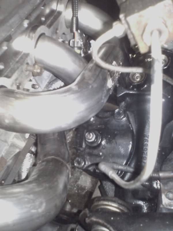

      Ok so its a 68 Camaro with 327 frame stands and Stainless Works Headers, using the 62500 solid motor mounts, the conversion plates are cheap ones from ebay they are just like the ones below except they are 3/8" thick. I am running a 80's fast ratio ps box but i believe it is the same size as the original. The #1 tube is the closest to the PS box and I have a solid 3/8" clearance.

      Looks great. Lots of room.
      Which trans mount are you using?
      How much firewall clearance?

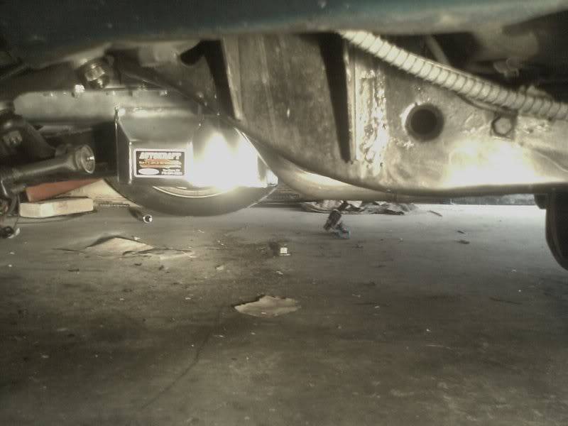

      Ok, but how low are they? All the headers I've seen hang at least an inch below the frame and I can't have that because I already scrape on speed bumps if there's someone in the passenger seat.

      I will try to snap a picture of how low the headers hang.

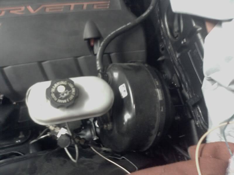

      I'd like to see a pic of that 4th gen booster installed and what modifications you had to do (if any) to get it on there. Did it all just bolt right up?

      The booster was not terribly difficult but does require modifiction. I had cut of the studs on the 4th gen booster, then weld on some extra metal and drill some new holes for the studs to go through to line the pushrods up. I then cut and welded the new and old pushrods together. The only thing I would do different is use a c5 master cylinder so that the lines exit away from the motor.
      I think it was well worth it and it works great with my c5 fronts and 4th gen rears.
      Matt
      Anyone? How bout some under car shots to see how low the headers are.
      Matt
      Colorado
      94
      Here is a quick shot I only have the camera on my phone so sorry about the quality. The oil pan is even with the front cross member and the header are about even with the pan maybe a 1/2 inch lower. They are about a inch lower than the subframe.
