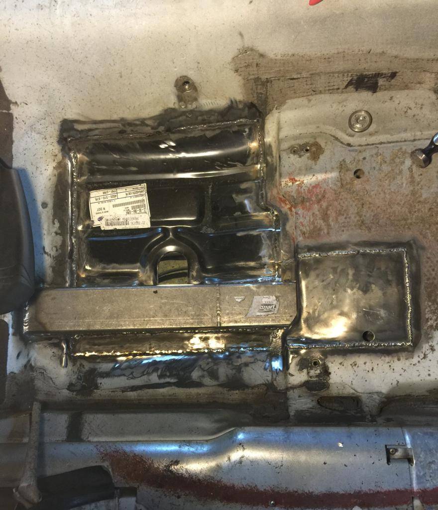

      With a friends help I was able to get the drivers side subframe connector installed.

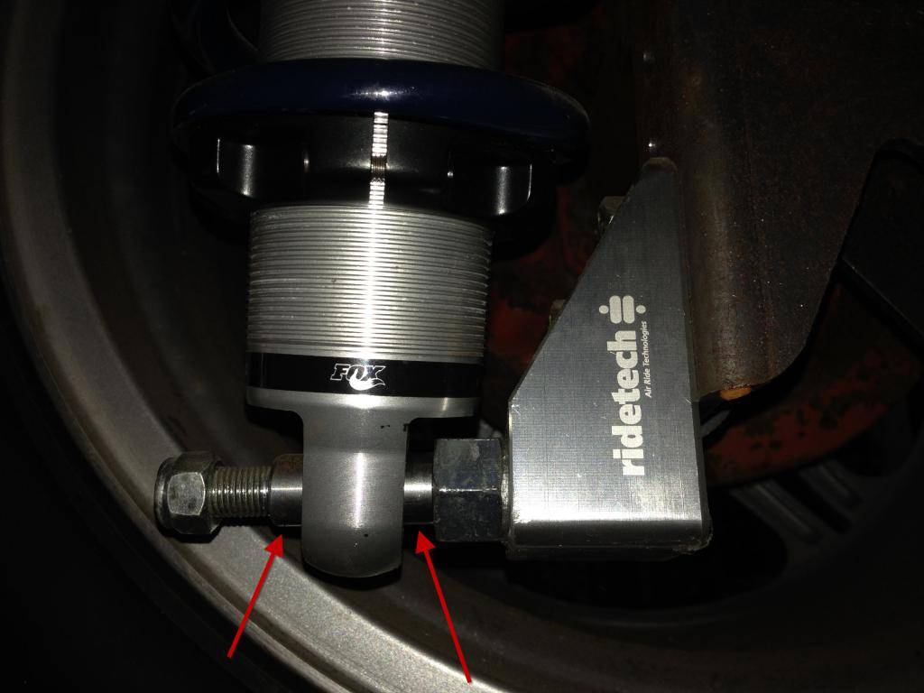

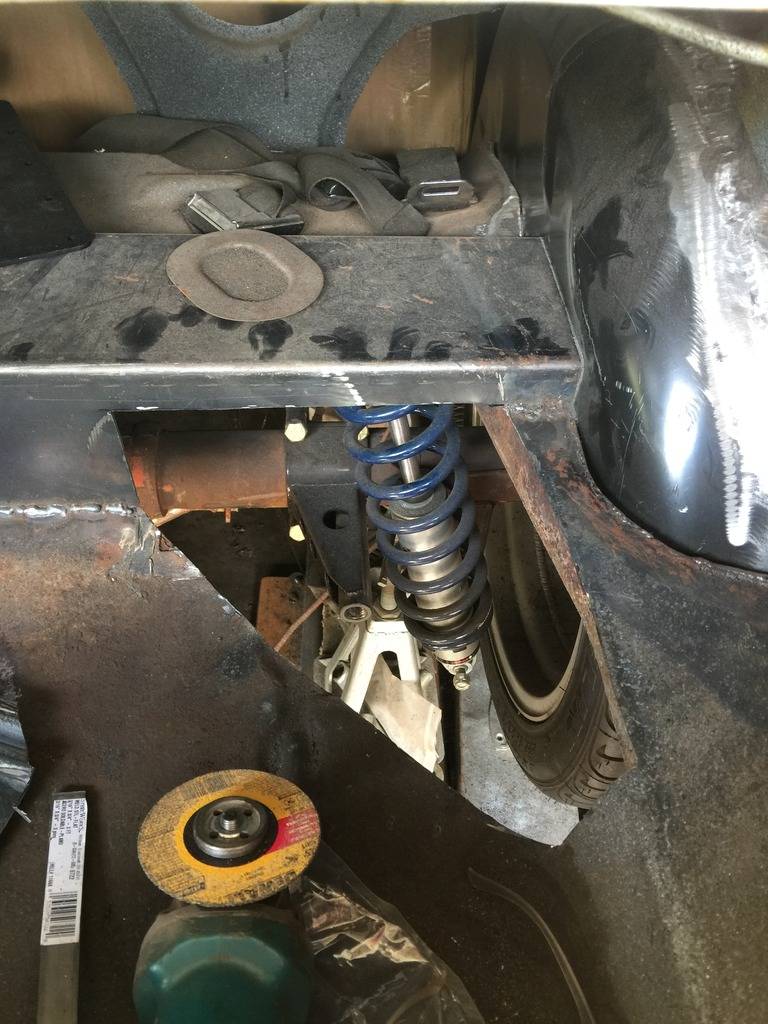

      Can someone explain what type of spacers go on either side of the coilover shock and where to get them?

      Quote Originally Posted by Jimmy Sean View Post
      Hi Sean, nice work !
      Not sure but may be something like this
      http://www.summitracing.com/parts/ar...FeRj7Aod3HAAjQ

      Finished the passenger side subframe connector install.

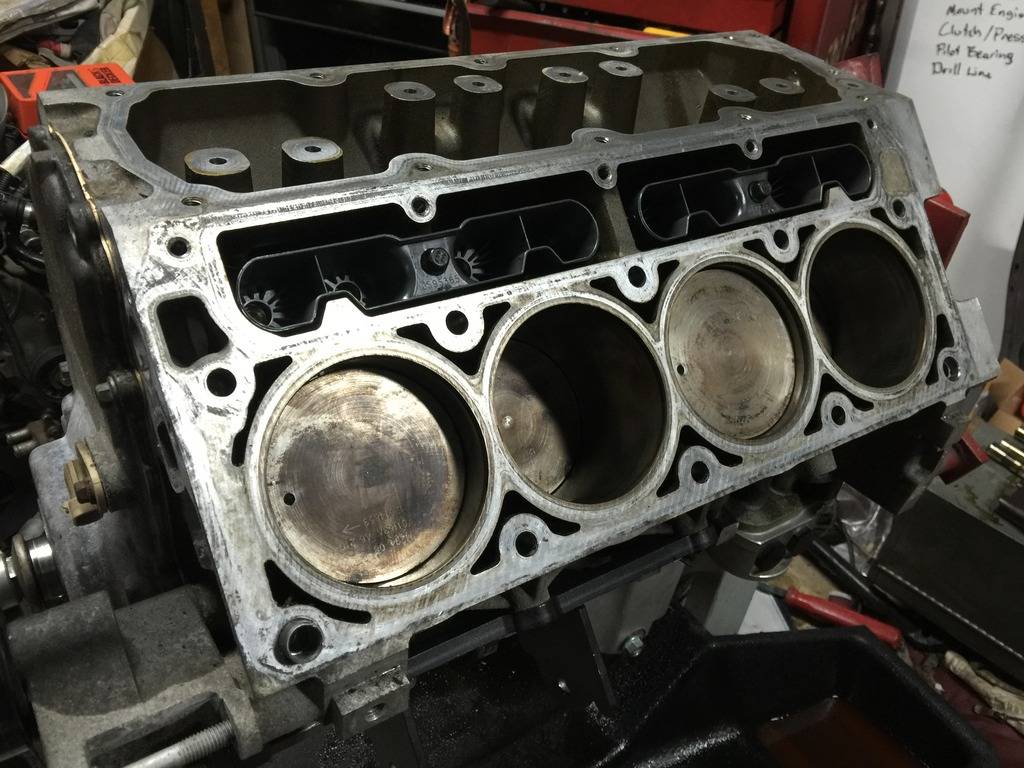

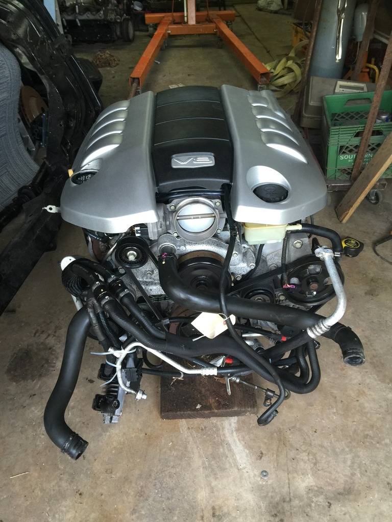

      I have been working on the firebird off and on over the past year but have not made much progress towards getting it back together. Both the 5.3L and 6.0L truck engines have broken rods. My father-in-law who has been helping me fund this project offered to buy another engine. We purchased a complete takeout engine, harness and computer from a 2009 G8 GT that had been wrecked. I had the computer flashed by Mike Norris and the harness reworked by John at Modern Vintage Systems.
      Earlier this week we found out that he will not survive the cancer he has. He beat the cancer the first time but this time it is not treatable. Our relationship in the past was not all that great and I’ll leave it at that, in the past. The past few years though have been great and we have connected around this car. I hope that I can at the very least get it running so he can hear it and at best get it in a drive-able condition so that I can take him for a ride in it.
      So the plan is to get it running as fast as I can and then focus on getting it in a drive-able state maybe not legal but drive-able.
      I have order some parts this past week for reaching the goal of getting it running but still need to order the intake tube, headers and some misc. fittings for the fuel system. Then I’ll need to purchase a rear suspension system, hopefully the torque arm system from Speed Tech.
      More updates to come.

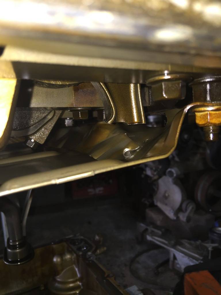

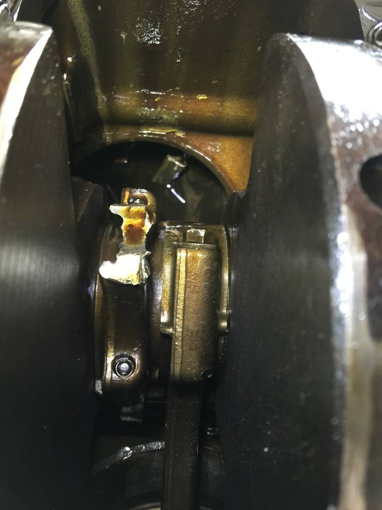

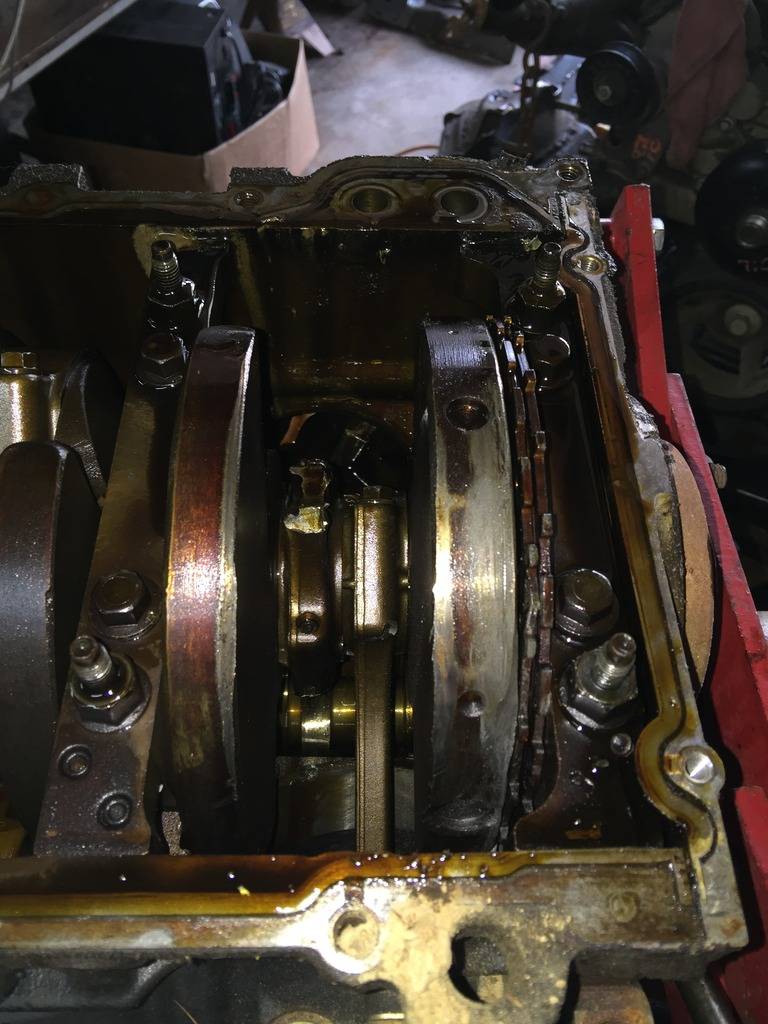

      Here is the 5.3L's broken rod.
      And the 6.0L broken rod and mangled crank.

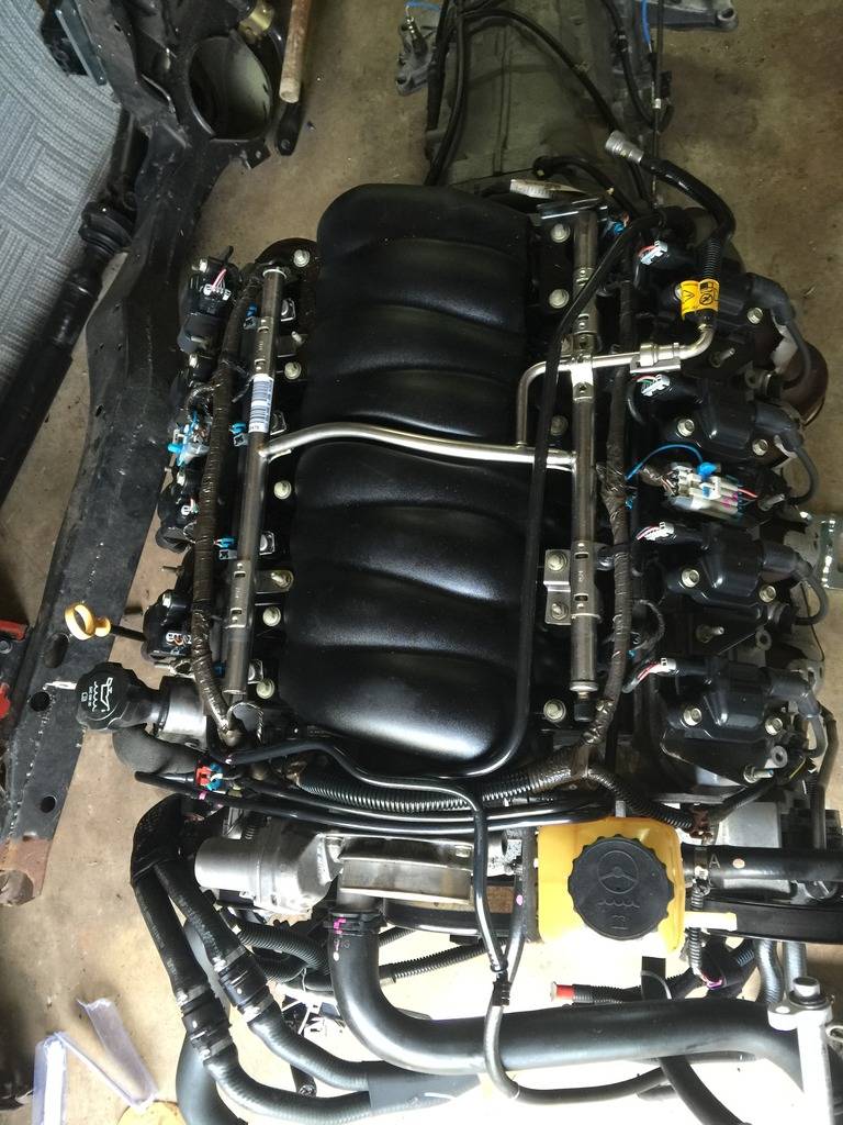

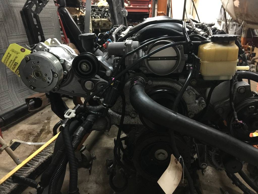

      The L76 from a wrecked 2009 G8 GT

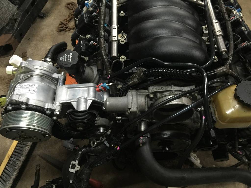

      Test fit of the Holley A/C bracket and compressor.
      Checking the clearance from the alternator and the Holley motor mount bracket. Just enough to get the nut on.

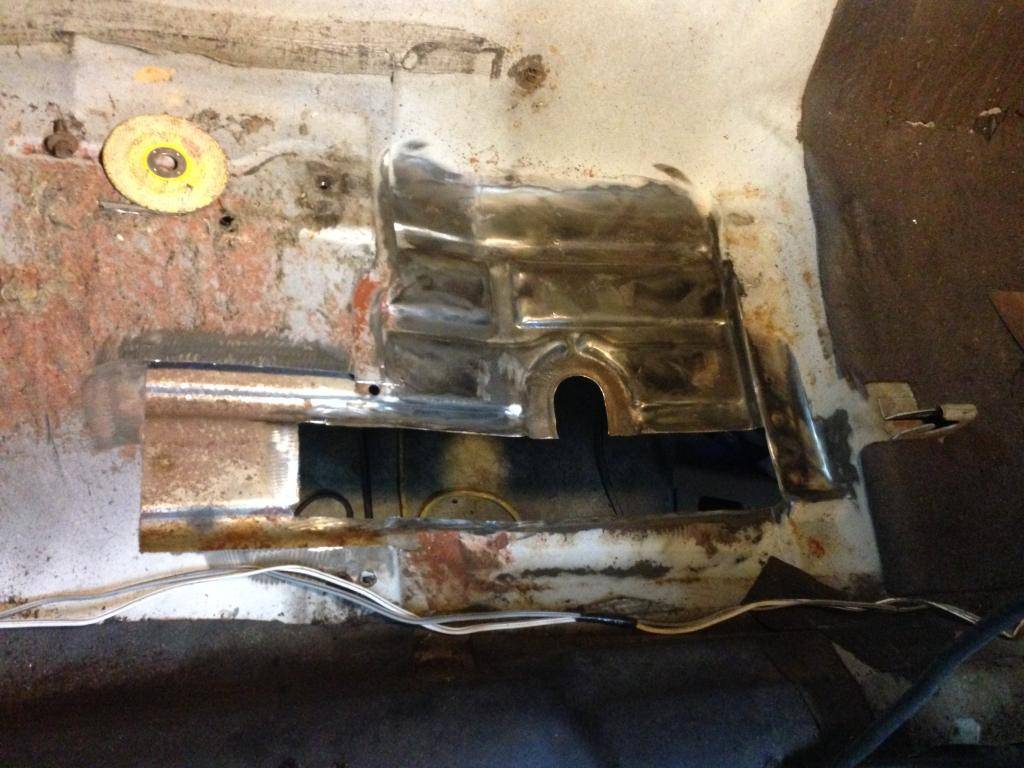

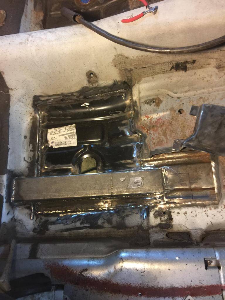

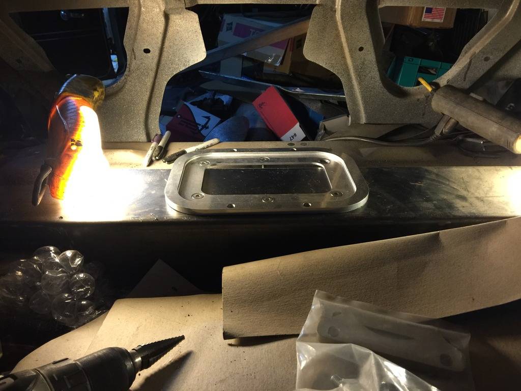

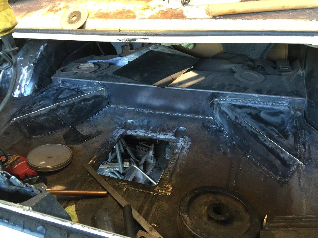

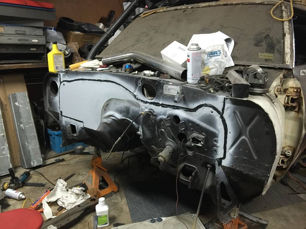

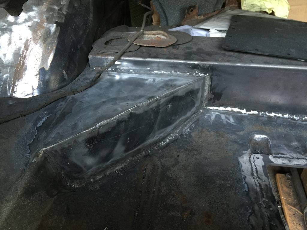

      A few weeks ago I was able to get some work done on the trunk.

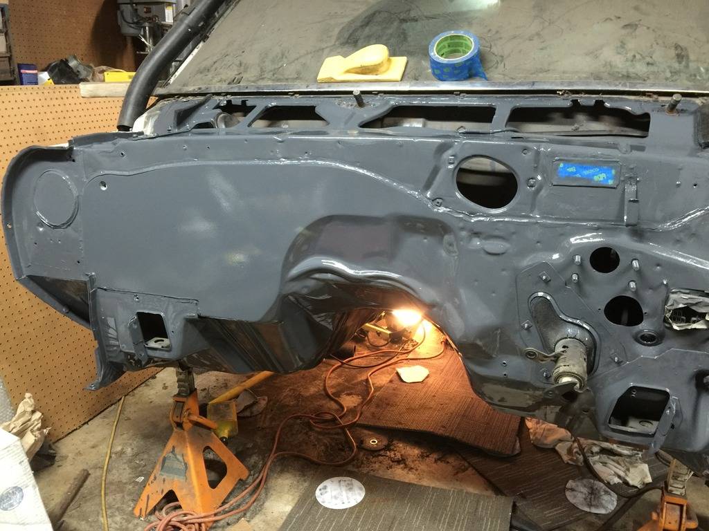

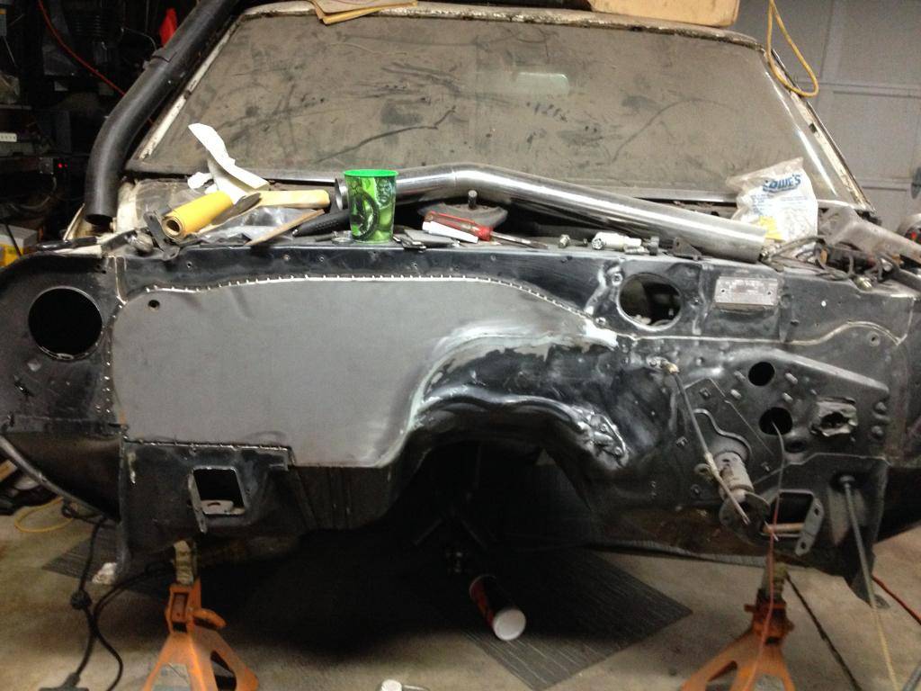

      And this past two weeks I have been working on finishing the firewall and sanding the floorboard. I was able to get the firewall, floor and subframe painted last night. Very happy with how it turned out.

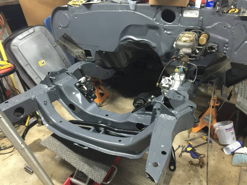

      Here I got the subframe paint (by my kids) and mounted.

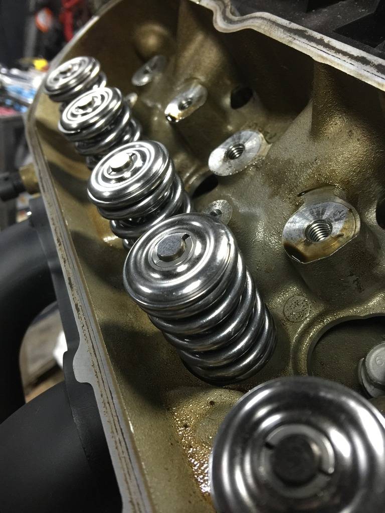

      I took the top end off to swap the cam and remove the DOD.
      The engine has 145 thousand miles on it.
      Dual Valve springs and titanium retainers.

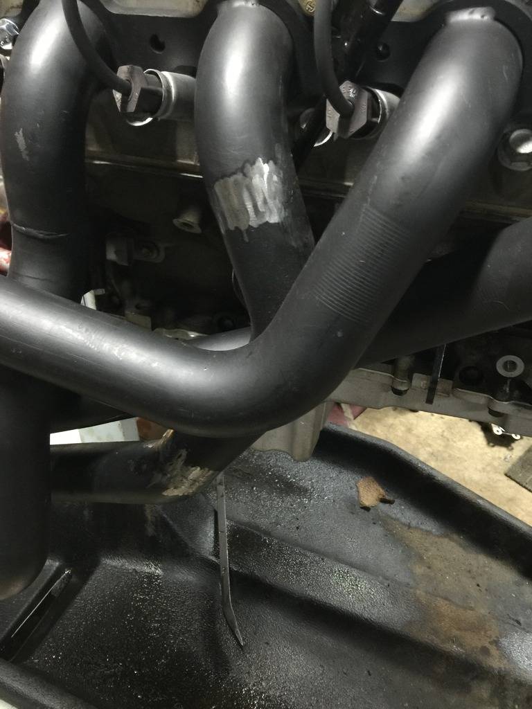

      Modified the Passenger header to clear the Tru-Turn.

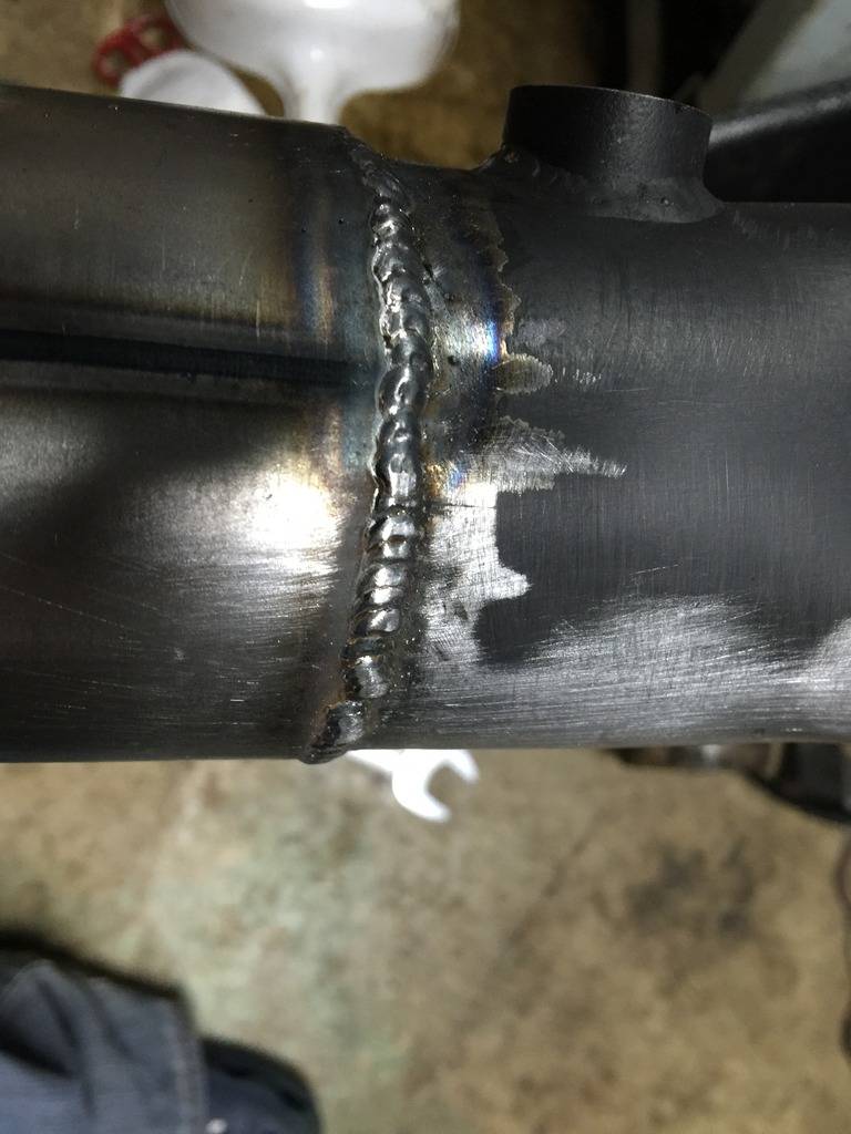

      Welded on reducing collectors onto the headers.

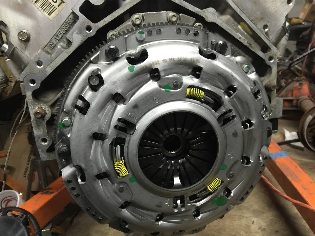

      LS7 Clutch Kit
      Engine and T56 mounted

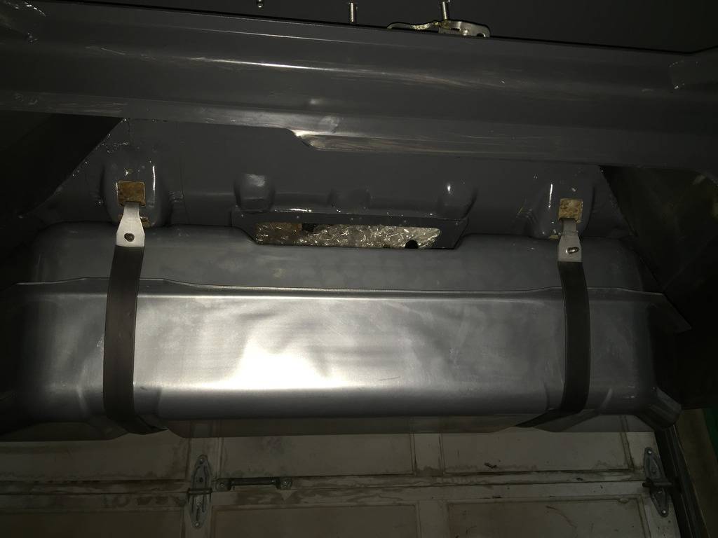

      Mounted the Tanks Inc gas tank, used electrical heat shrink in the straps.
      Trans mount and torques arm mount.

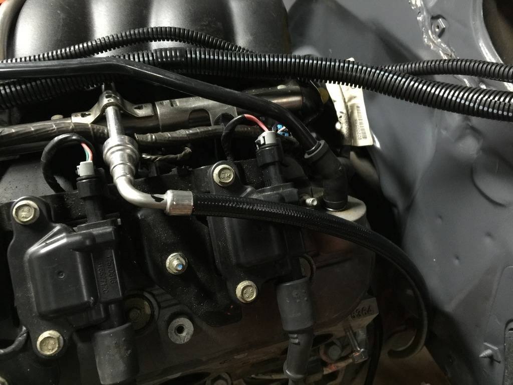

      Fuel line

      Did you get our spacers for the coilovers? If not, give me a call and I'll make sure that you get the correct ones. Car looks great by the way!
      Ridetech Suspsension
      Tech Specialist
      Phone: 812.481.4734
      Project Fox
      1979 Trans Am
      Missouri
      344
      Quote Originally Posted by Josh@ridetech View Post
      Yes I did. Thanks.
