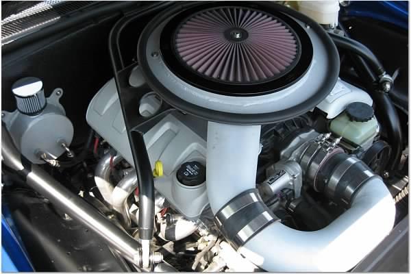

      How is the filter held in place? Pix?
    3. #343
      16,129
      Quote Originally Posted by cdoggy81
      Great pics & a cool trip for sure!!!
      How do you like the 550# springs? You had 450# from QA1 right?
      The 550s are great. 450s were a little soft for my taste. If you already have the 450s, give them a shot. They are easy to swap.
      The filter sits in a large hole that is sized for the filter. On top there is another flange that goes around the whole perimeter of the filter which bolts to the base.
      Yesterday I spent some time cleaning up the welds on the air intake tube and on the base. I gave it two coats of rattle can primer, follow by two coats of satin black. Turned out pretty good. I could have spent more time smoothing the welds but I am happy with the way it turned out.

      that engine looks awesome! I love the way that air cleaner assembly looks and works! very nicely done as usual!

      Shaker set up looks awesome . They did a nice job

      Very cool Andrew. That is an awesome looking induction setup.

      Question - what is the advantage of running a stock type LS intake and piping the TB up to a carb style breather vs. using a carb style intake converted to fuel injection with a carb style throttle body?
      Excuse my lack of knowledge. I can see the carb stypel setup being more expensive. Also, the stock ECM may not like the carb type throttle body.
      Any insights?
      Brandon Wiedeman
      1972 Suburban
      Wiedo's
    13. #353
      16,129
      Quote Originally Posted by wiedemab
      Any insights?
      The single plane intakes are aluminum, so they are heavier and heat up more. They also have shorter runners which hurts low end torque. It would also be hard to mount the MAF. The other issue is that newer LS engines that have the 58 tooth trigger wheel can't be configured to work with a cable operated throttle body. Jeff Schwartz has adapted a DBW throttle body to a single plain before, but I just didn't want to do all that.
