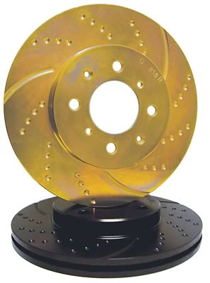

      Trying to decide if I want to do this. Share some black rotor pics please!

      EBC rotors are advertised as black zinc plated. Will that wear off??

      Sure will. It's only a plating. As soon as they wear in, that plating will melt off. And it sure as heck wont make it past the first time you have to have them turned.
