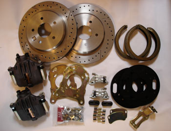

      KORE3 has a rear C5 setup with e-brakes.

      http://www.kore3.com/proddetail.php?prod=10277-01

      As of right now...Kore3 is the only C5 rear brake kit for our 2gens that has a backing plate ass'y to use the ebrake....at least that I'm aware of. Ed? We need ya man ;)
      I am currently ebrake-less. But here in Va you need a working ebrake to pass annual inspections.

      I'm in the process. I cleaned and reorganized my shop all week so now I can actually find stuff. I have a lot of orders on my table that need to get out ASAP but I'll try to get this C5 rear swap finished as soon as I can.
