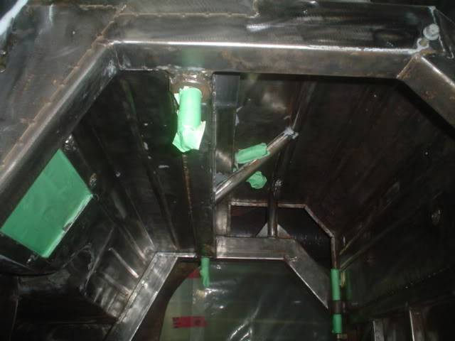

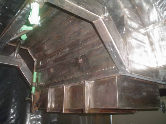

      Getting back to working on the car after a beautiful hot summer up here.....good for business and for the boat....got a custom made new boat trailer....sweet......I cant go further with the metalwork on the car (fitting the missing left front fender in the previous pics) until I get a roadrace set up in it.
      Right now the car still has the as purchased oval set up in it which has a 1.5" shorter wheelbase on the left side as opposed to the right side....this will not allow the LF fender on.
      I have to take it to a race shop to have the set ups changed and underneath the car looks like h ell.....untouched since I bought it.....I will not bring it to that shop the way it was looking so I needed to re do the floorpan.....everything came out and I got to it.

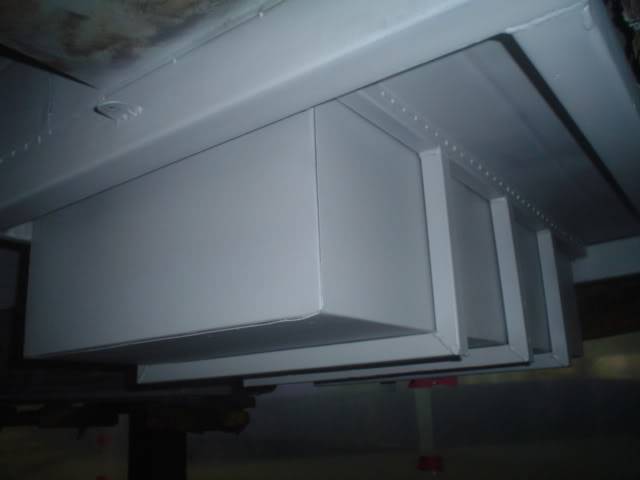

      Thought about getting it blasted but the only guy around who does anything other than just sand prices are insane....so I decided to wire wheel it.....these things are just wiped down and painted no primer, certainly no undercoat.....for the most part the paint just flies off.....used my mini sandblaster in a couple of places. some pics
      89 Iroc 406 Fitech 5 spd
      31 Scarab 2 x 454
    18. #118
      oshawa ontario
      1,607

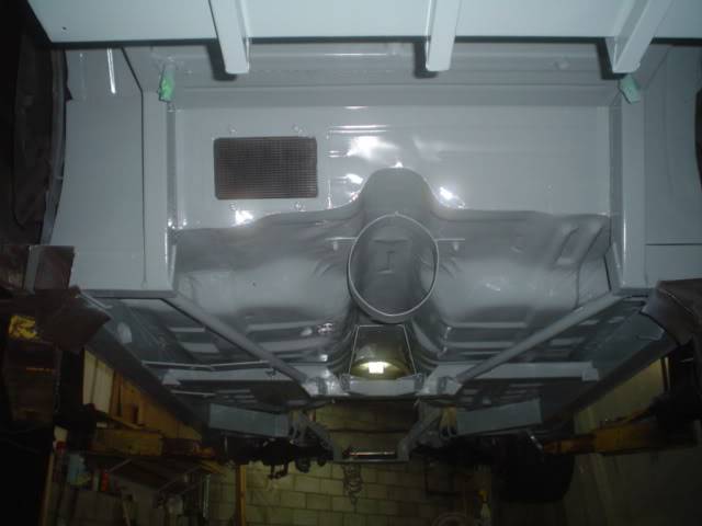

      Used "Rust Check" spray bomb primer after a good blast with air and a REALLY good wipe down the de natured alcohol.....your supposed to be able to prime over rust then paint, it dissolves rust.....Rust Check is a Canadian company and very respected up here, not sure if its available in the States....Ive done my own test.....I coated a section of exposed out door black iron gas pipe with this stuff in '06....and after four years of sun, snow and rain just this year the exposed primer (no paint) is just starting to get a couple of rust bubbles.....Im pretty impressed....the only thing is it takes 3 days to dry at 60deg F shop temp.

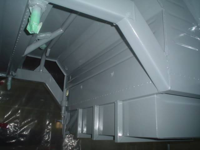

      I also hand bombed Armor Coat Misty grey as a finish.....same stuff as the front end in the previous pics......just the right color.....good gloss....and the best thing is with the 2 post lift any scratches are easily repairable...now I need to get the thing re assembled and get it up to the race shop before the snow flies really badly
      In the bottom pic the black rectangle thing is the back of the rearend oil cooler....air is brought in through a Naca duct in the Left Rear quarter window and exits there.
      Notice the two driveshaft safety loops and the hollow left frame rail.

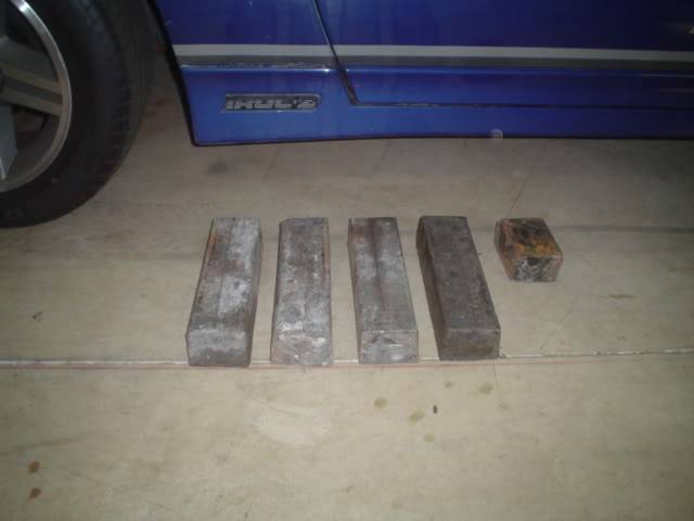

      Oh Ha....Speaking of a hollow left frame rail......
      I pulled 220lbs of lead out of that rail!
      Talk about a car thats built light!
      Theres one lead brick missing in the pic but one brick weighs 42lbs.
      They fit perfectly inside the frame rail almost no side to side movement.
      Their very heavy...I had to pound them out from front to back with a long 1x1 and a 6lb sledge.
