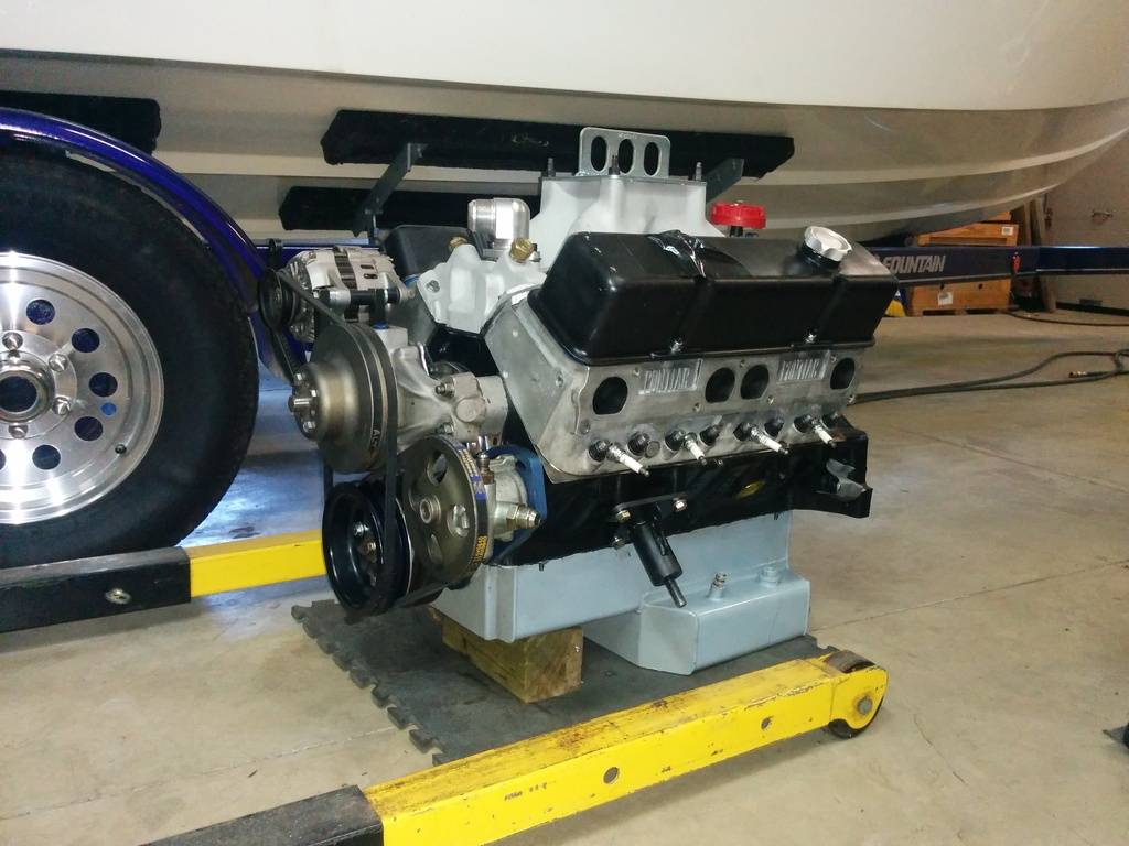

      Last Nov I had the heads pulled for a freshen up. Engine builder found a crack between two of the cylinders. The one side already had a sleeve. Engine taken further down builder showed me some places where the crank had been repaired.....*&#%!!! So in March a new replacement Dart Iron Eagle block and complete Eagle forged rotating assy was ordered and assembled. Took 3.5 mos to get the block BTW. Mid August I got the completed engine back
      89 Iroc 406 Fitech 5 spd
      31 Scarab 2 x 454

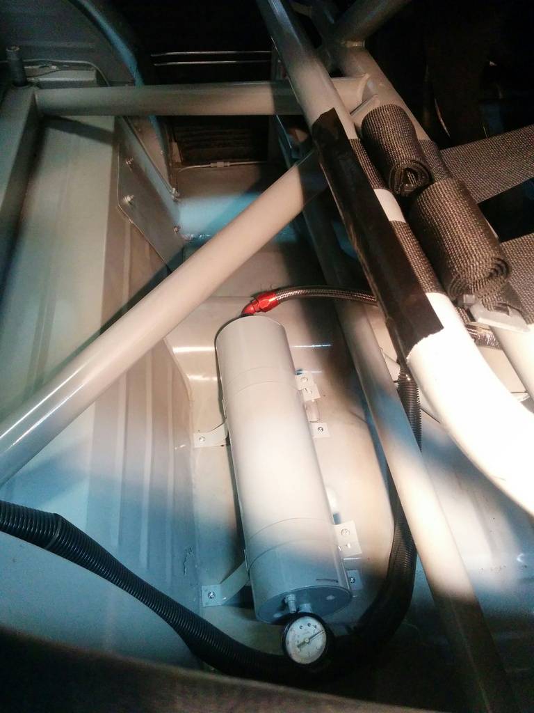

      Ok....got the engine all in and everything connected. Installed the Moroso 2 quart accumulator. The Dart Iron Eagle 434 block has a remote oil filter set up as there is no oil filter boss on the block like a standard sbc. So as instructed I plumbed the accumulator into the return line coming back from the filter and oil cooler. Mounted the tank behind the passenger seat with a manual shut off beside the shifter.

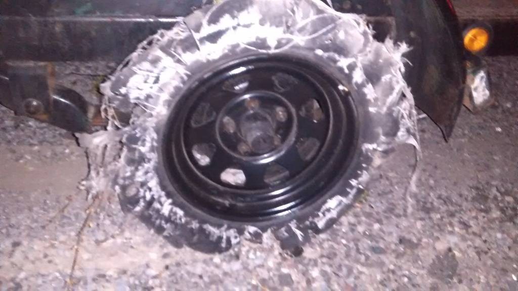

      Ten quarts of Mobile 1 20/40, a new Wix filter and a shakedown on a Friday at Shannonville Motorsports Park near Belleville Ont. Its 1.5 hrs from me, Its where I spent 80% of my motorcycle roadrace career so Im very comfortable there. However it ended with a flat on the trailer on the way down. lol FAIL! By the time that was sorted out track time was over.

      So next session we'll pick the pace up. Get out there, step on it....shifting is good, great actually . But on some of the long right turns the the oil press drops to 20lbs...not 0 like it used to before the accumulator installed but still not good. Left turns are MUCH better However it handcuffs me on turning the wick right up for some fast lap times but so be it. It did allow me to go fast enough to get some heat in the brakes and man do these things BITE! wow! Last time I had the car out, under braking the whole car would shudder violently and dart from side to side. Did neither of that today thumbs up!. Cont....
