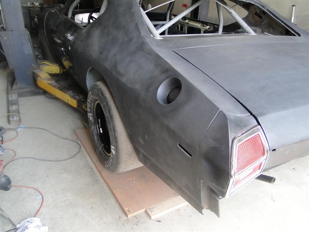

      Cut out the recessed fuel fill out of the race cars fender , reinstalled it on the Chevelle. Instead of using a dry break ordered a fuel cap from the Allstar catalog....bolted right up to the recessed flange no problem.....gotta love stock cars. If I ever decide I want a dry break I'll unbolt the the gas cap and bolt one on.

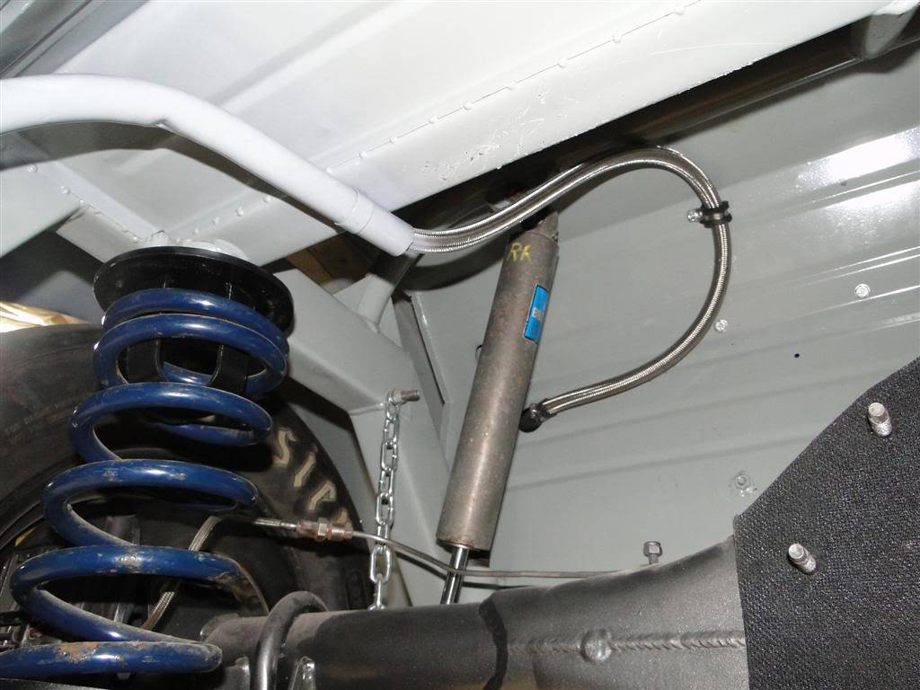

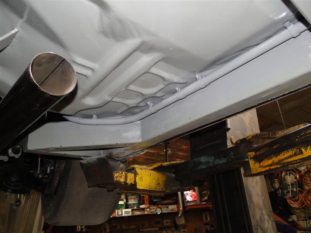

      The delema Im facing now is whether to run the fuel/brake lines through the interior (more protection) or attach to the frame underneath the car (less cluttered inside the car and more street friendly) All the race guys say absolutely through the interior from a protection standpoint but hundreds of cars are tracked and have no problems with the lines running under the car....I'm thinking of running them through some sort of conduit under the car for protection.

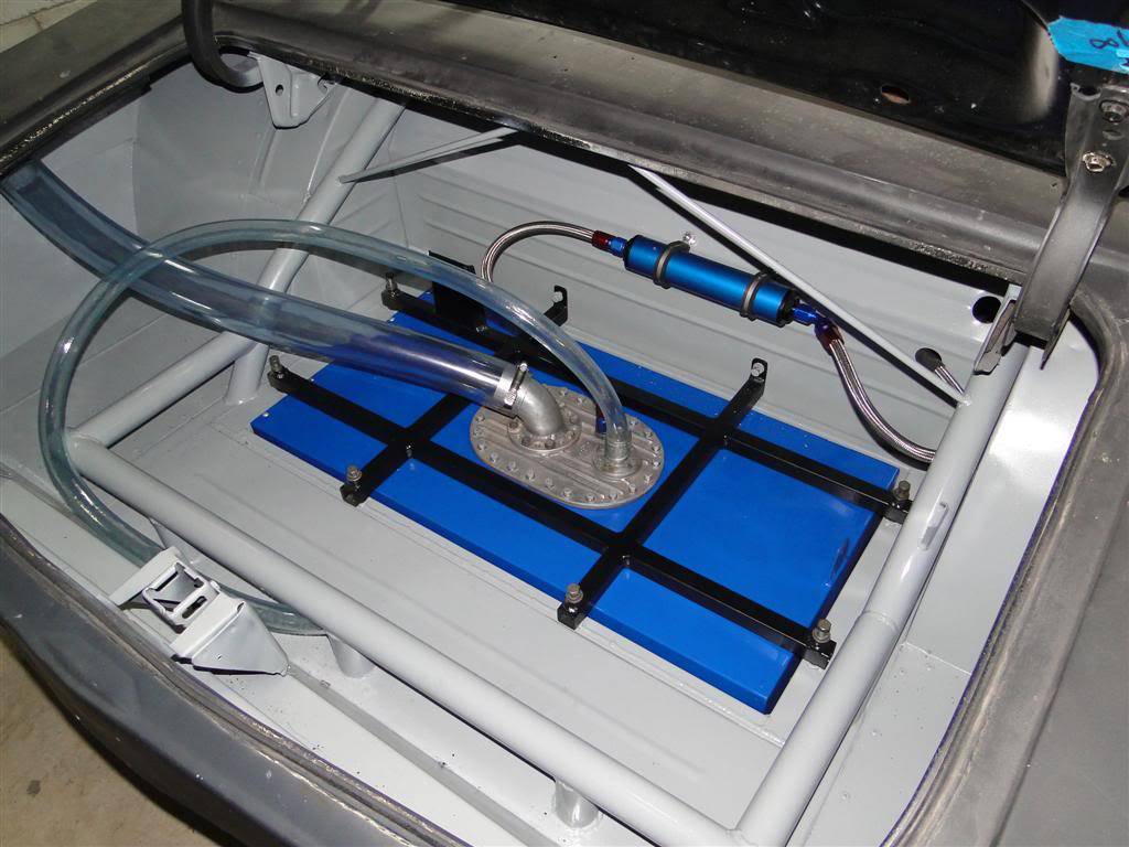

      More trunk with fuel line and filter, still need the check valve for the vent hose, you know, to put the "catch can" in.

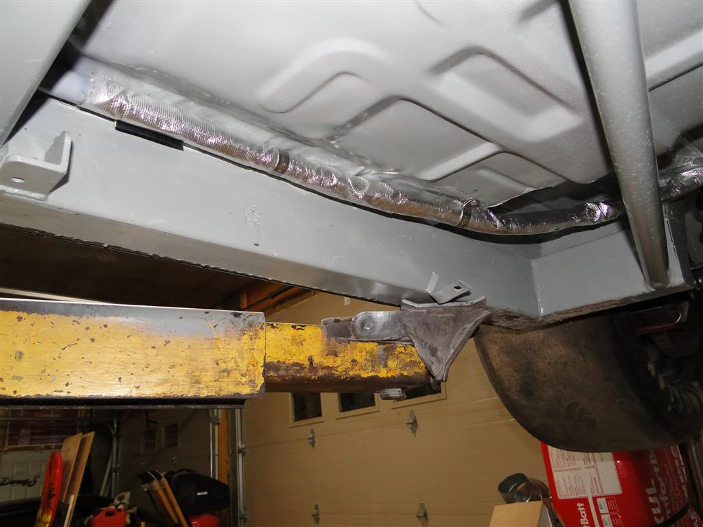

      Decided to run the fuel line under the car in steel elect conduit instead of inside the car as it was originally. It ran right where the pass seat is. It still gives some serious protection in case of off roading into gravel trap or something. The insulated part will be above the side exit "tailpipes" (Nas speak)

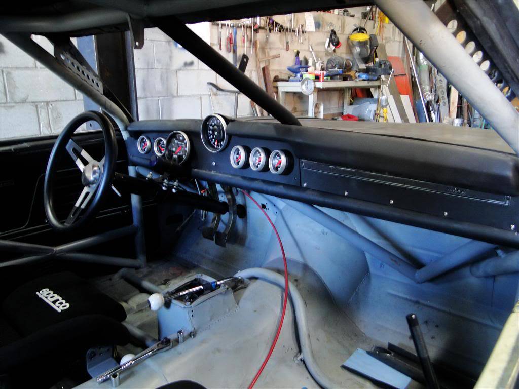

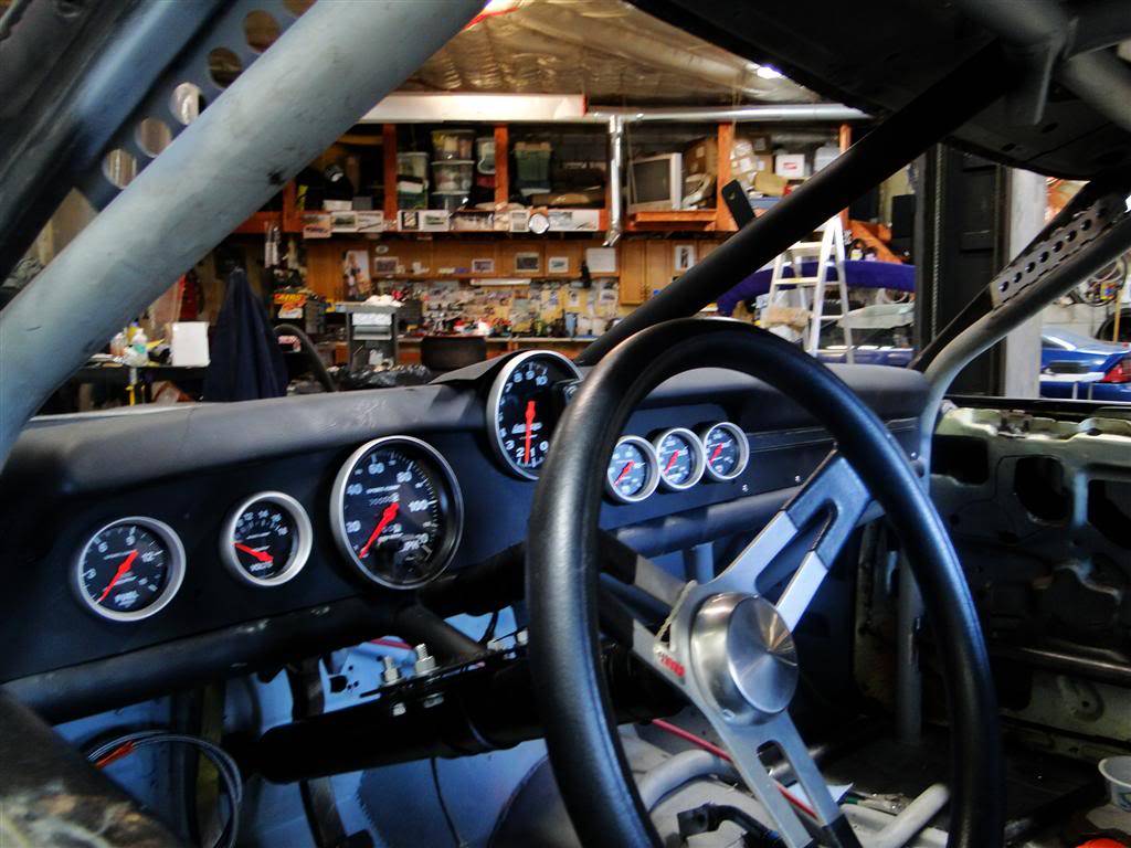

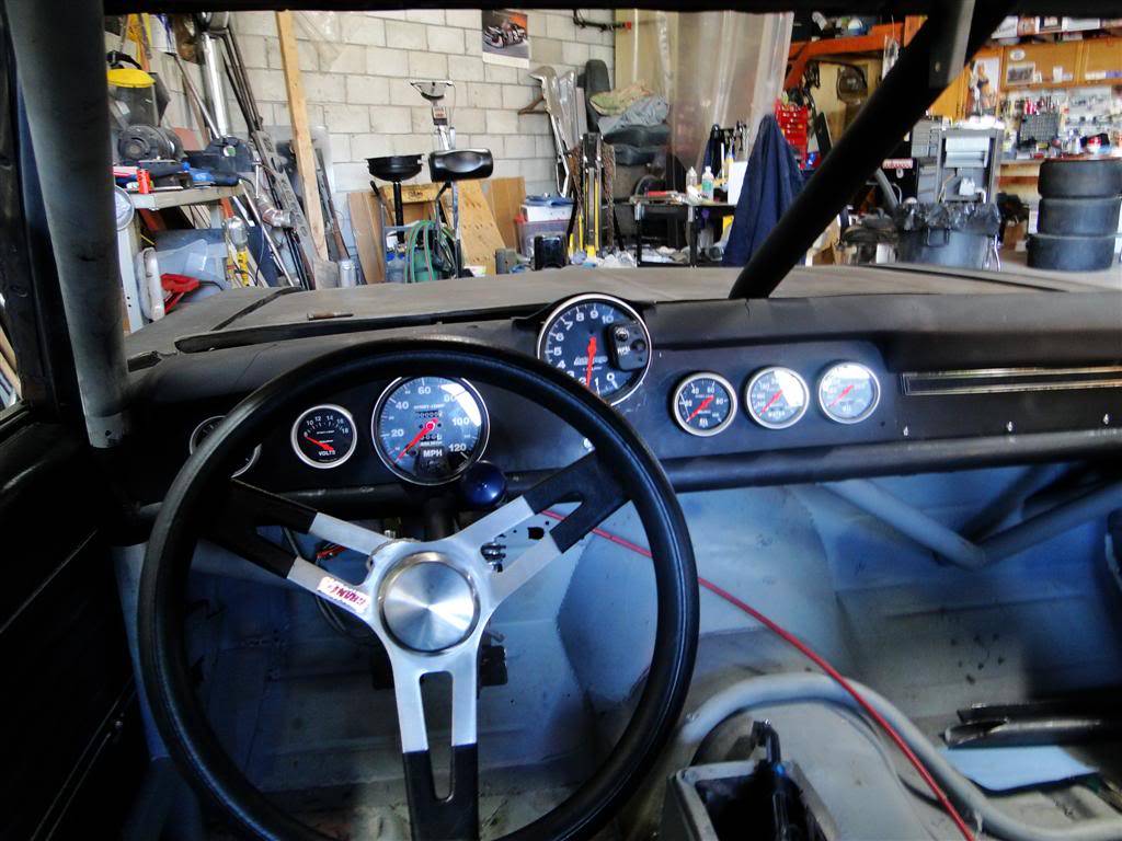

      Dash - Was going to put the tach and speedo together in the "stock" position but had difficulty reading them through the steering wheel just sitting in the shop let alone at 100 mph. So I put it up on the dash pad old school stock car, Much better! love it. Reused the "Malibu" trim piece above where the glove box would be so it looks "stock" lol. I cant reach the dash to flick switches so a trans tunnel mounted switch box will have to be made.
