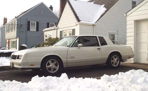

      They will fit, but you will need to buy 2.5" (I think) billet adapters to have them properly offset. A few people have done the mod without major headaches. Here's Tony Kiszka's '85 Monte SS - http://home.earthlink.net/~kiszka/Wheel_updates.htm
      You can also use ZQ8 S10 wheels and enlarge the center hub to fit over the "hat" on the G-body rotor. Here's my daily driver '87 SS with 16x8" 2002 ZQ8s -
      And, here's my old '85 SS with 1998 16x8" ZQ8 wheels. They're basically the same as the '91-'92 Camaro Z28 wheels -
      Steve Ragusa - North Jersey
