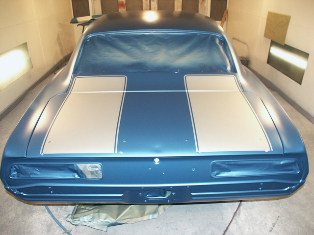

      I used a C5 Corvette third brakelight on mine.
      Close-up before paint...

      I mounted it with the connection down. I had to dimple the deck lid so that it would clear. I bought the light and the pigtail from GM. It doesn't look like a normal weatherpack connector. If you were getting the light out of a wrecked one, you could just cut the harness with it.
      I thought I had a better picture of the dimple, but here's one of the car before the clear went on.

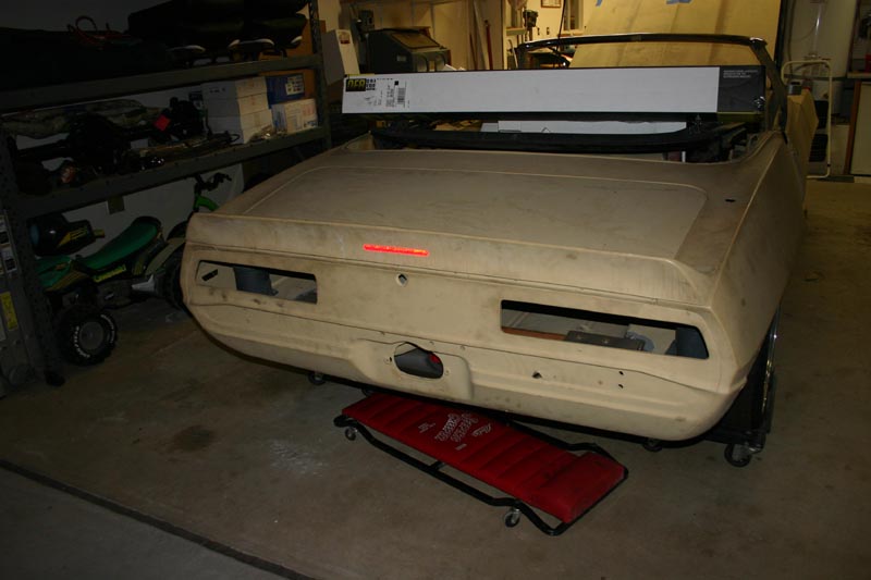

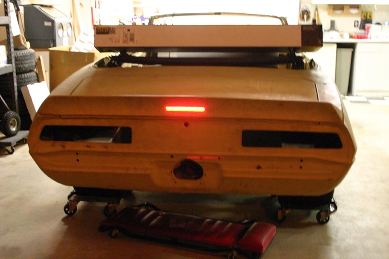

      I also installed a 3rd brake light on my '69. I bought it from Watson's Streetworks.
      I bought the Small Hot Slot 3rd Brake Light (Part #L58SMB). It was $75 and is 7.5" x .5". What I liked about this one is that you sand the lens down so that it is smooth with the body and you clear coat over it.
      Here are a couple of pics.....
      Was pretty easy to mount the lens, but the LED Box was a bit trickier. I haven't sanded down the lens yet. I'm going to leave that to my paint and body guy.

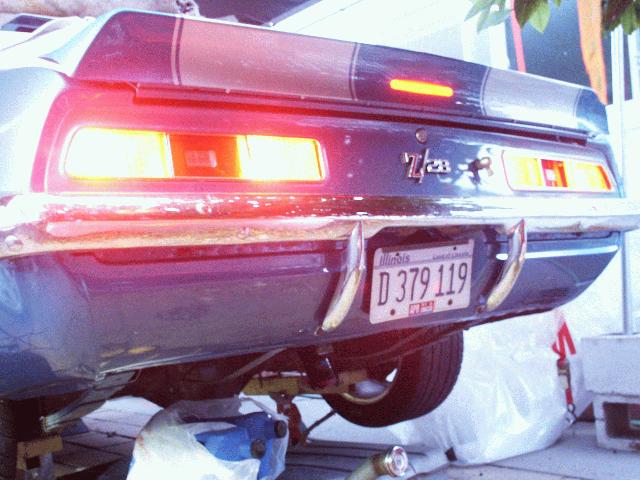

      We will have our rear spoiler for sale soon that has this mod done to it already:
      Might help those of you wanting a bolt on..
