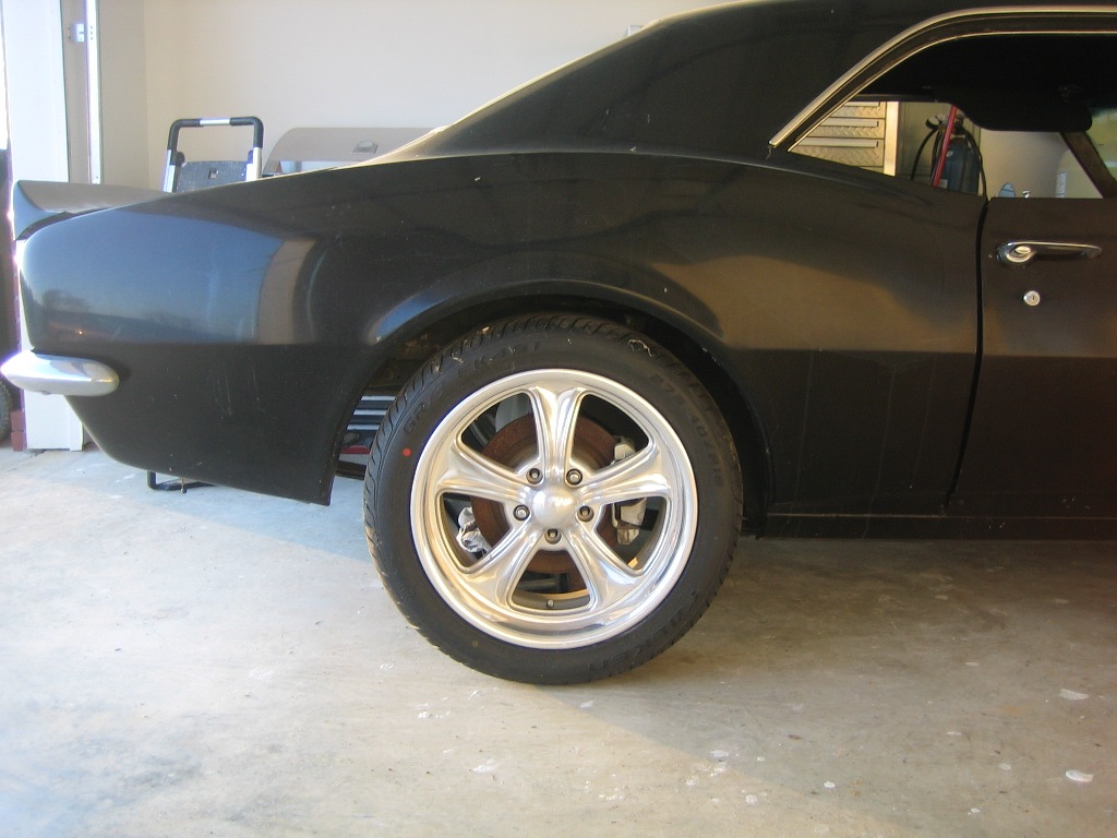

      I am running 275-40-18's on my 67 Camaro project with DSE 3" drop leafs. From the ground to the top of the wheel well is 27.5". The car currently does not have the interior or the gas tank in it so it should come down a bit when those things are back on. I know you were looking for something with 17's on it but I hope this helps anyway.
      Name:  Rear wheel pictures 001.jpg
