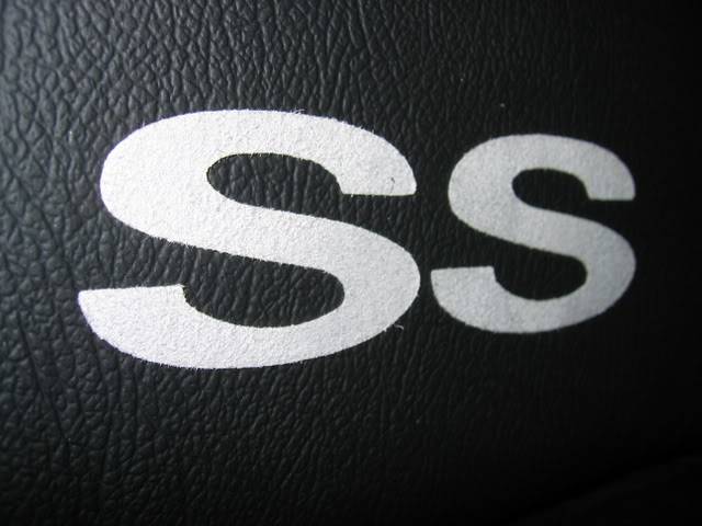

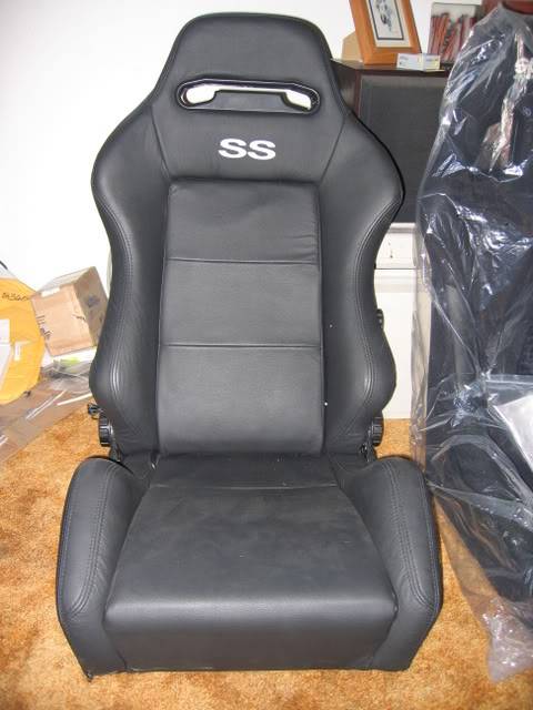

      And then Ralph works a deal on shipping!!! I'm committed and around Christmastime, these Arizen's are mine!! I wait watching for the FedEx truck filled with goodies and finally am rewarded with SEATS! I'm ecstatic, grab something tool and open the box, pull out the coolest seat I've ever seen, set it up, and plop my butt in it. Great fit (have no idea how you'll ride in the car, Dave), great seats, cool logo, I'm giddy with excitement, and they'll be a welcome addition for my '68 SS for reasons you'll soon find out. They even came with bun warmers ...
      Arizen seats and cool logo (in SUEDE, no less) ...

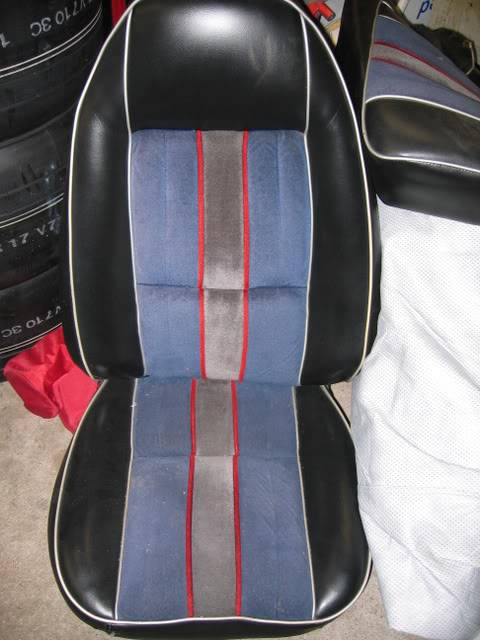

      Now this SS sort of had a rough life before I came to the rescue. It last had a smog (CA laws and yes, it passed) back in 1996 and from there, the owner sort of strayed off the beaten path. Somewhere along the line, someone thought that a normal, uncomplicated interior should be replaced with something like this ...
      And these seats were the best part ... EVERYTHING that was part of the interior was covered in this velour crap. We're talking the dash, kickpanels, seats, back side panels, rear seat, and the package tray. And there was no middle ground. It was like a cancer everywhere. After dissection, whoever created this visual interior of Hell just glued their creations over the existing panels. My camera broke when I tried to get a pic of the entire mess and guess it was as horrified as I was. Great negotiating factor, however, as I knew this interior was going to find a new home ... somewhere in WATTS.

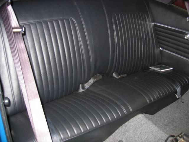

      I bought an entire interior before I bought Ralph's seats so had a head start on the resto/replacement of the "pimp my ride" project. When I got the old front seats out, I decided to continue onwards and complete my resto. I removed the entire rear section of the interior, purchased new rear panels (package tray as well), and some rear seat coverings. Now it's cold here in CA (I know you think we're all wusses as for us, "cold" means anything below 50 degrees F) and one evening I managed to clip off about 300 hogrings from the seat cushion, replace the cover, and then squish new hogrings back on to complete that part. The seat back cover wasn't as cooperative and after wrestling around the garage floor (yes, in the winter cold while I sat on the seat watching Dave try his best to wrap the edges close to the frame ...), Dave and I cried uncle and had the local "upholstery guy" get this part done. Oh and did I mention the stuffing smelled like mouse piss??? That is the nastiest, stinkiest, almost permanent stuff known to man. While I'm cheap with spending $$$ for labor, mouse effluent (after a painful, lingering death, those critters have a new home in a landfill) quickly made spending coin for the rear cushion install an easy one. Talk about "Worst Jobs." Where's that guy when you need him?
      And while I was into the rear panels, both rear window lower rollers had bit the dust (rolled down great, just not up). Waited for more parts and replaced them. Took the entire rear window assembly out, separated the parts, cleaned and bead blasted everything, replaced the rollers, and lubed the hell out of the channels,guides, and rollers, regulator teeth, and everything else I could think of. Reassembled it all and then cleaned the glass to get all the white grease off ... then cleaned my clothes to do the same. Argued with reveal mouldings and got those installed. Still have to have the front mouldings on the rear windows put on.
      Aligning the rear windows to the moulding insets is also a pain ...
      Here's the interior ...

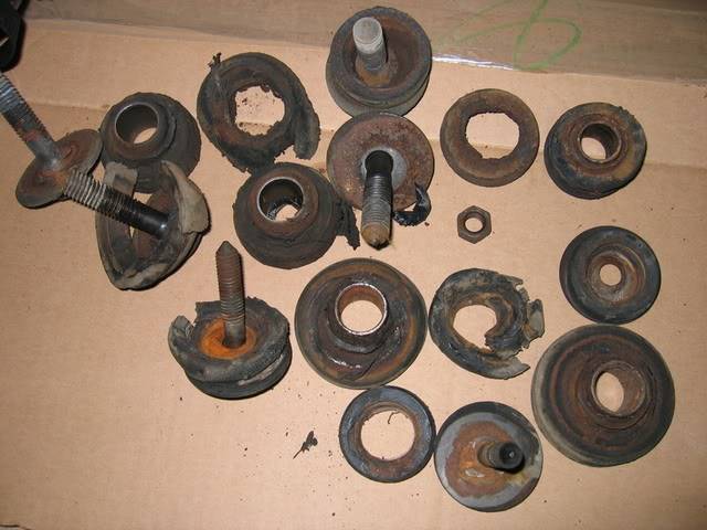

      Now prior to removing the speakers, I disconnected the 12v battery and couldn't help but notice some whitish residue under the battery tray. This didn't look good and closer inspection found the battery seeping acid/water causing corrosion. Costco had a suitable replacement but when I removed the tray, I was facing the gnarliest, tornest (guess that's a word), most disgusting image ever seen. I checked the rest of the family of gnarly bits and their condition sang harmony with the one seen under the battery tray. Oh, MAN ... all I wanted to do was replace the front seats. Thanks, Ralph ... and wait until I see you.
      The disgusting images ...

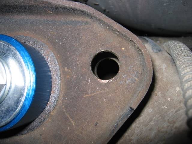

      Global West had already supplied replacements so after another three or so days preparing (WD-40 in the soak cycle), wrenching, lifting, cussing (anatomical impossibilities and just ask Dave), more wrenching, prying, more cussing (good combinations this time), buying new bolts (two from GW were too long), bending the front bumper (don't ask as I'm not discussing it), and realigning the body on the frame (didn't know about this part and it's a real PITA to do), subframe body bushings are in.
      Alignment hole got a workout ...
