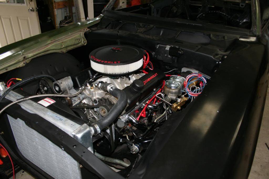

      Getting really close to having the car started now...
      Most of the engine wiring is done, brake lines, tranny lines, fuel lines are installed. The exhaust, driveshaft and gas tank is in and a ton of other small items. It is amazing that 4 months have passed, and it seems like not a lot has changed, but the guts of the car are almost completely in place and it should fire up in February.

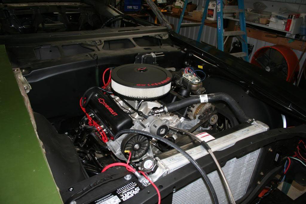

      looking sweet..where did the valve covers and air cleaner come from ?..ive been looking into black and those look killer on there..

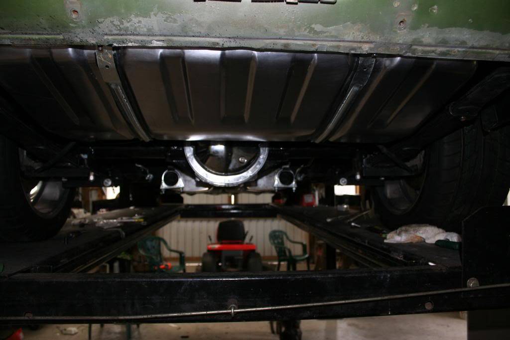

      what did you coat the underneath of the car with, nice work
      Houston, Tx
      1,004
      I used 3m Body Schutz undercoating. It sprays really nicely, adheres well and has an awesome texture. I probably used a total of 4 bottles to do the car.
      It screws directly into an applicator gun that can be reused. It cleans up really nice and is an all around excellent product in my opinion. I think that if you get the white version it is even tintable with paint if you are interested in body matching.
      They actually came with my engine, but I believe that they are made by proform.
      http://store.summitracing.com/partde...8&autoview=sku
      They look really awesome - the black is eggshell and has a very small amount of texture. I really like them.

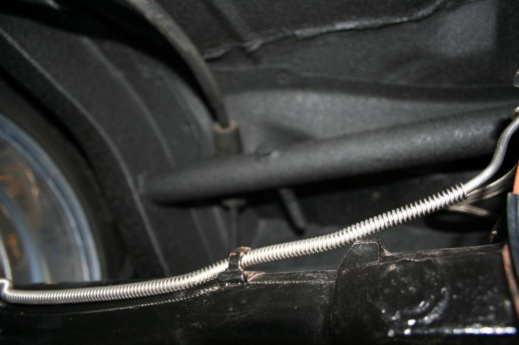

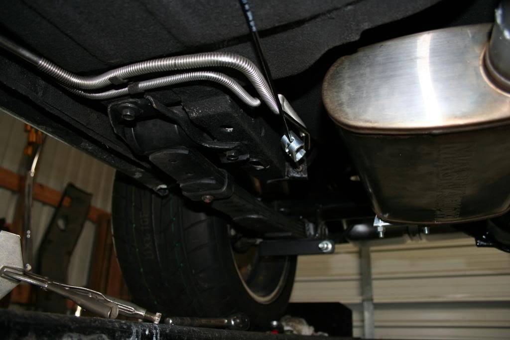

      Looks Good have you started the engine yet? Underneth looks nice Are those fuel line standard size or larger? Comming along nice
      The engine should be roaring to life in the next couple of weeks... I am just getting the details done and will then be starting it. The fuel in is upsized from the original - 3/8 instead of 5/16 inlet and regular sized return - both stainless.
