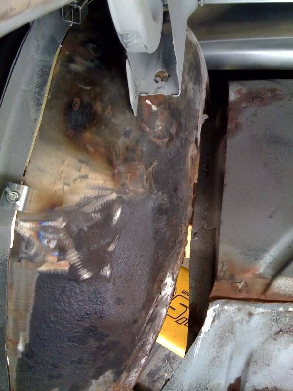

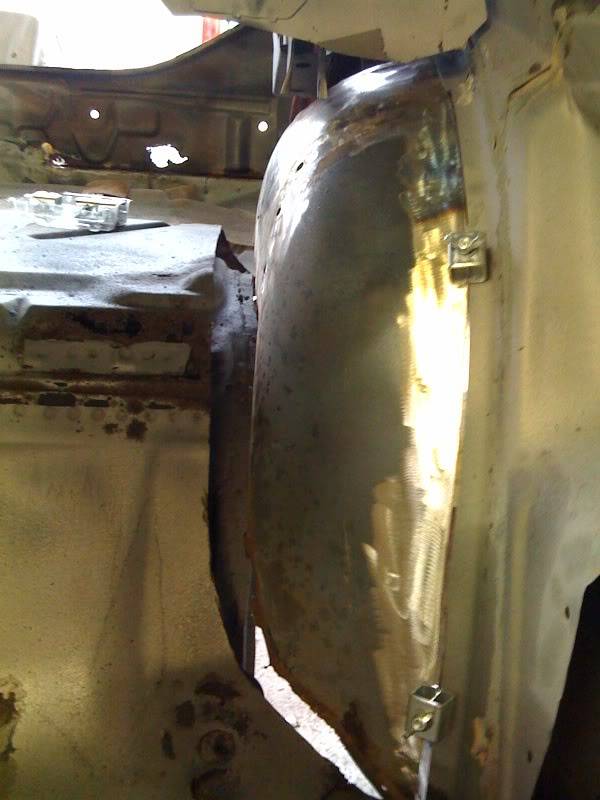

      however, this was before my friend Gregg let me know that moving the tub isn't really necessary. for the most part, you can just cut where the tub meets the trunk floor, and then hammer it into place. the frame notch is only an inch or so, and doesn't require a lot of extra space in the tub.
      since the body is still on the frame from being sent to the media blaster, I centered the body on the frame, and he's right. the tub itself only needs to move inward maybe half an inch to an inch. I'll try and get a picture of what I'm talking about.
      having said that, there is a lot of rust where the tub meets the trunk floor, and it will need repair on both sides regardless, so I'm not sure if I could get away with it or not.

      here are the minitub pics. this is on the DS, I cut out the tub and cut into the body a little. the frame is already notched, so you can see the body notch wasn't really necessary.
      this pic is from the trunk:
      and from inside:
      the body is centered on the frame.

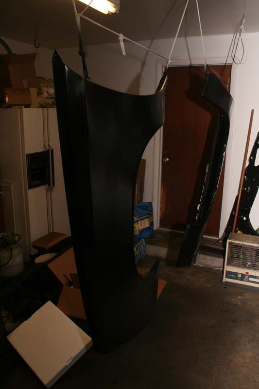

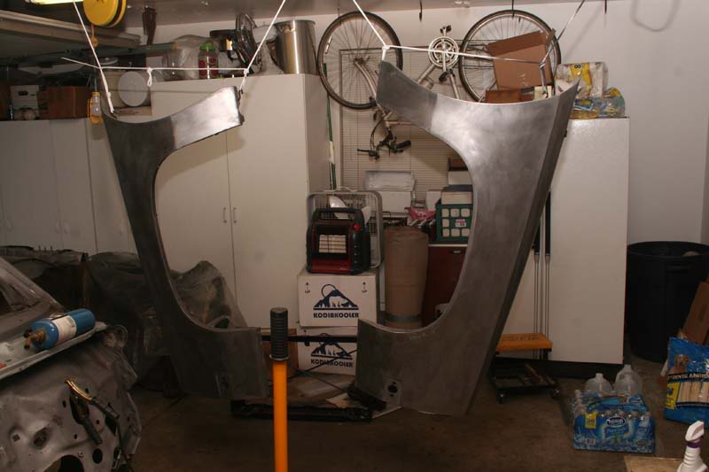

      and a small update. a couple weeks ago I got some epoxy primer on the core support, sway bars, controls arms...
      this last weekend I finished stripping the outer fenders and one door, and got some epoxy on them:
      hmm... always love suprises hiding under body filler:
      mixing epoxy:
      door is nice and wavy, eh?

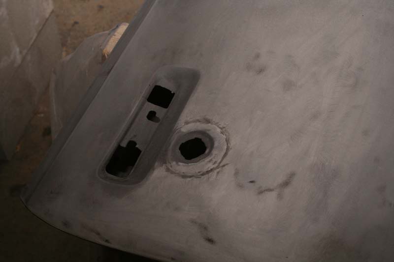

      last night I finished stripping the driver door and quarters. and... I think my driver door is toast. it looks like someone used a grinder to block it down at some point, and there are some nice rust holes in the skin. not to mention dozens of little dings and waves.
      but i'm officially done removing things. no more seam sealer, no more paint. my wife is out of town, so I anticipate lots of work this weekend patching holes. i'd also like to lay down some epoxy on the body shell to not worry about surface rust.
