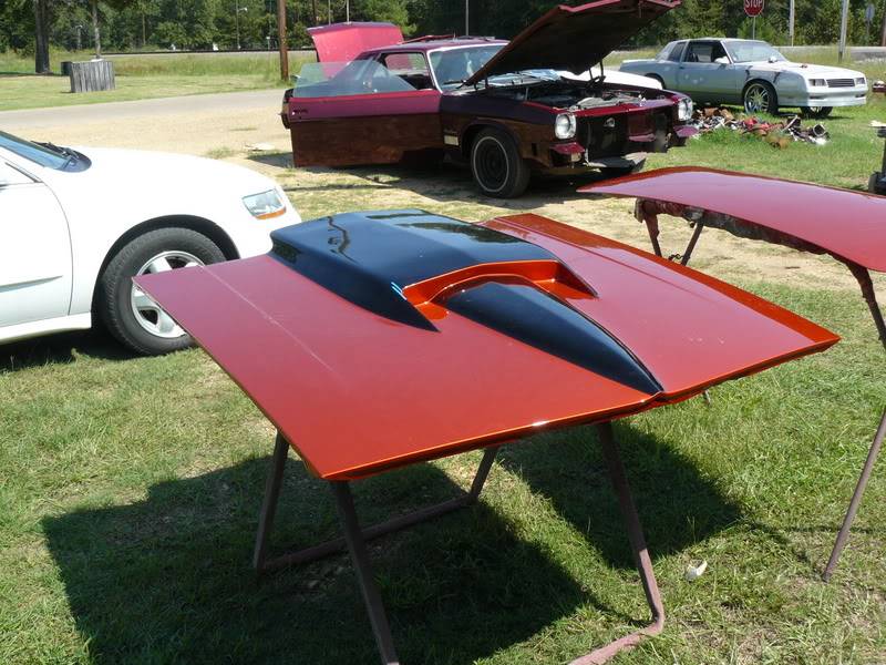

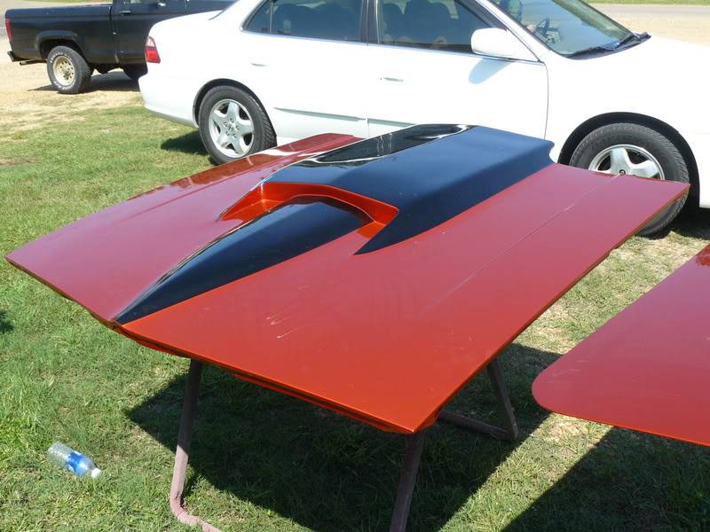

      I had VFN fiberglass sell me the center section of a stinger hood. It was centered on the hood and the hood area it was going to mount to ground to metal. The stinger section was ruff sanded, then some holes drilled to mount it. I then took 3M's Panel Bond and put it on the hood and the stinger section. After lining it up with the holes it was screwed down.
      Panel bond was used around the edge as a fillit. After it dried the screws were removed and the holes filled with panel bond, aluminum tape was used on the bottom of the hood to keep the stuff from oozing out the screw holes. It was let to dry. Then sanded and the edges blended.
      My painted screwed up the stripe. It was not supposed to go down the sides of the cowl, nor was it supposed to be on the stinger part of the hood. It's supposed to be just on the center section of the cowl and be like a short single first gen Z/28 stripe. I hope to have it back soon and done right......I hope!!
      If I can do it you can do it. It seems to be very strong. Not saying you have to use a stinger style but it might look cool on a Monte!!
