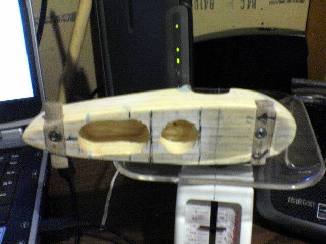

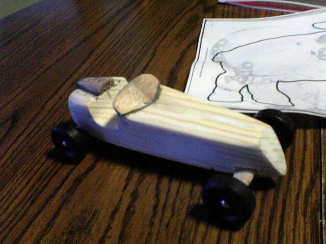

      Last years before paint.
      This year it will just look like a hockey stick. I want to make the front where the car sits against the starting pin as high as possible-this way the car starts rolling sooner as the pin moves.form follows function.Personally I think its all in the alignment.
      Good idea, now I'm thinking about putting a small "spoiler" on the front up high out in front so it rolls first. Thin out those wheels and cone the hubs to come off the line faster than heavier wheels
      Alignment is big, but so are friction and weight.
      You want the majority of the weight in the rear of the car, but ballanced 3/4" to 1" in front of the rear wheels to keep it from bouncing on the front end. Keep the weight of the car on the hill as long as posible to push it down the track.
