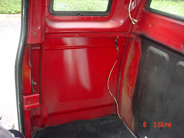

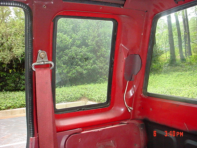

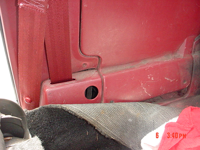

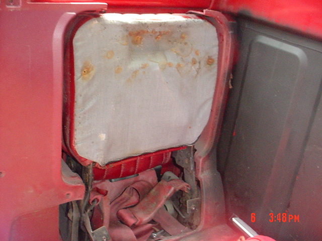

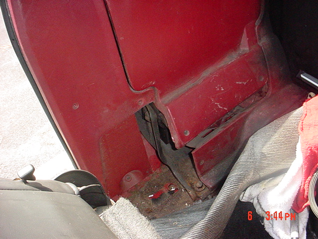

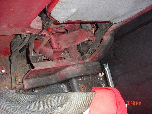

      Okay. I've got an '85 S10 with extended cab. For those that have never been in one, it's not very large. There are two TINY jumpseats in the back that fold out of the corners of the back of the cab. They face each other vs. facing the front of the truck.
      To reduce weight, I removed them.
      Sorry for the crappy pics. It was a few years ago.
      Okay, well now that you essentially know what it looks like, I need help on how to repair the plastic. Well, not repair, exactly. I want to MOLD the seat surrounds to the back of the old seats. The seats are gone. I just want the plastic back in there. And it doesn't need to look GREAT. Because I'll be covering it up with some sort of suede/leather/vinyl in the future. But it needs to be relatively smooth so when I cover the seams I won't be able to see them.
