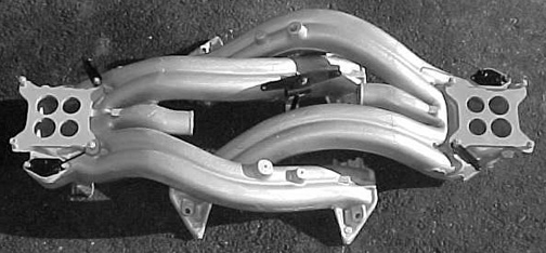

      The engine electronics has me stumped also, not sure If I want to do the XV Motorsports carb conversion and cam or do something else, I wuld love to hang a single or twin turbo in the engine compartment but that in itself might take this somewhat budget build over the top .

      I say stay F.I. Do some crazy intake on it with 6 pack TB's. Or maybe a crazy Mopar cross rams.
