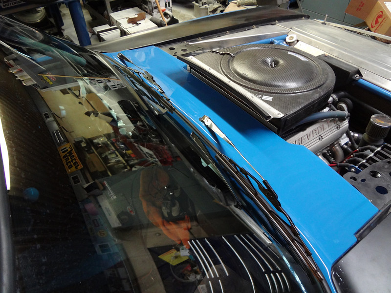

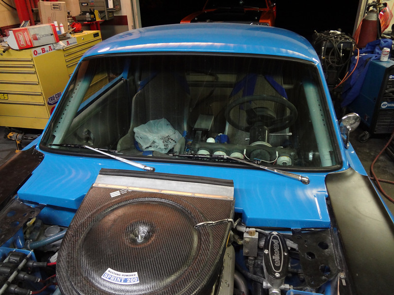

      While I was fixing the cowl and windsheild that the hood screwed up, I desided to put some wipers on this car. It seems every event I go to a monsoon seems to follow, hell I had to drive in Michigan at 80 mph, with my fist holding the winsheild from falling in my lap, in driving rain, trying not to rearend Steevo.
      The problem was that the inner cowl section that the wipers attach to was removed off of this car to get the engine back far enough. I ended up using a 2005 Dodge Neon wiper motor and linkage, welded to my roll cage, getting the ratios correct was a pain but it works pretty good.
      When I painted the cowl I went body color instead of flat black, because I think I'm going to paint the whole car blue, and put the white GT350 stripes over the top for something different(not sure if I will like it or not, so I think I'll do the stripes in vinyl).

      Very nice! I've looked at those neon assemblies several times and thought they would work nicely. What are you using to control it? a wiper switch or just an on off switch?

      The only thing I couldn't get right was the park position, couldn't clock the motor to stop in the correct position because of the physical shape. It is two speed, but it is just high , low, or off.
