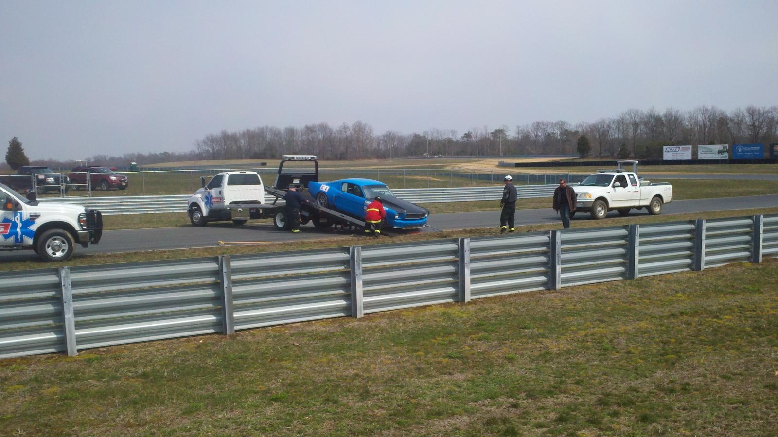

      Some of the pictures I took of Ron's mustang. I was talking about your car to my dad all week I even showed him the ceceil runs because we go down there ocasionally and before I could make it up the bridge to watch you crashed. Your car and fabrications skills are inspiring. It was nice seeing the car. Best of luck with the engine.

      Thanks Yancy, The sheet metal shouldn't be bad. I was afraid that one day this would happen, so I made the tail panel, and inner wheel well a bolt on, will have to reshape a new quarter panel, but other then that its all nut and bolt. As soon as I get back from North Carolina I'll get to the sheet metal. I'm still pretty up in the air on the engine though. Why do we do this to ourselves?lol

      Thanks Vinn, its always good seeing you and Tina. The new Camaro is awesome. I'm pretty sure the piston broke Friday night when it belched out all that oil.The car didn't feel right Saturday, I should of stopped beating on it, but you know, I couldn't.

      So, the first iteration had an LS1 and you windowed that block. You made the next logical step and went to an LS7 and now you have windowed that block. Where do you go from here? C5R block or a C6R block? I hate seeing this, but I am glad to hear that you are ok. As everybody else has stated, you have to be saluted for driving your car particularly after all of the wrench time that you have put into it.

      Spent the better part of yesterday looking for you an new block and crank. I did not come up with any deals, but i will keep an eye out. Good thing when you built the car you made it like a tank. I would have thought there would have been more damage to the rear. Deck lid looks good except where the gas monkey dropped the nozzel on it. LOL

      I'm starting to wonder if all of us in the PT world that put our cars on the track (even if it's just occasionally) need to start thinking harder about oiling systems. With the destruction of your LS7, Bill's Hemi, Chris' BBC and a few others all meeting their maker at road course events, I wonder if we're all overlooking something we shouldn't.

      The death of my engine, and Bills engine were not oil related, i don't know about Chris. Bills car just ate a valve, part failure, not oil related. Mine broke a piston, shot the rod through the block, also not oil related,and my car already had dry sump oiling. The piston I'm almost positive broke Friday night on the cruise, puking oil out the breather like crazy. The car was slightly down on power Saturday, I should have recognized the symptoms, but didn't until it was too late. Lesson learned, expensive lesson. Ron

      Gotcha Ron. I had forgotten that you retained the dry sump system. All the more reason to stick with an LS?
      Very sorry to hear about your expensive misfortune on that Ron. Did anyone else have an engine failure at RTTS?
      I know this is an area of my car that has been largely overlooked so now I'm thinking about what needs to be done to make it live over the longrun.
