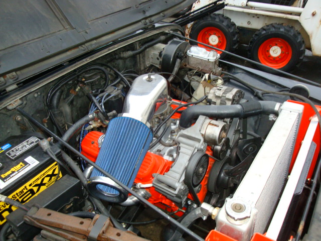

      Finally finishing up this Jeep conversion for my kid. Didn't want too much power so I put an EFI 4.3, Turbo 400, Dana 300, and 2 Dana 44 rears. Just bent up the front bumper, and am finishing up the cage. After this weekend I will hit the Mustang hot and heavy. Ron

      Nice work on the Jeep. Is that half cab something that you made? Or are they available for purchase? I don't have jeep, but just curious. It looks good and reminds me of the old Broncos.

      I found it on Craigslist for a couple hundred bucks, its off of an 80's Jeep Scrambler. Ron

      I know the kid will love the Jeep....cool ride for a youngster

      Super cool Jeep Ron ---
      Bet your son had lots of "Tonka Trucks" when he was younger!!

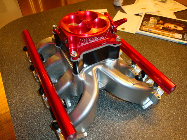

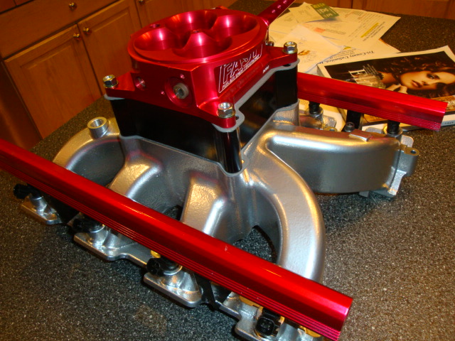

      Started assembling some of the subassemblies while I'm waiting for some other parts to come in. Got the intake powder coated and put together tonight.
      Could not find a 24x=58x control converter anyware, so I'm going to have to change the reluctor ring on the crank. Waiting on the alignment tool to come in so we can assemble the shortblock.
      Ron Schwarz

      damn that Jeep is cool..can you adopt me??..lol..thats a mean looking intake damn !!

      Ooooh!
      That is really cool. Will it clear the hood?

      I see your trying to spend the original budget on induction lol. Looks freakin awsome!
      That looks sweet !
