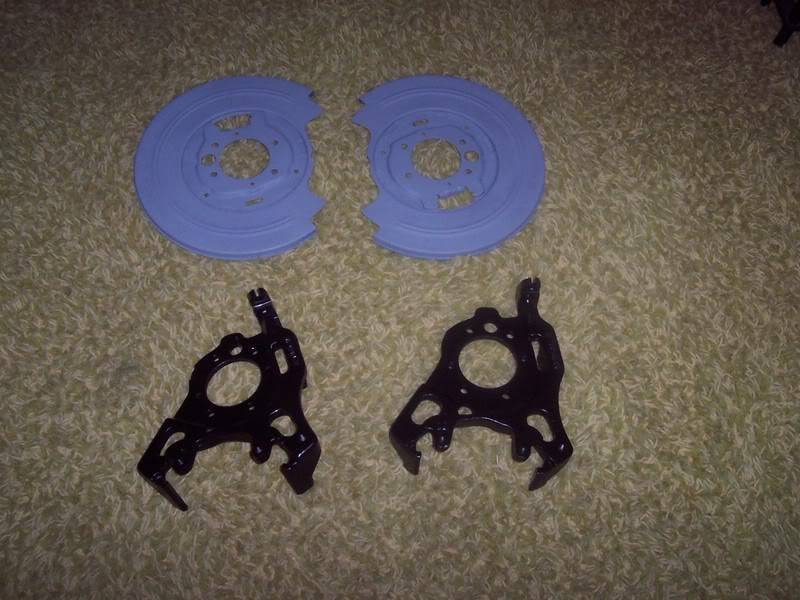

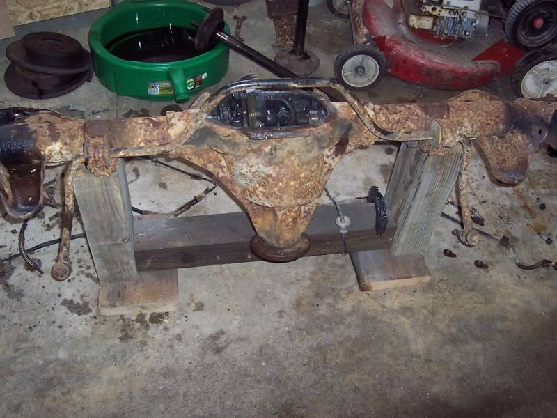

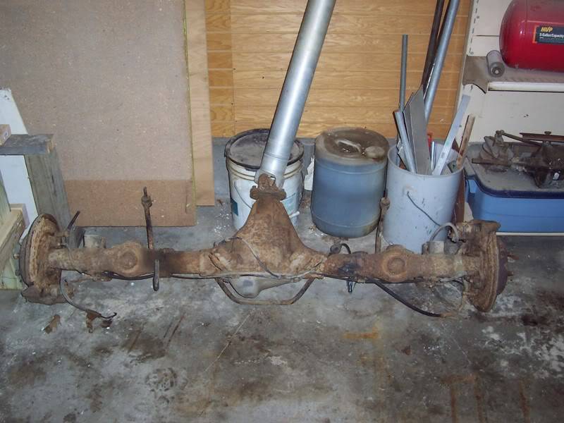

      Well I didn't get to the body work I wanted to do this winter but I did pick up a 96 Crown Vic Rearend with Disc Brakes so I can convert them over to my 9". I will also be using the Sway bar and brackets.
      Not bad for $50 I have the brackets off and I'm sand plasting them at work.

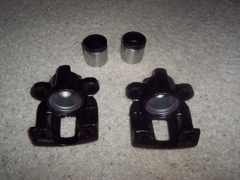

      Got a little Done.

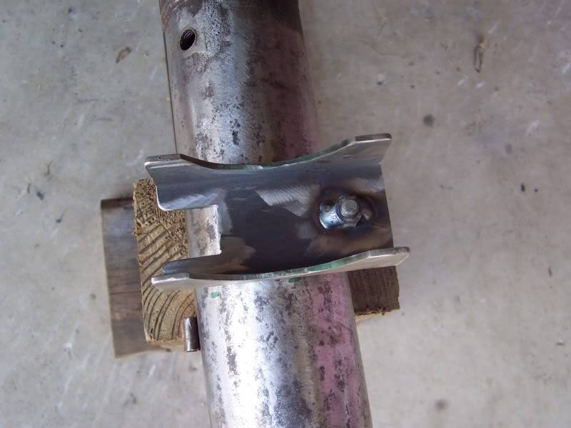

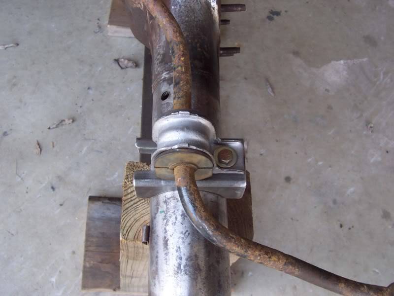

      I got a little time in the shop this weekend and made up some new perch brackets to mount the sway bar. I used the original u-Brackets and bushings from the Crown Vic should work out nice I think.

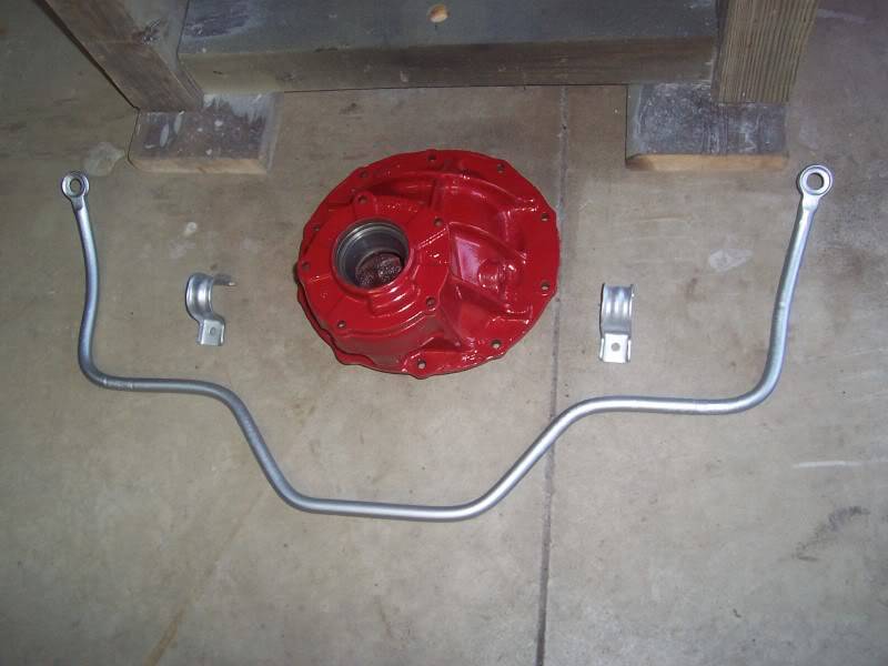

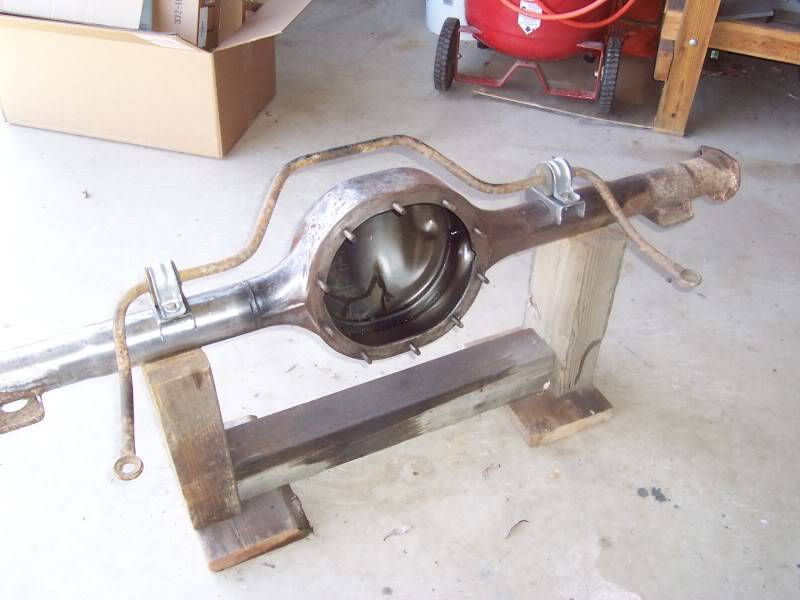

      I have been working on the 9" housing getting it ready for paint and got the first coat on tonight. I had it sand blasted and used a little filler where the pitting was bad and I also used a textured paint to make it look uniform. The third member housing got painted to I think the red is not dark enough but I like the way it looks so it stays. The sway bar and brackets also got hit with silver.
      In this pic you can almost see the 1/4" pad I welded on the bottom this will be drilled and taped for a drain plug.

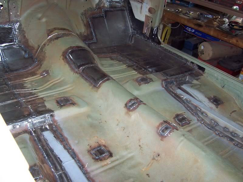

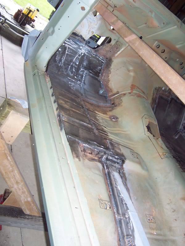

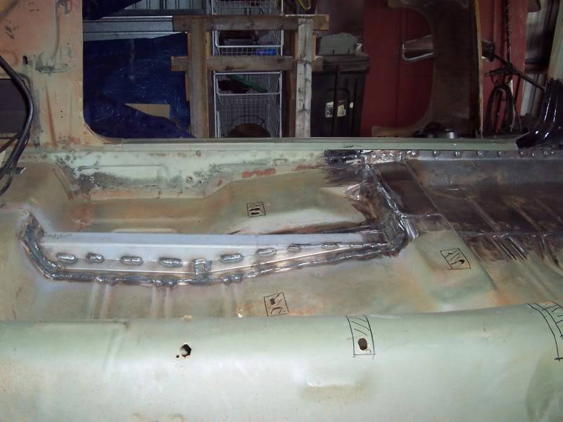

      Finally made some real progress on the Torino I got The front floors back in and started Patching some other areas. This feels like a big step for me since the floors where the first thing I cut out over 3 years ago. I also made filler strips to go along the sub frame connectors since I had over a 1/4" gap in some areas. I opened the gap to a even 1" along both sides so it would look uniform from the underside I still need to do the right side. I also need to patch some holes where the PO had mounted Bucket seats and a consol from a T-Bird The trans tunnel is also a mess where they mounted the shifter.

      Finished up the floors
      Took some time but I can now move on to the next project area. I fabed the pans my self I know you can buy them but the toe boards didn't go up as far as I needed them to plus I was able to hide the main weld seam under the subframe rail. Also there is less the $50 in materials this way and we won't count the time
      The hack job that the PO did on the trans hump.
