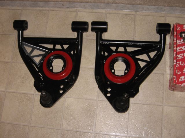

      Hey, no fair, that's MY front suspension. haha
      except for the lower arms. I'm using stock w/ del-a-lums.
      Do you mean spohn lower arms? I didn't think SPC made lower arms.

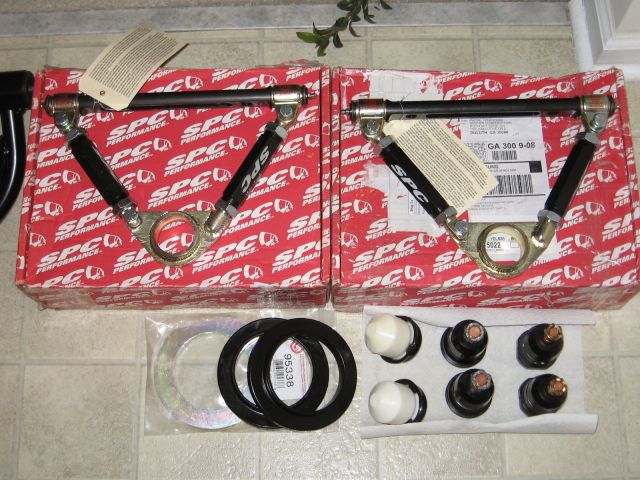

      Updated...
      ATS AFX Spindles - PURCHASED
      - G-Body Tall Spindles
      ATS AFX Billet Steering Arms - PURCHASED
      SPC Adjustable Upper Control Arms - PURCHASED & IN HAND
      - Upgraded to Hex Sleeves
      - Greaseable Steel Bushings
      - Screw-In NASCAR Bushings
      Precision Series Upper Ball Joints - PURCHASED & IN HAND
      SPC Lower Control Arms - PURCHASED & IN HAND
      - Greaseable Delrin Bushings
      - 1/2" Shims for Height Adjustment
      - GM Jounce Bumpers
      Precision Series Lower Ball Joints - PURCHASED & IN HAND
      Poly Upper Spring Isolators - PURCHASED & IN HAND
      C5 Vette Calipers - PURCHASED & IN HAND
      Drilled & Slotted Rotors - PURCHASED & IN HAND
      Hotchkis G-Body 1" Springs - PURCHASED & IN HAND
      Braided Brake Lines - STILL NEED

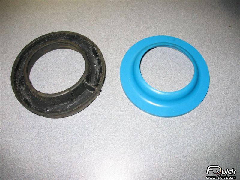

      black one is 15989709, regular rubber
      blue one is 15737908, either hard rubber or poly
      black goes on bottom, blue goes on top

      Quote Originally Posted by jerome
      THANKS!
      But I just bought a poly upper bushing from SC&C along with the LCA's which Mark said comes with an isolator already.
