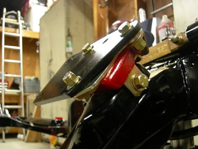

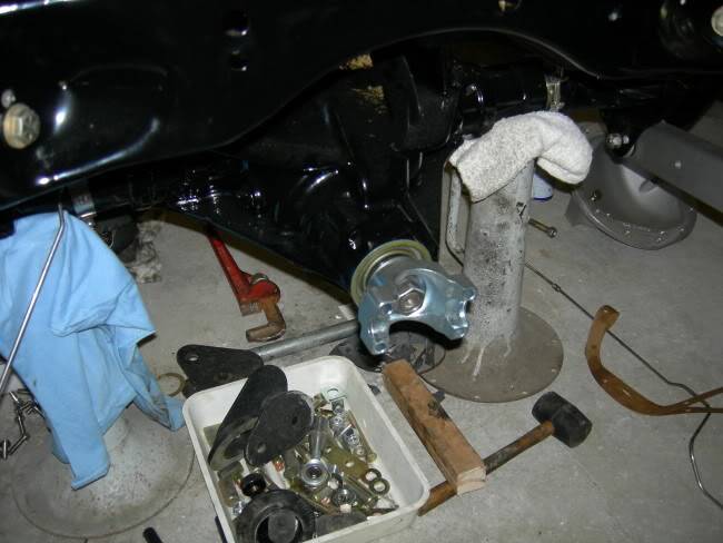

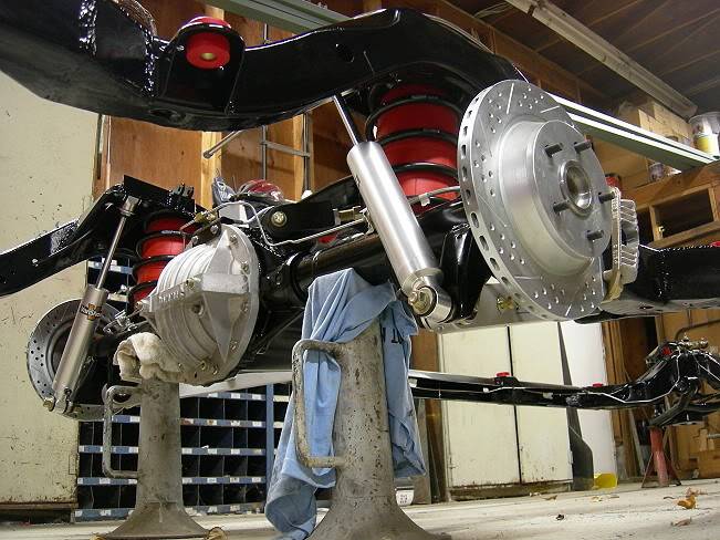

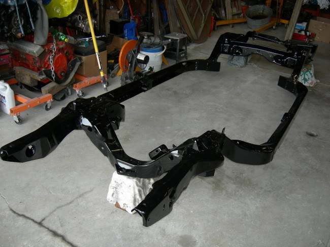

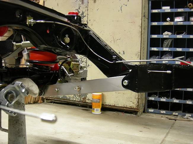

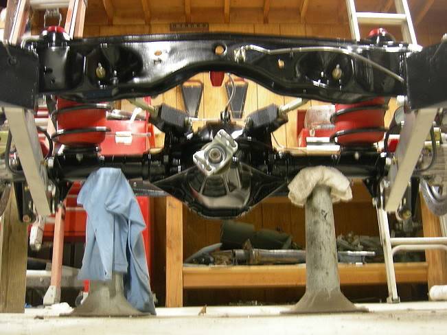

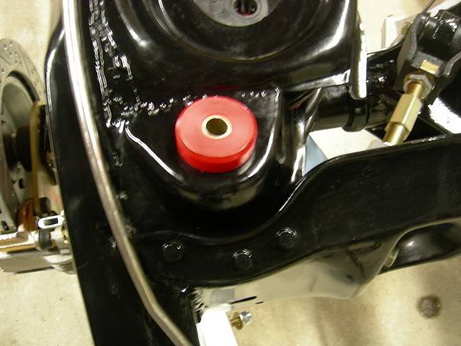

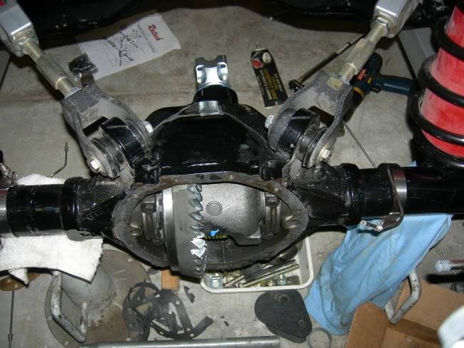

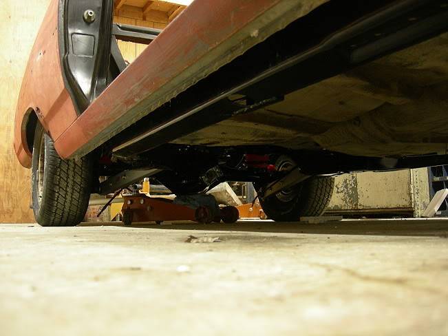

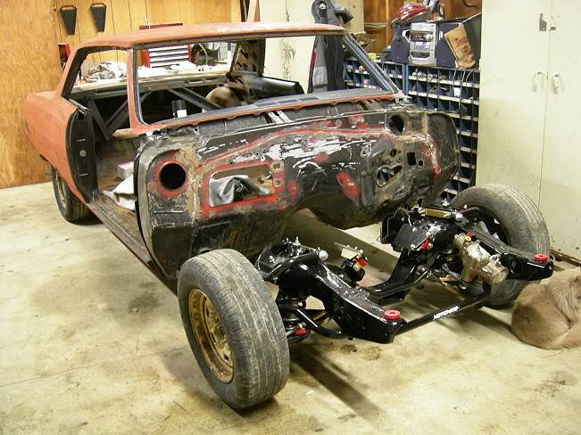

      Ok So i have started an Offical Thread dedicated to my chevelle. I didn't like my last thread so I am starting over. With some same pics and new pics that you have never seen before. Very good stuff here. Stay tuned as I progress on my project. Turning her in to a Mean Pro-Touring G-machine.
      Ok Now for some history. This car was bought in 1964 by my father. For reason the car sat at the coast with 40,000 miles on the clock. About 10 years ago it was given to me with many ideas in mind I spent most of my time figuring out what I wanted to do. Then I did it. The car was origionaly Tuxedo black with an light blue interior. munci 4 speed 3.08 posi 12 bolt and a 300 horse 327 4 barrel.
      The modifications

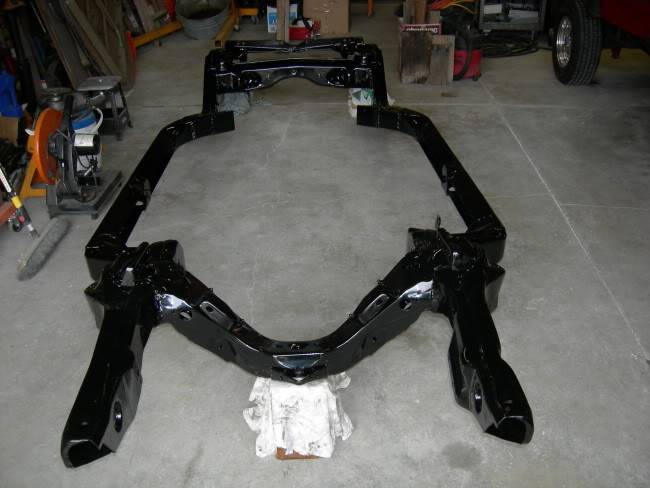

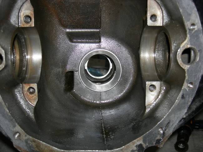

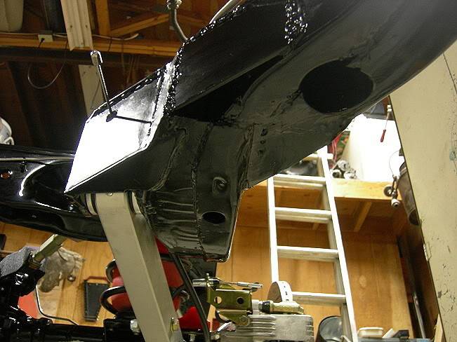

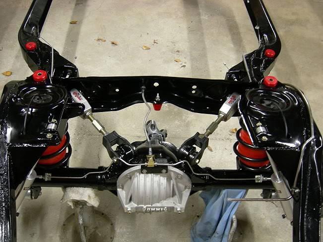

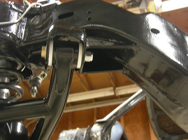

      Frame was boxed and strengthend
      Mini Tubbed 2" inboard per side
      Frame was then powdercoated

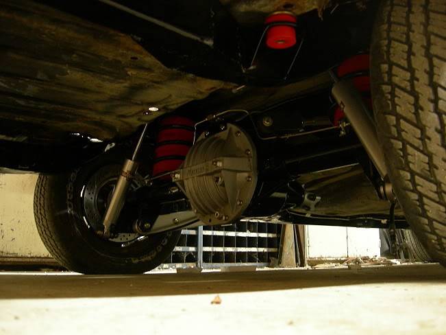

      Rear end was shortened 2" per side
      Then Powdercoated

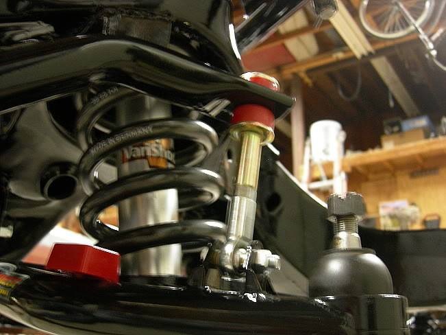

      The parts List

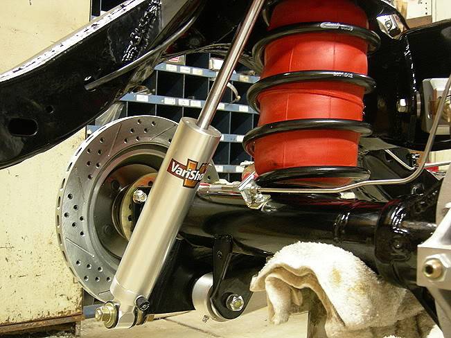

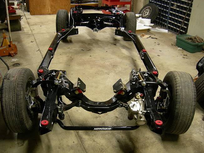

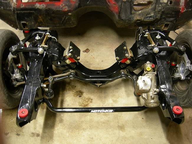

      Global West Upper A-arms (B-body Ball Joint)
      Global West Lower A-arms (B-body Ball Joint)
      Eibach Springs
      Varishocks
      Hotckis 1 3/8 hollow Front sway bar
      AGR 13.1 Powersteering box
      All new steering
      Global West tie rod sleeves

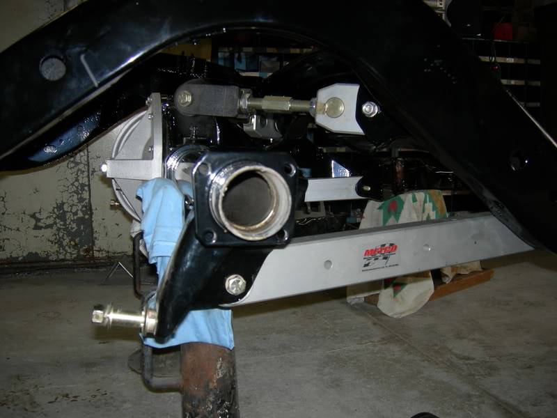

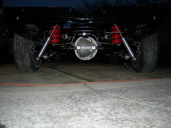

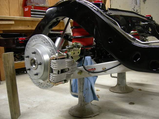

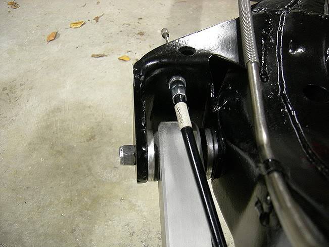

      Metco Aluminum Lower Trailing arms
      Metco Aluminum Adjutable Upper Trailing arms

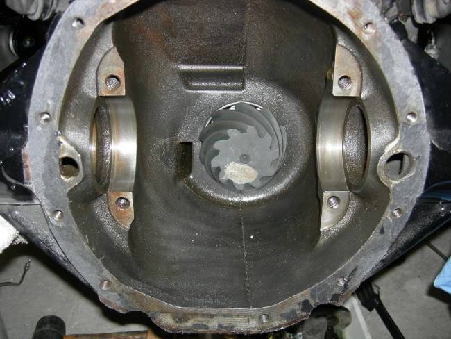

      Moser Custom Alloy 30 spline axles
      Moser 1350 yoke
      Eaton 3 series Limited SLip
      Richmond 4.10's 3 series
      Ratech Insalation kit

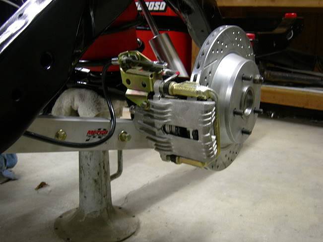

      Rear Baer 12" Brakes
      Stainless steel brake lines
      Stainless steel Fuel Line
      Future!!

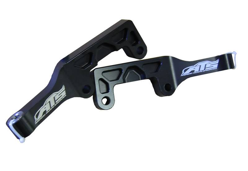

      ATS,AFX Tall Spindle
      Baer Corvette C5 13" Brakes
      Tires 275's up front 315's rear
      Wheels undecided
      I might have forgotten somthing but enjoy the pics
