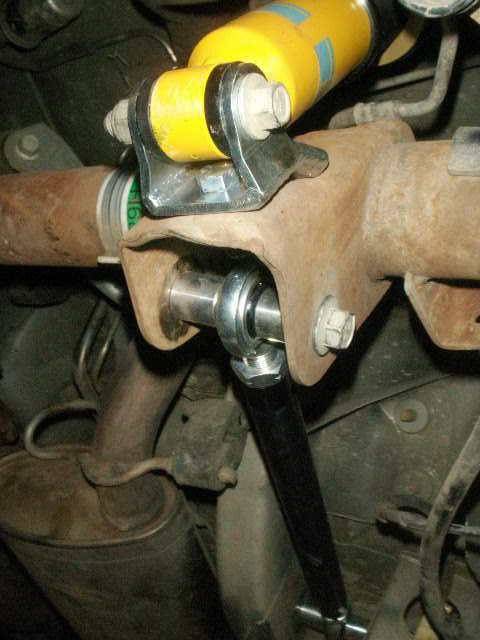

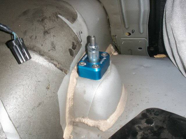

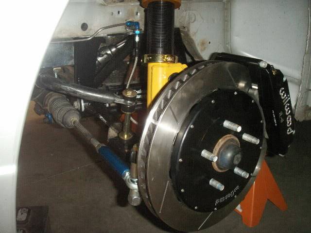

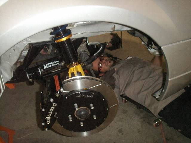

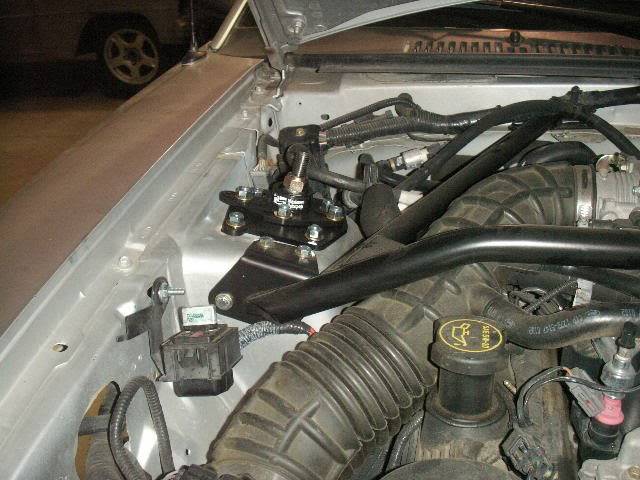

      Lately, Rodger and I have been getting into hotlapping as a way of stress relief so we've both been building up our 2003 Mustang GT's for the track. I recently bought mine and in the last week or so I started to do some suspension improvements. I took the car up to Ironworks so that I had access to all the tools I'd need. Thanks Jason for your help on the installation. Thanks Sean for bending the brake lines and last but not least, thanks Rodger for letting me use your facility and tools to get the job done! I guess he was tired of me using the excuse of "Well my car is stock and yours isn't!" so he let me use his shop! Here's what we did! LOL!
      Front:
      Tubular K-Member, Tubular LCA's, Bumpsteer Kit, Bilstein HD's, Coilover conversion kit, Wilwood Superlite 6 BB kit
      Rear:
      Lighter Road Race LCA's Bilstein HD's and Coilover conversion
      Spherical bearing for the top of the rear shock towers
      Caster/Camber plates for easy adjustment for the Track
      Sean showing how much fun he's having bending the brake line!
      Didn't have time to get the Panhard Bar or the Torque Arm installed but it worked out OK since the MAC Long Tube headers didn't arrive so we couldn't do the TA anyways. I'm also going to replace the rear axles with 31 spline axles, Posi and 4:10 gears. The rear brakes will be SL-4's.

      K-Member is night and day on the car. That and the bumpsteer kit makes turn in SOOOO much easier! The only problem now is that now that the car handles better I find myself wanting more grunt! Will it ever end?!? LOL!
      The spring rates/Shock valving are pretty stiff for the street but , hey, it's for the track right? I can't wait to get it out there and really push it!
