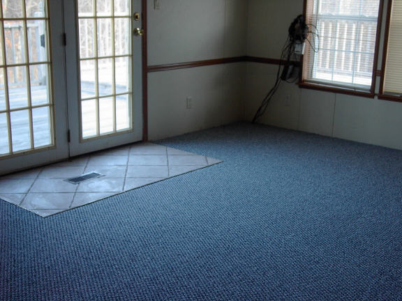

      I am doing my landing inside front door next weekend while wife & kids are away. I am going to do a patter like this. Big tiles are 20" square, little ones are 6.5".
