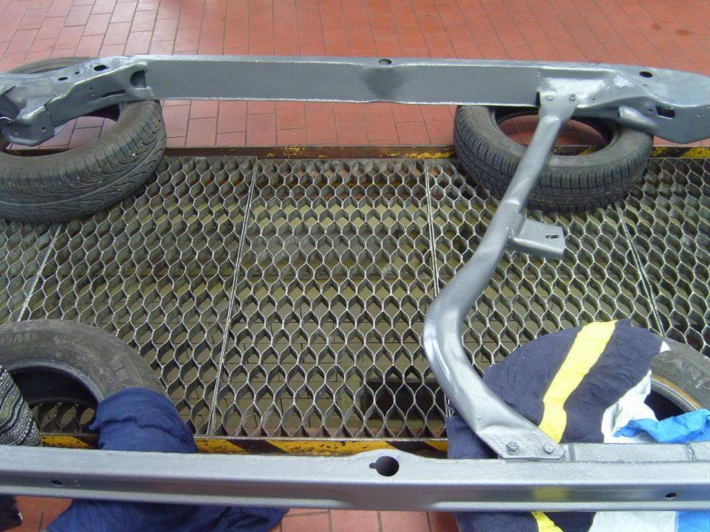

      i boxed the frame on my malibu... and it is a no brainer! it will stiffen more than enough to cut the roof... i also added aluminum bodymounts, with no adverse effects... but it ties in the rockerpanels to the frame and makes for a much more modern feel to the ride
