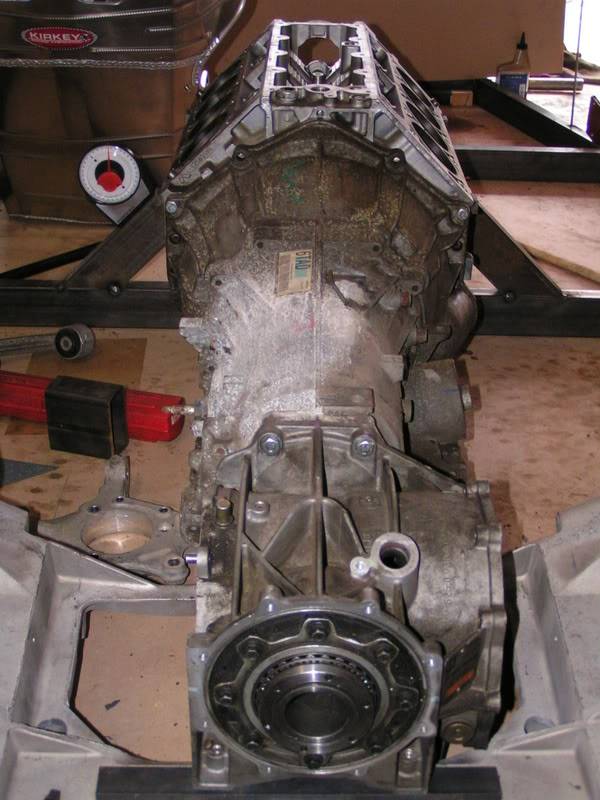

      Holly, MI
      264
      That pic is showing basically all Vette pieces. Starting with the C5 Vette, the transmission is mated directly to the differential. In that pic, they are even using the Vette aluminum rear suspension cradle with some modifications. Here is a pic of the C5 trans and differential mated directly to the engine instead of the torque tube used in the Vette. The complete packaga is about 54" long; much too long for the Ultima. I am using it because I am building my own car and the length was something I could design around.

      BB69,
      What is the dimension from the bellhousing face to the axle centerline? is it the 54" or is that the overall length?
