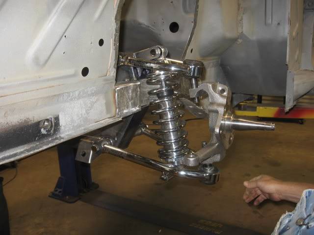

      front suspension goodies mocked up

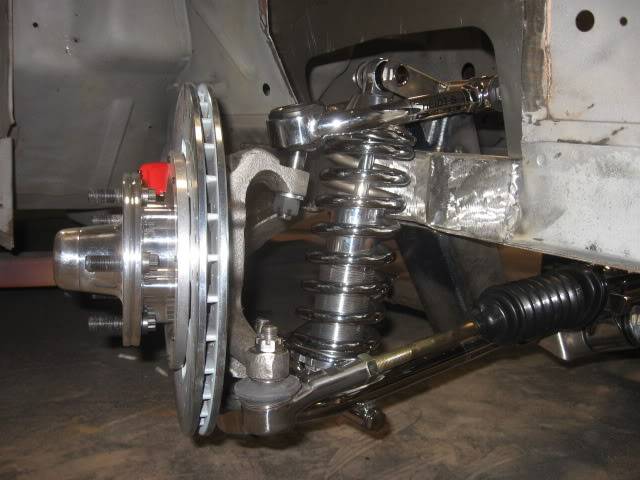

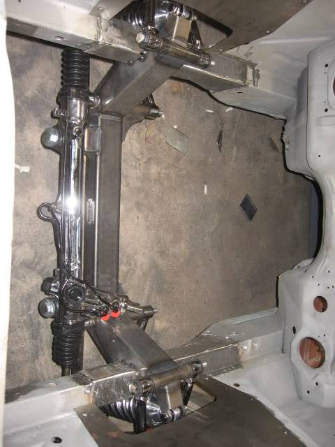

      What front end kit is that? My dad and I are looking to put a mustang 2 type front clip on our pro street stang to make room for the new 557 big block.
      Oct 2006
      174
      Quote Originally Posted by mach1stang
      heidts superride II
      Apr 2008
      310
      Thanks, was it a fairly straight forward install?
      Oct 2006
      174
      yep, not too bad at all
      just measure the 24.25 inches from front and double and triple check before you hack it all up
      :D
      Apr 2008
      310
      Sweet thanks for the help.
