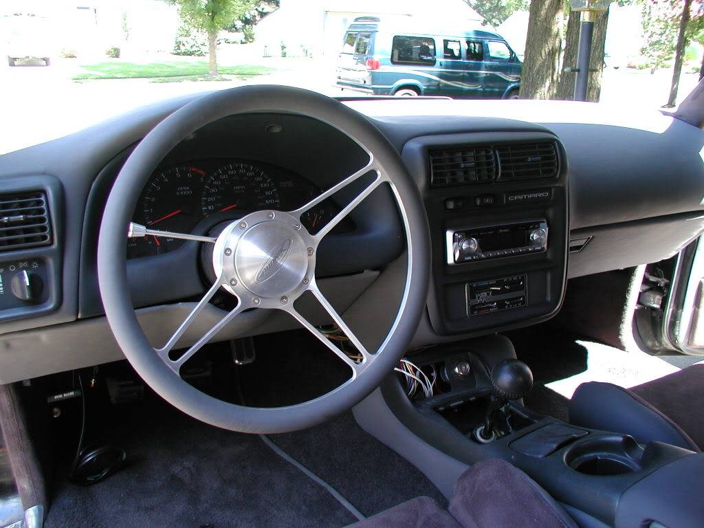

      Here are some shots of mine...it is a '97 dash in a '69.

      Hey Zoomie! how ya been?
      Looks good still.
