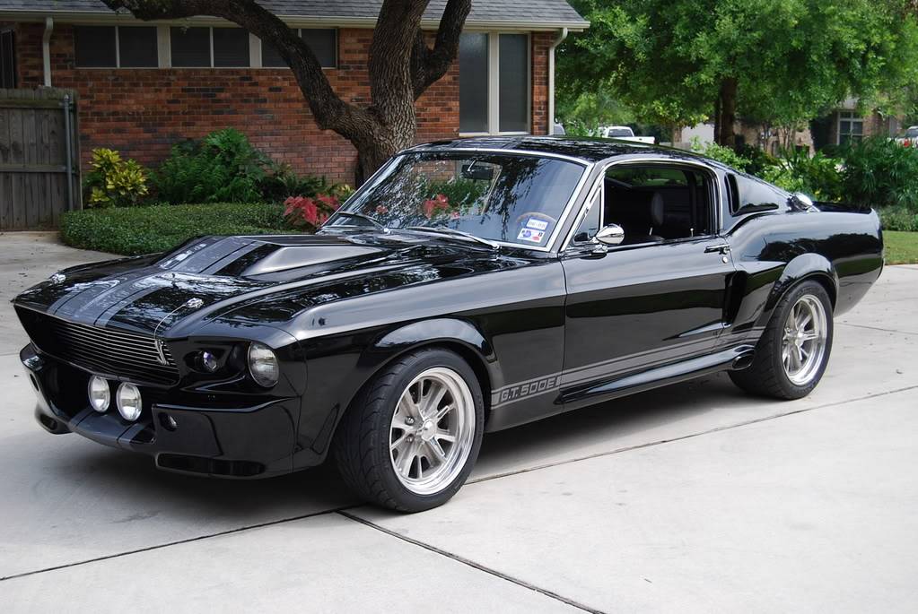

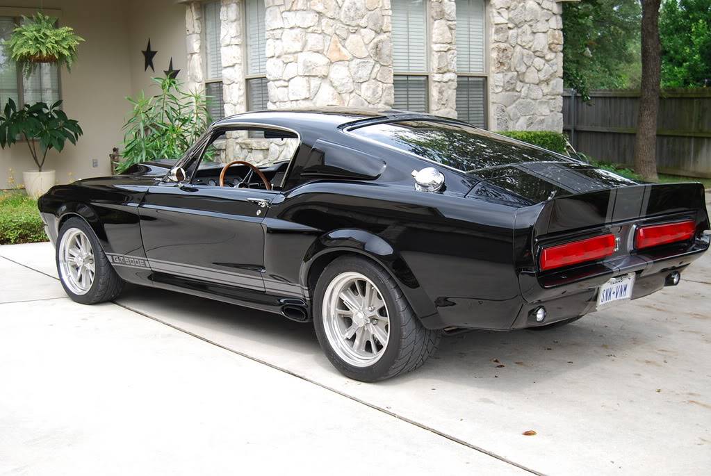

      I wished I would have found this site when I was building my car. It is almost done now.
      She is called Medusa. So named because of all the trouble she has been. Logic being that the snake reared its ugly head, and yep, you got it, Medusa!
      It is a 1967 Mustang Fastback (nothing special, just an old automatic 2 barrel 289 car), with a Shelby aluminum 427FE stroked to 482ci, using a Vortech T trim S/C (non intercooled), buckled to a TKO600, 3.25:1 trac lock, 31 spline axles, front & rear coilovers, Baer track/tour brakes, sitting on BFG G Force TA KD's 225/45/17 on 8"s, and 315/35/17's on 11"s.

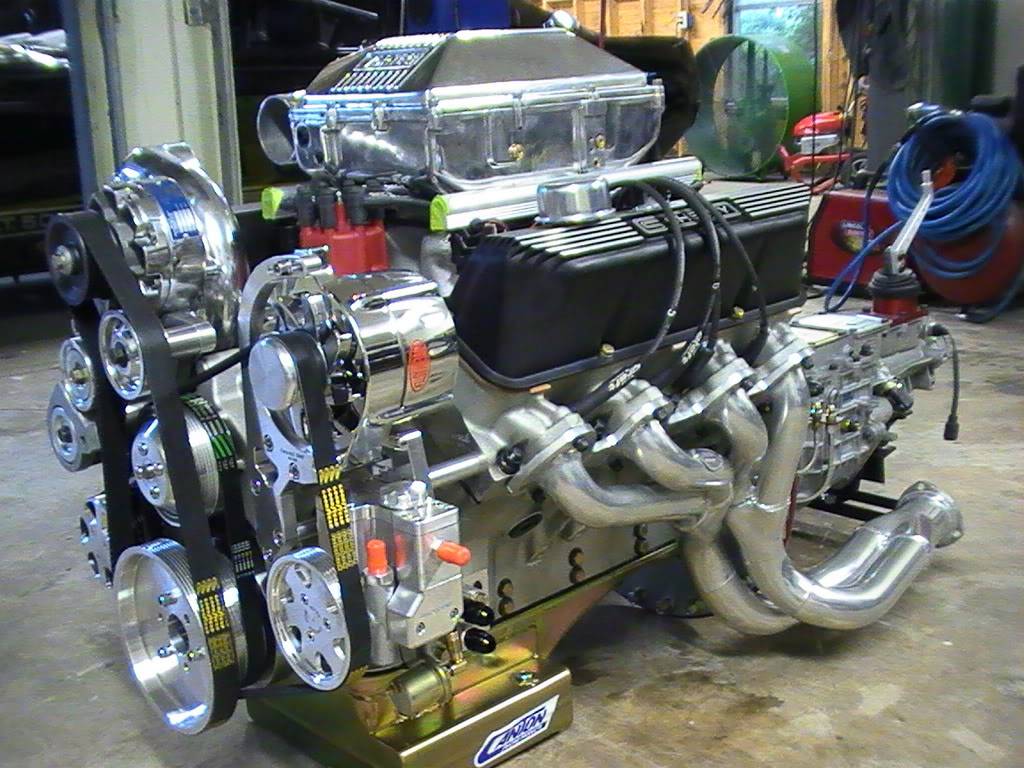

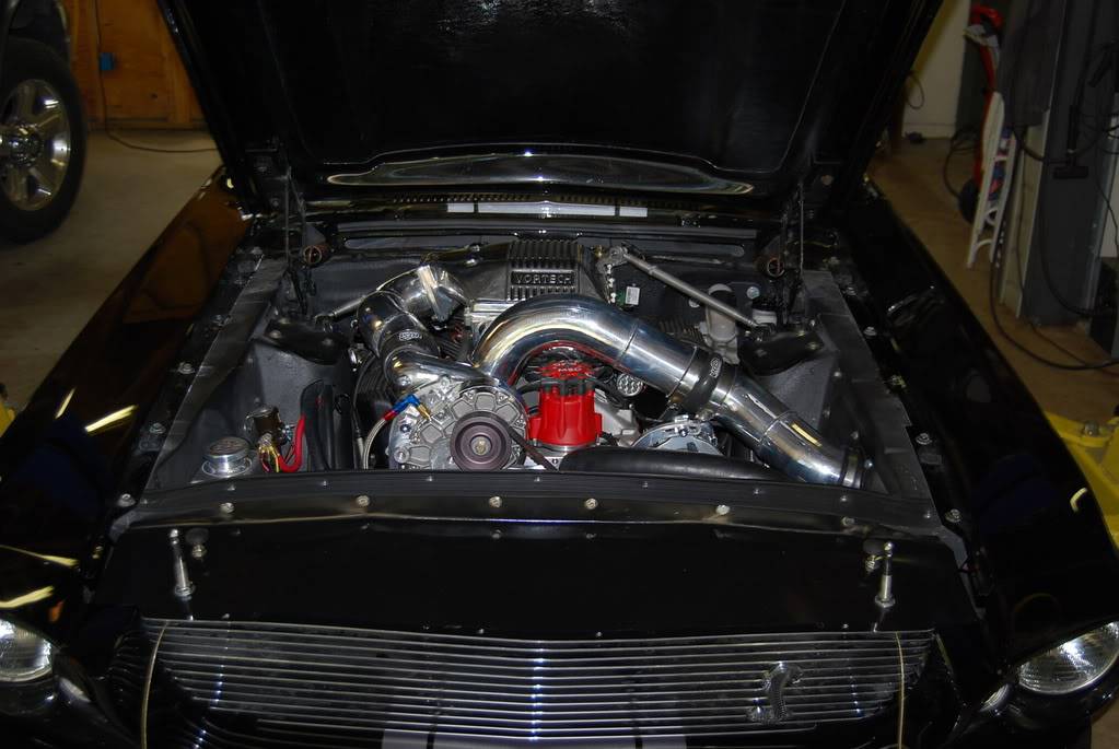

      I thought I would post several engine pictures. Keith Craft built it. Shelby aluminum 427FE stroked to 482ci. Engine dyno said 815hp 733tq. But chassis dyno said 575/573. Since then, the lifters and EFI have been fine tuned. I think it is closer to 625/650 now. I need to get it back to the dyno shop.
