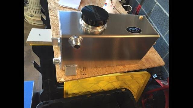

      No progress on the car because of a terrible December and January plus sinus surgery so no bending or laying on the floor. But I did get my intercooler tank made to fit behind the passenger head light and some parts for the intercooler plumbing. The lid fits right between the fender and the radiator to fender bracket.
      Here's the tank it holds 3.5 gal.
      Here's where its going

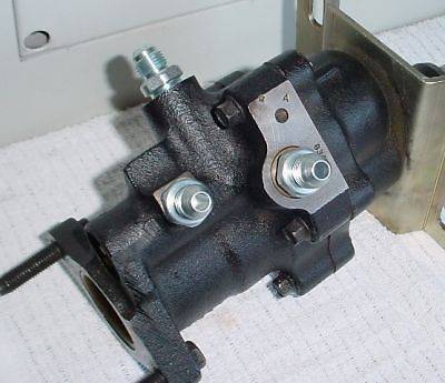

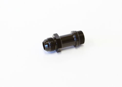

      I got these fittings for my hydraboost.
      These are to plumb the trans cooler for the 4l85.

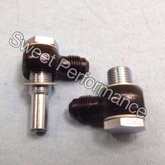

      This is to drop the rear hose fitting on my oil cooler line so it can run one hose above the other along the oil pan.

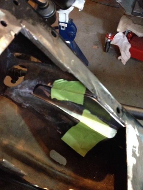

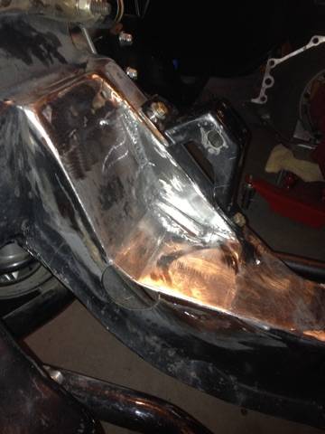

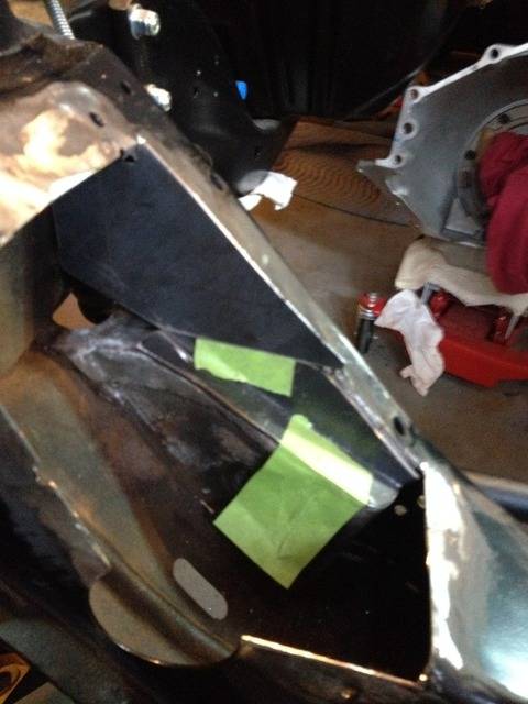

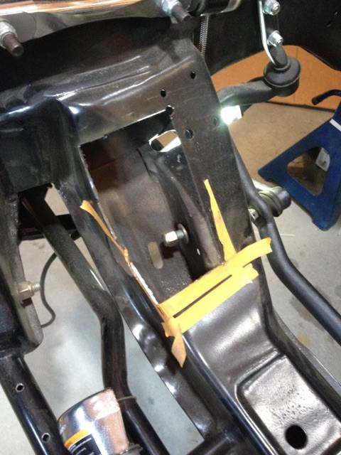

      Hi Did a little work on the car we pulled the motor out and notched the frame for the A/C. First made some estimate tape marks.
      Then we removed the motor and broke out the air tools and started cutting.
      Then these cuts
      We'll fill in the small cut out first then do the final pocket for the Compressor with 1/8" or 3/16" plate.

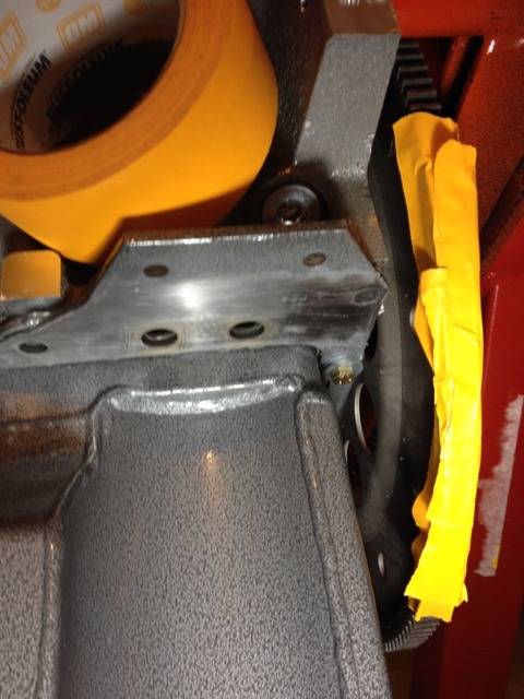

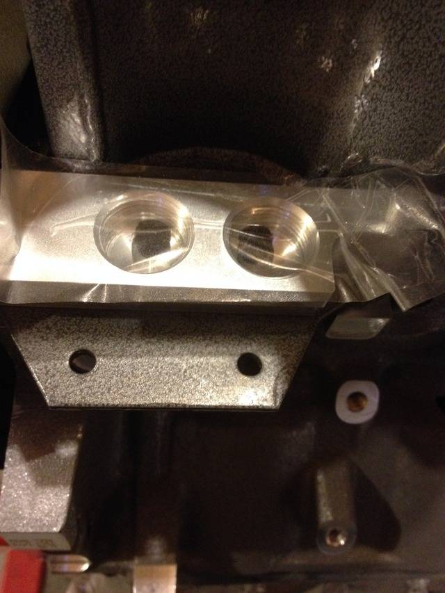

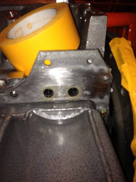

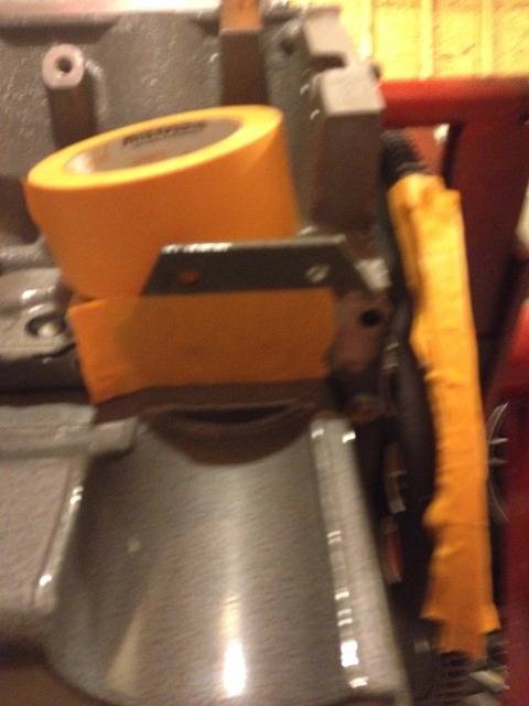

      We also did some work on the remote oil adapter for the hoses. I was going to come straight down with orb to AN fittings then 90 towards the front. But the kick out on the AutoKraft oil pan and my headers were closer than was feasable. We decided to put an orb to An close 90 in the adapter and go above the bump out on the pan with the outlet hose and down then forward with a 120 degree on the return line.
      The pan I got was used and the original owner had it powder coated and left the spot where the O Ring sit to seal the adapter bare. This made a lip of thick powder all around the o rings and I didn't think would seal very well. So I removed the adapter and stripped all the powder coat under where the adapter sat to even it out with where the o ring went. While we had it off my buddy Spaceman cleaned up all the sharp edges on the inside of the adapter to help with flow. so when we are ready to put the motor in we can seal up the adapter and be ready for the hoses.

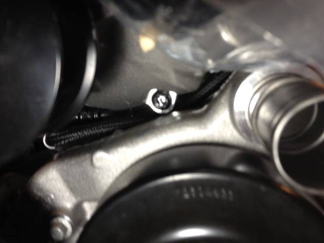

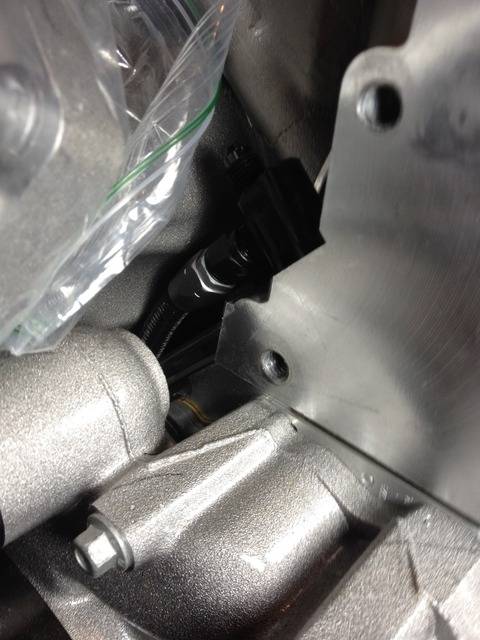

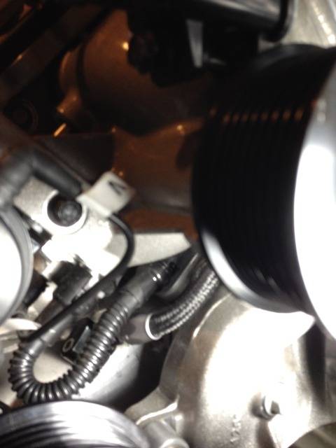

      I made up some braided hose for the steam line which will go to the Finch hose reducer with a line taped in. I'll make the final hose once I can measure it when the motor is back in the car. Boy it's a tight squeeze going between the Super charger and the water pump, But I got it in.
      The only thing is in the last picture the hose is just about touching the water pump so I'll need to put something to protect the hose. (if I can get it in there.)

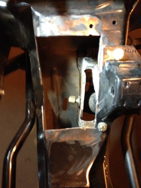

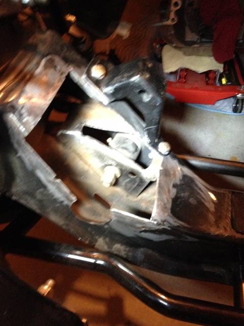

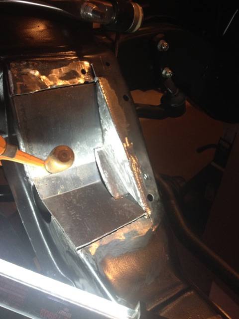

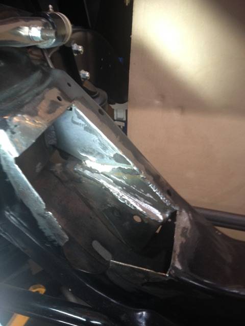

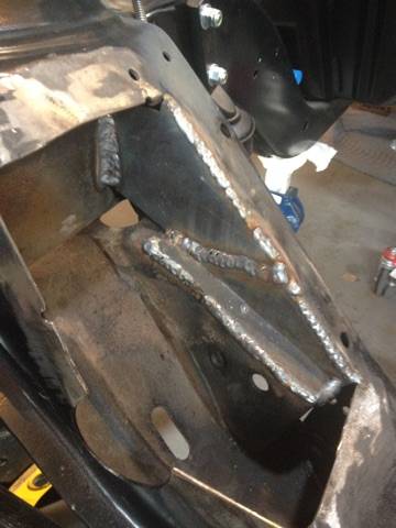

      Got the frame notch all ready to paint .
      First the L shaped piece was welded in so it could be welder all the way around and then the top was ground so the next piece would fit tight against it and also be welded in.
      It was ground smooth so the next piece could be fit and welded in.
      Tuesday

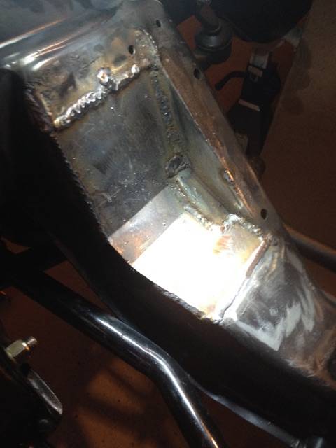

      Then I made the piece and fit it to cover the rest of the opening and Spaceman welded it in.
      At the top he filled a couple of holes in the frame.
      Then I ground the welds down to close to where we needed it.
      When Spaceman gets here tomorrow we'll take a look at the frame connetors where they weld to the back of the frame and decide if we want to do them now or later.
      Feels good to be back out here again.

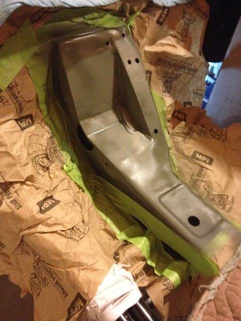

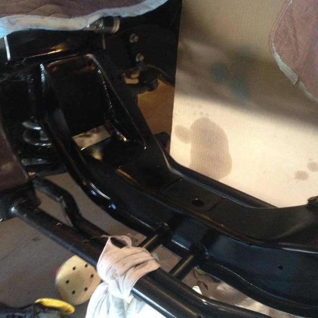

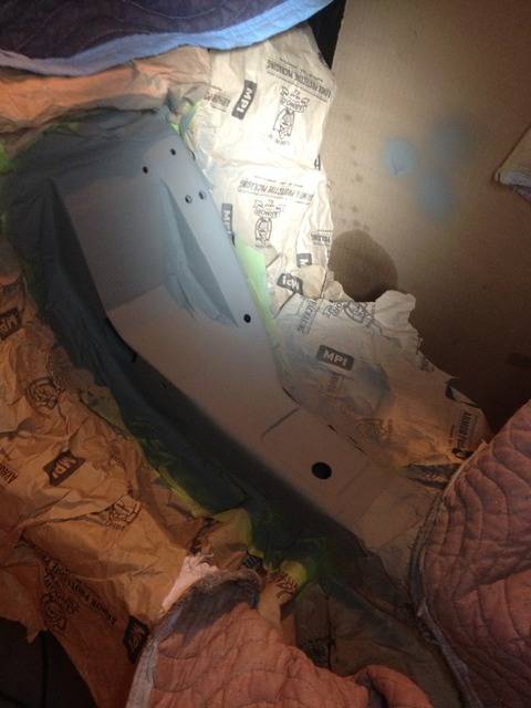

      Wednesday
      I got a little more done today ground the welds down on the frame and preped it for paint. I used self etching primer and will spray the Black tomorrow.
      First coat
      I ended up putting 4 coats, Ill sand it, feather the edges and spray the rest tomorrow.

      Today we got the frame notch sprayed black and mounted the lower A/C bracket to the motor for good.

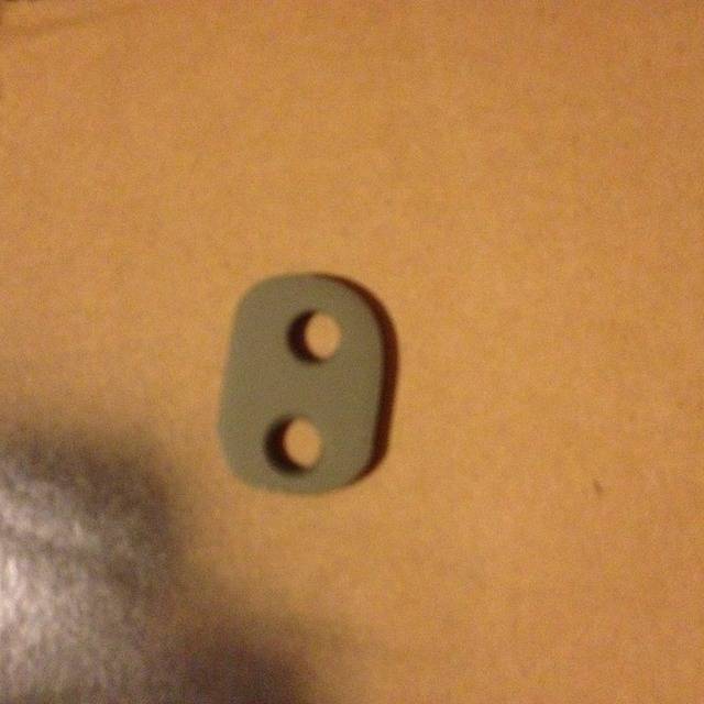

      We had to take one frame mount bolt for the notch so I drilled and tapped the frame for another one. I made a 3-1/6" thich washer (plate) to cover both bolt holes to help hold the frame mount istead of two washers with one side on each ground because they are so close together.
      Not perfect but it fits right to the slant of the frame stannd.
      I'll shoot it black tomorrow.
