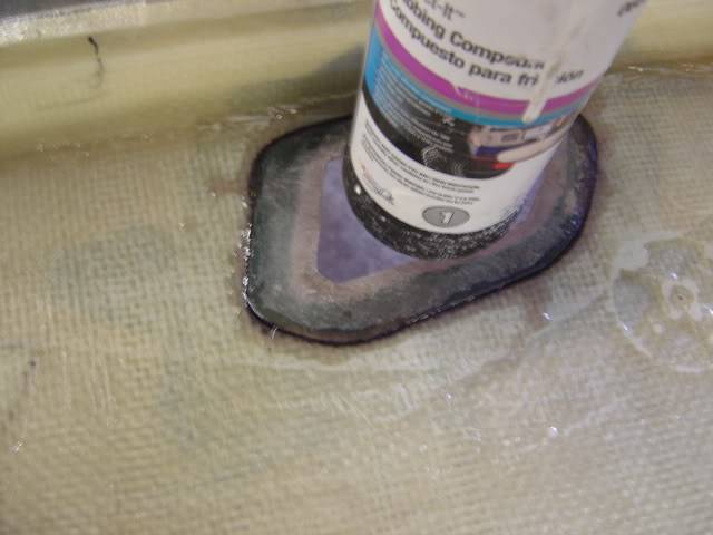

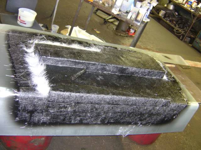

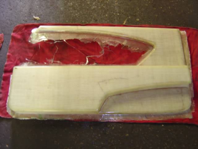

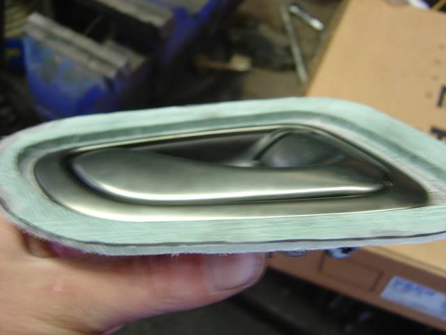

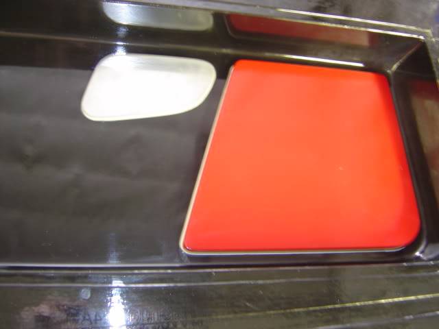

      Finally got back to the door panels. I originally wanted to use BMW handles but the handle body had curves that would not allow it to sit flat. The hunt was on. After looking through fleabay for a few days I decided to hit the local pick n pull hoping to find something I liked that was flat. I finally spotted these in a Mitsubishi Diamante. Since deciding on the handles I also decided to repop this panel so that the recess for the handle and the recess for the speaker would all be moulded as one piece versus bonding them to a finished panel. The end result would be no chance of the recess delaminating from the panel itself. Tomorrow I'll start on the recess for the speaker and grille. In the mean time this panel will serve as a mock up panel.

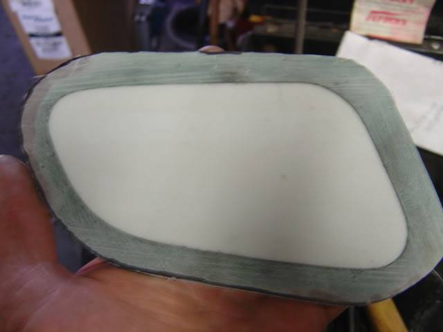

      The white insert will be bonded into the mold I made earlier so the recess will be one piece with the new panel
      recess glassed in

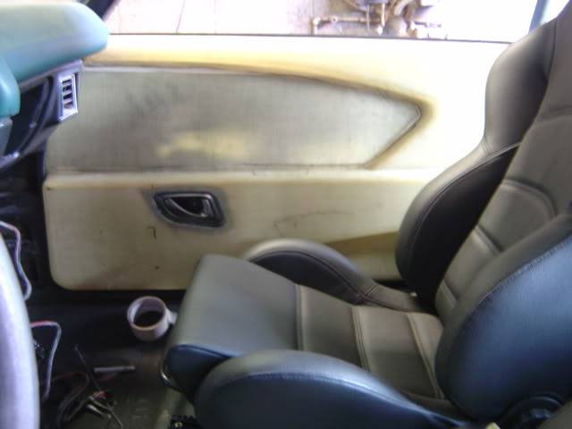

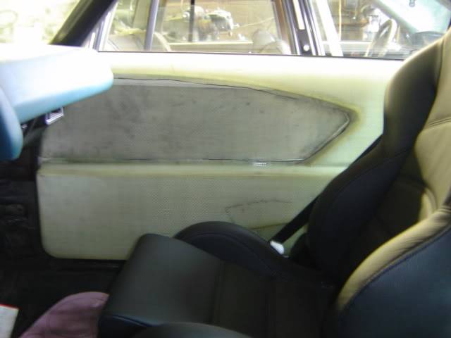

      Had to throw it back in the car to see how it looks.

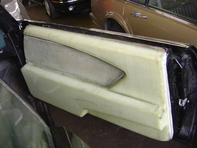

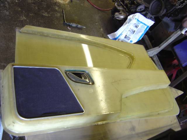

      I got the speaker recess figured out and a mounting system figured out. The grill cloth isn't pulled tight yet it's just laying in there
      Backing panels finished and upper rails bonded
      And then there were two. I'll be making a new mold for the passenger side with a much smoother finish that incorporates the door panel recess and the door handle recess so they dont have to be bonded in later. I should have molds for both front panels in the next week. Then I'll get started on the rear.

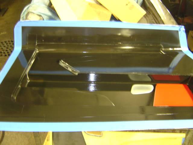

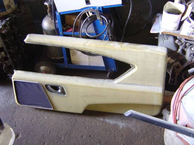

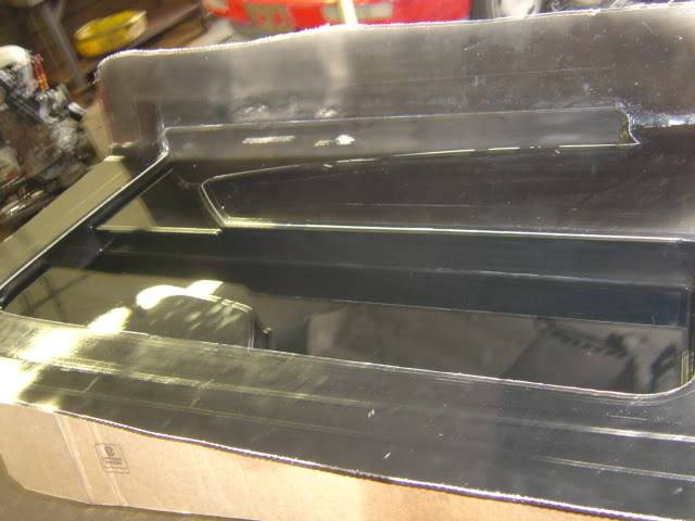

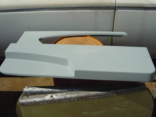

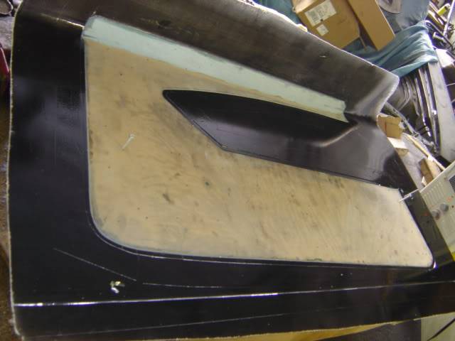

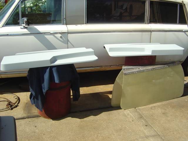

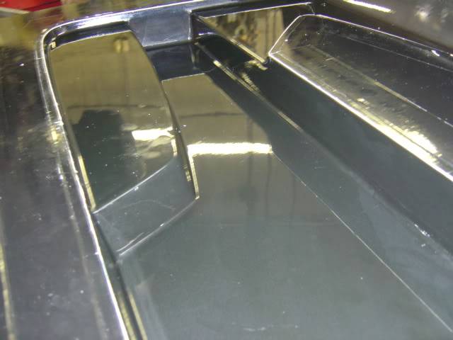

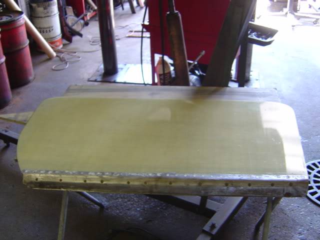

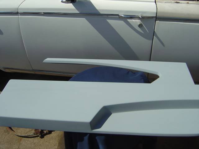

      Finally got around to mold 2.0
      Tony L
      5,560
      Nice work.

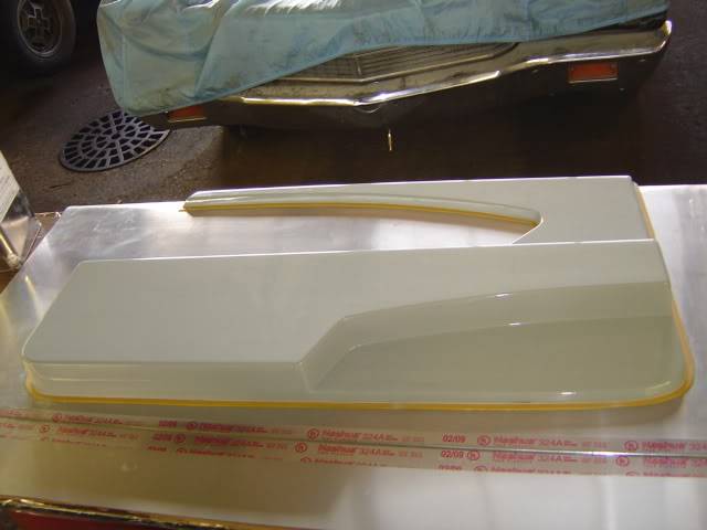

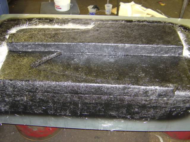

      Pics from yesterday

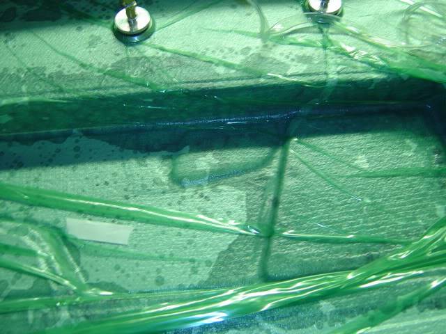

      PVA sprayed
      Ready to roll

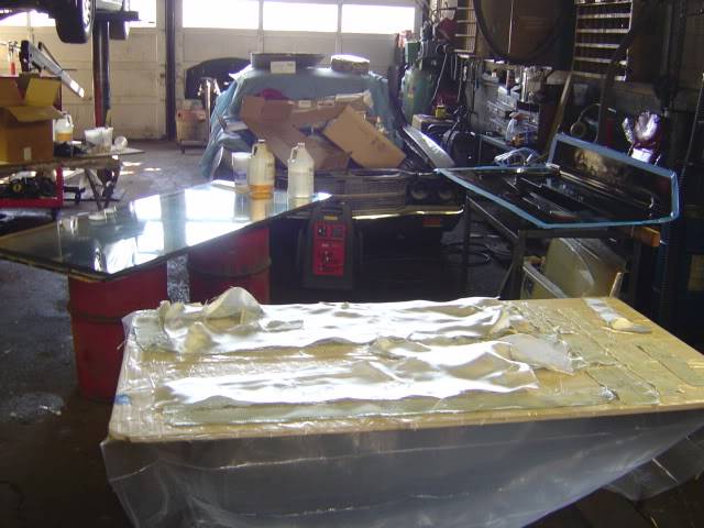

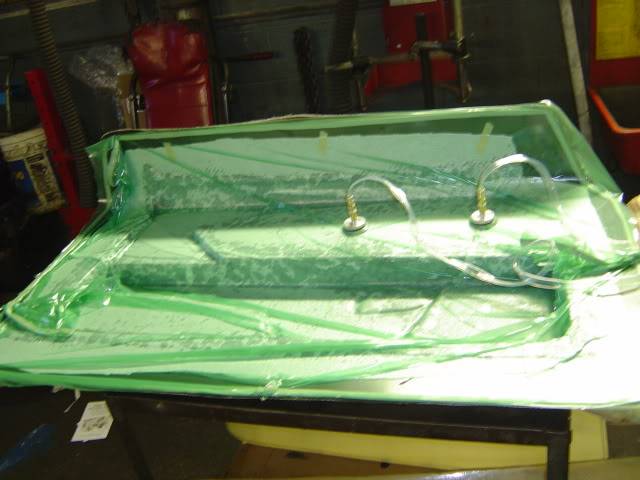

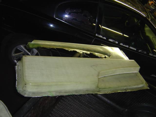

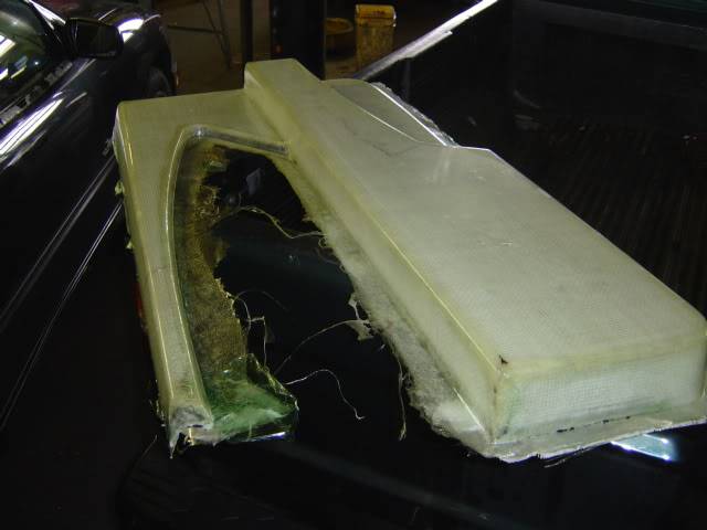

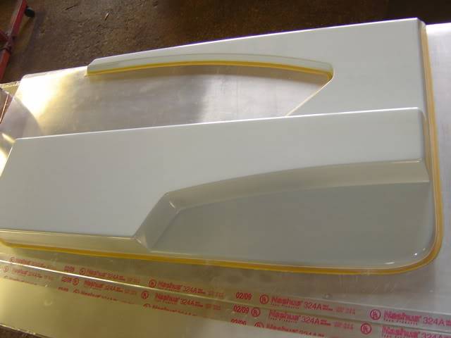

      I pulled it from the mold today. I'm really happy I remade the mold. At the last minute I made the decision to add some Nomex honeycomb and I'm really happy I did.The panel is extremely rigid.
      Release film
      After the bagging materials were removed Icooked for a day and a half with some flood lamps
      Out of the mold
      Trimmed up

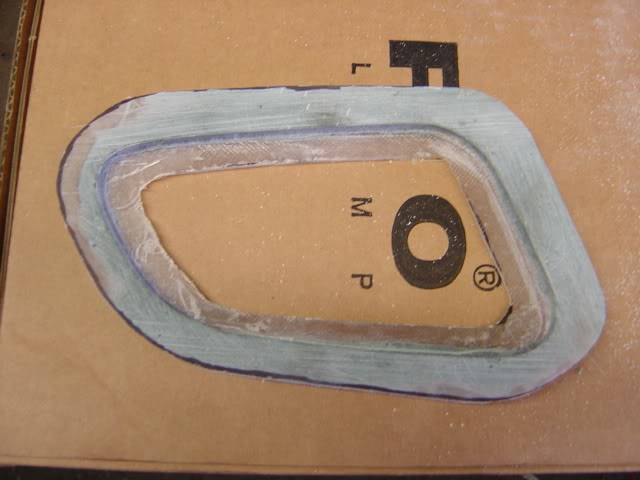

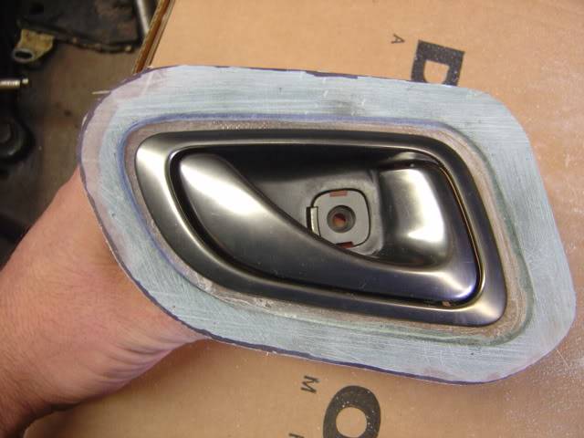

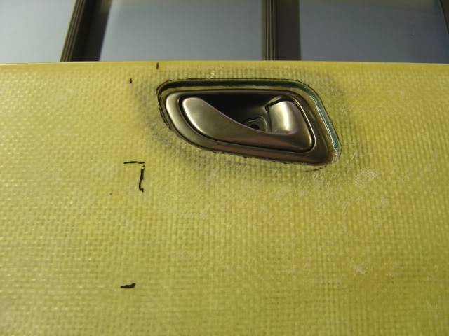

      Slow but steady progress. I did not like the look of the door pull just sitting in a surface hole so I made a pocket for it.
