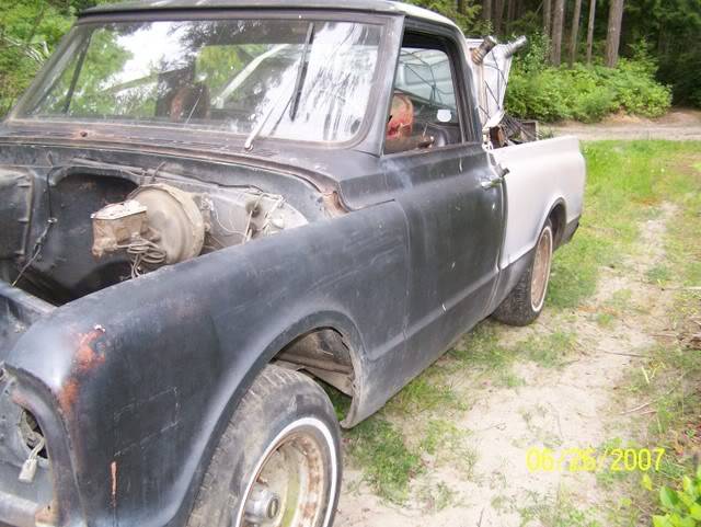

      So I bought this:
      This is a 68 chevy short bed with trailing arms.
      I'm going to be using only the frame, parts of the rear suspension, and parts of the bed.
      I'm going to be starting on stripping down the 68 to the frame on Sat. Hope to get it all taken apart in 1 day (no engine or tranny to mess with)
