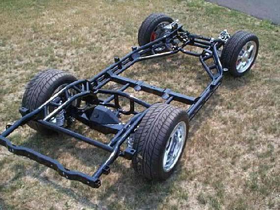

      I think this is what your lookin for.
      It's the SRIII.
      Look on the web for SRIII motorsports.I think they have what you need.They are proud of them though!$$$

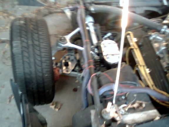

      I converted mine myself to the stock frame.C-4 suspension Is a pretty easy swap to most frames With a little planning and some time.By far it's the best thing that I have done to my vette!
