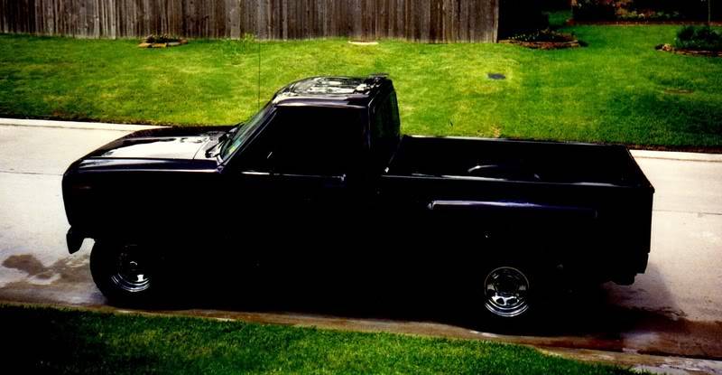

      Just after graduating highschool 11 years ago I picked up this F100 Flareside with a bunch of goodies including a 460 big block that had been swapped in. The truck had quite a bit of custom things done to it including louvered tailgate, tail lights that were recessed into the flare, door handle delete, custom bumper and roll pan smoothed into the body, custom paint, and a few others. One dislike I had was the spoiler on the roof, but at the time I didn't seem to mind.
      Here's a grainy picture I've saved...
