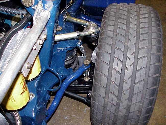

      This is gonna look a little freaky because its actually a 2nd gen subframe grafted to a 1st gen Mustang (don't ask) but he did a coil over setup using adjusters and a retainer chain based off some circle track stuff... the car is VERY fast at Thunder Hill
