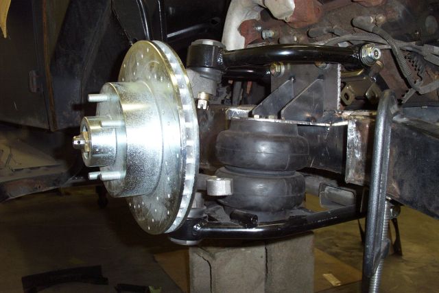

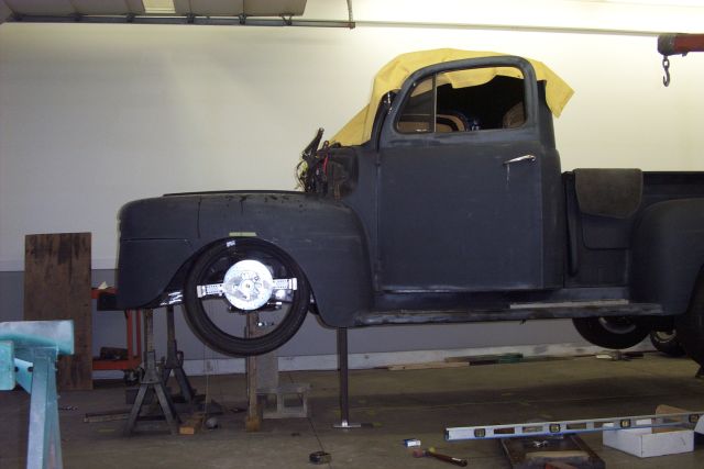

      Hello, i have been reading on here for a while. But now i have a problem and figured i would ask.
      Were building a 1949 F-100, putting a Mustang II set up on it.
      Made our own crossmember2"narrower then stock, stock legth arms, now we need a rack, i have been talking to steve at Unistree but we really want power, and they can only do us manual.
      I got thinking i was wondering if anyone runs a circle track set up on the street.
      I have also thought about full hyrdo set up from PSC.
      If anyone know something or can point me to someone that would be great.
      Here are a few pics of the truck.
      Thats a 255 set up for a 20x8 at 5" ride height
      Small brakes, looking at upgrading those.
