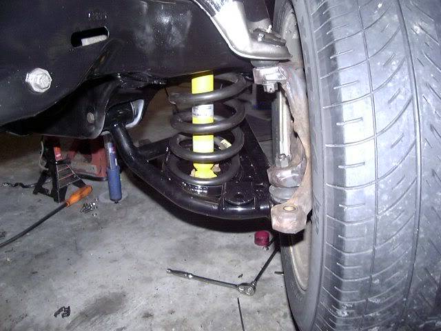

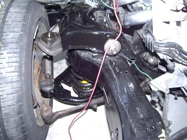

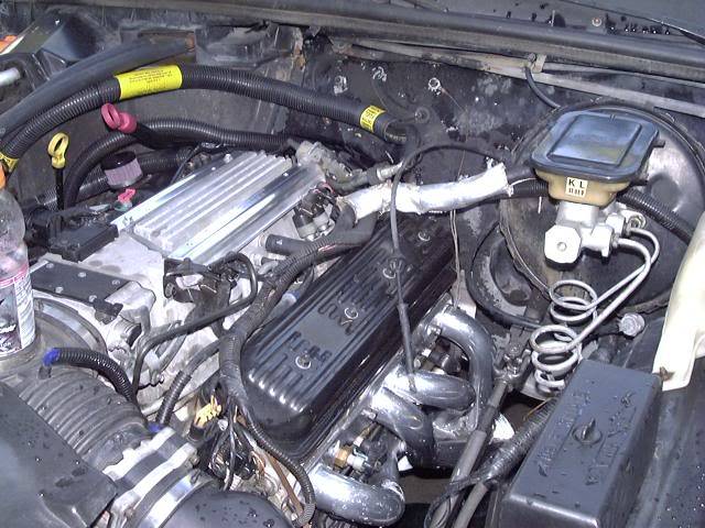

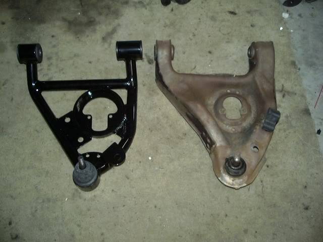

      little more progress this week
      ordered a ton of stuff so it should keep me busy for a bit .

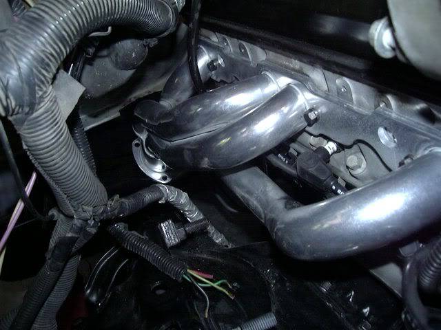

      Got my headers
      and some g body.com lower control arms and new bilstien shocks all around
      and i got some prothain body mounts for later and i had some help from a little friend today ..lol
      Imagine my suprise when i was out there in flip flops and seen him .Also got my NGK plugs and taylor wires and added the front accesories back on ,still have to get the pressure line from a caprice for the power steering.

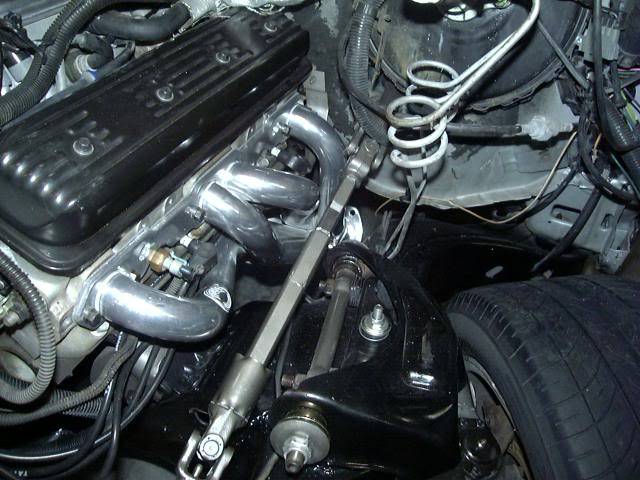

      Progress looks great!
      What headers are those? look more like a mid-length than a full length.
      Are you planning on keepting the stock spindles and running taller upper & lower ball joints? 12" or 13" brake conversions?
      I've got a bone stock '87 SS thats been sitting in storage for the last few years, this build has me wondering why the hell that is...
      Morgan
      '87 Monte SS
    7. #27
      Gum spring,Va.
      50
      Thanks Y5e06,yea they are mid length hookers ,i got em cause i wasn't real sure how long tubes would work out alignment wise with this jegster crossmember ,I have been talking with a guy on monte ss forums about his swap and just getting some pointers from him.worst part is the wiring,far as the spindles ,not sure yet ,prolly gonna do the global west tubulers and b body spindles for 12 inch brakes later on.
      start modding that monte ,i don't think there gonna bring much in the comming years.

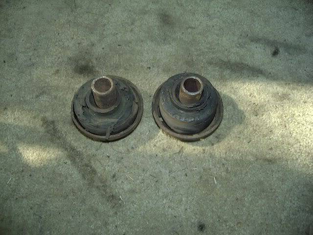

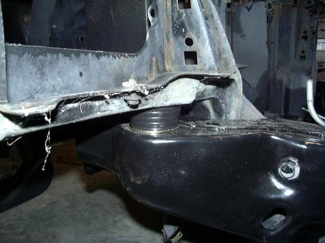

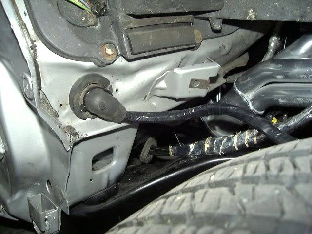

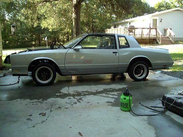

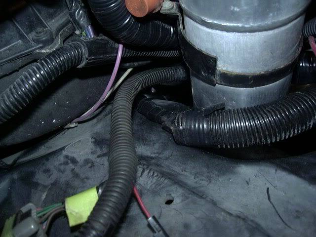

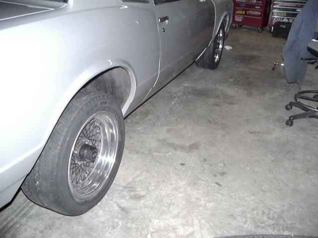

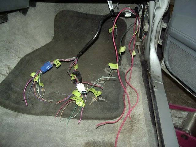

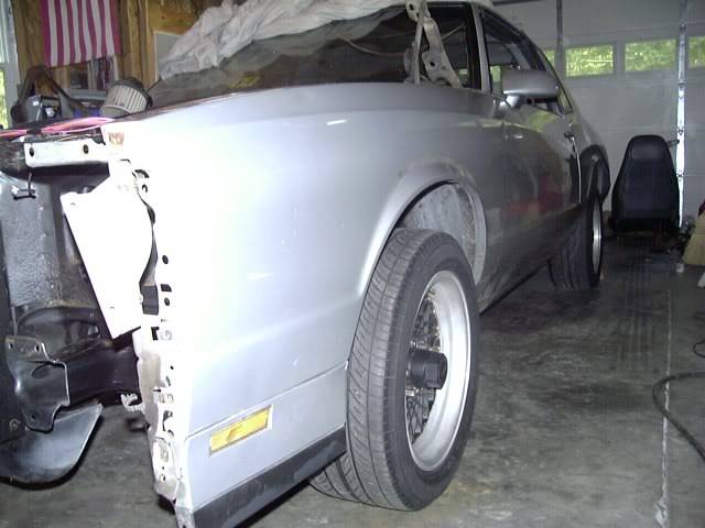

      ok got alot done this week seeing as how I'm unemployed,good thing I bought the parts before hand , got the body mounts swapped out ,they where horrible
      once I replaced em and torqued em down ,the body sat about 1/2 inch higher.lol

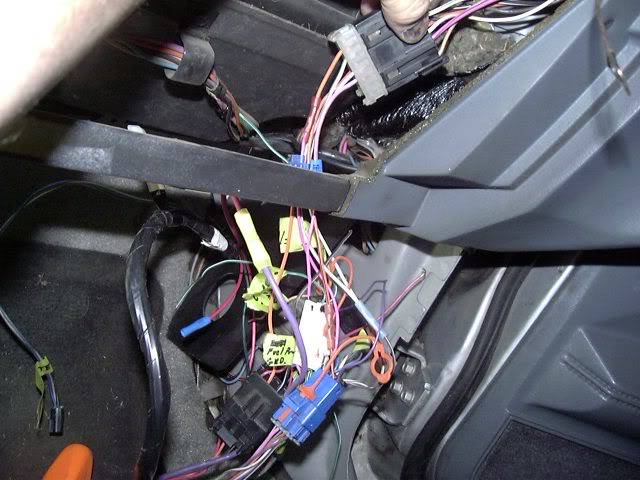

      then I rebuilt the door hinges ,got the camaro harness all intergrated with the monte harness
      used the pig tails from both cars to avoid any cutting of either harness
      added a autometer oil pressure gauge ,to replace the crappy dash one ,installed my TCI deep tranny pan ,replaced all the shocks with bilstiens,and got the front end all wrapped up except for the sway bar
      and tried out my GTA wheels and adapters ,looks like its gonna be just right
      Wiring on the pass fender ,the loom in front there goes down to the firewall and I used the old firewall plug cause the camaro one was too small
      then the loom for the computer wraps behind the recever dryer assy
      looks almost like it was made for the monte..lol

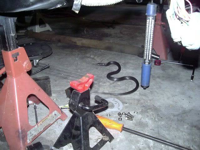

      Damn, no one else is going to mention the SNAKE????
      What is the story there?
      Bill
      Trailers are for BOATS!
    10. #30
      Gum spring,Va.
      50
      lol that is a black racer ,I was just out there one morning taking some pics and went to take some underneith and just about ran right up on him..lol he did seem to enjoyt having his pic taken till I ran him out of the garage with a stick.

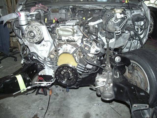

      well I am at another job now ,I work at a small powdercoating shop that does some restoration work on the side ,so I can powder coat anything I want for free..lol but here is the wheels I'm thinking of powdercoating with silver mesh.
      And I got the rad installed and the wiring done ,and the relay box for the ecm power and camaro fans installed on the pass fender.

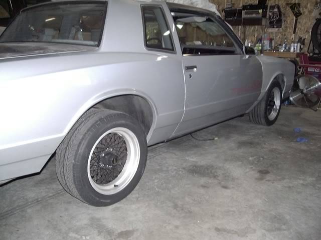

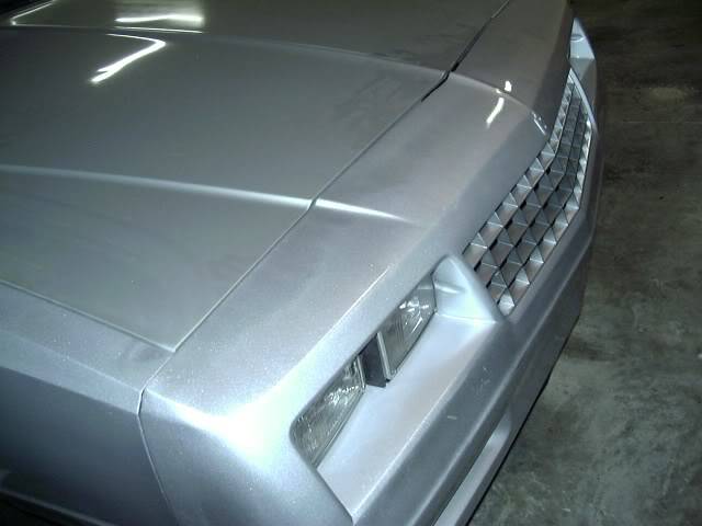

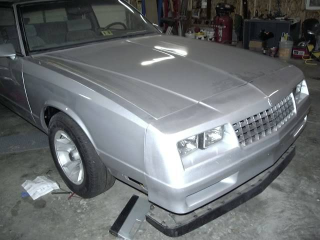

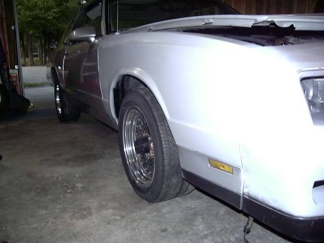

      got a driveshaft made and the f body accelerator cable worked perfect ,just have to bend the pedel back a little to take up some slack in the cable. also painted the nose and fender ,but its not a good match .a little too silver and to much flake .but i'll be painting the whole car later this comming summer.
