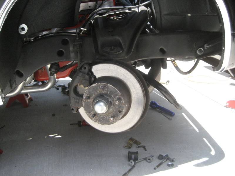

      Today I finally had the time and enough parts to get underway with the installation of:
      - Speedtech UCAs
      - Speedtech LCAs
      - Hotchkis Coils and Swaybar
      - ATS "AFX" Tall Spindles.

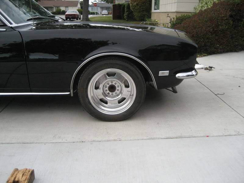

      As soon as my Forgeline ZX3Ps (18.9.5" in gunmetal) arrive I'll finish up with C5 brakes. So far I'm very pleased with the results... I forgot to take ride height measurements in advance, but I think I got somewhere between 2-3" drop. Once I get tires and wheels on it should be awesome.
      Before shot...
      http://s34.photobucket.com/albums/d1...t=IMG_0176.jpg

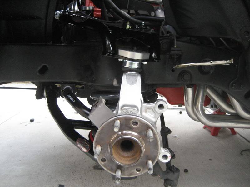

      And after...

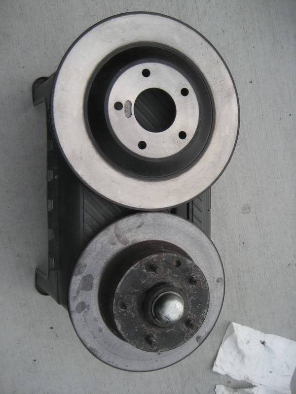

      The difference between 72 A-body and C5 rotors is hardly noticable to the naked eye... yeah right...
      before....
      and after...
