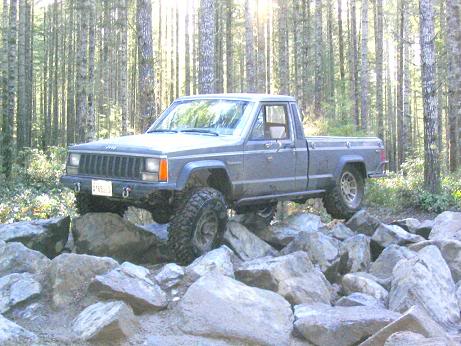

      I happen to own a Jeep P/U that I use for rockcrawling. It's quite an experience getting behind the wheel of my Riv right after I drive the Heap (or vice versa)

      Don't see too many of those anymore Katz, cool truck.

      Thanks (it's nowhere near nice, acutally). There are quite few Comanches up here. I got mine in NorCal last year. It was cheap, has 4.0L, short box (shorter WB), Dana44 rear axle and 5sp stick - just what I was looking for.
