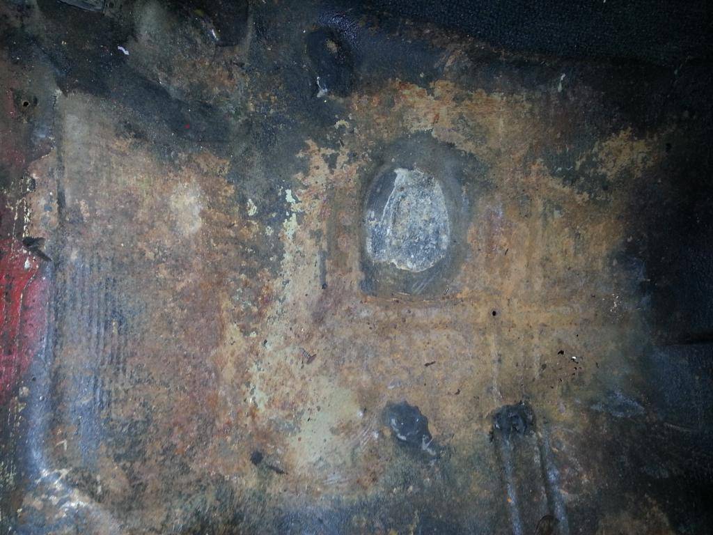

      Here's some rust carnage. Everyone loves rust..
      Actually it's pretty good, I think the heater or AC leaked on the floorboard and they never did anything about it.

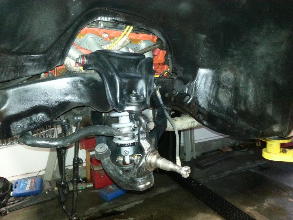

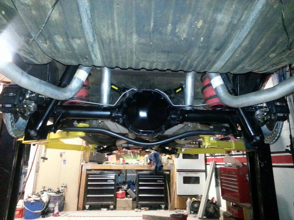

      The brakes are on the car. I had to get different brackets for the 'Olds' rear end with Moser rear axles (no C-clips) but CPP set me up with what I needed.
      Replaced upper and lower control arm bushings on the front. The rest of the front end was in good shape from a recent rebuild. Pulled the front lowering springs and shocks out and replaced with QA1 coil overs. I may go back if these are too stiff, but it's nice to have the height adjustable.
      The sway bars have already been upgraded front and rear. But I added adjustable tubular control arms in the rear to get rid of a bit of dog walking. I pulled out the coil overs (overload shocks) on the rear and left the bags and lighter coil springs (out of an 84 elky) to try to get the rear end down a bit. Seems to be pretty good considering the size tires I have on there. I may have to spring for some lowering springs in the back. We'll see how the stiffness is in the front before I mess with it any more.

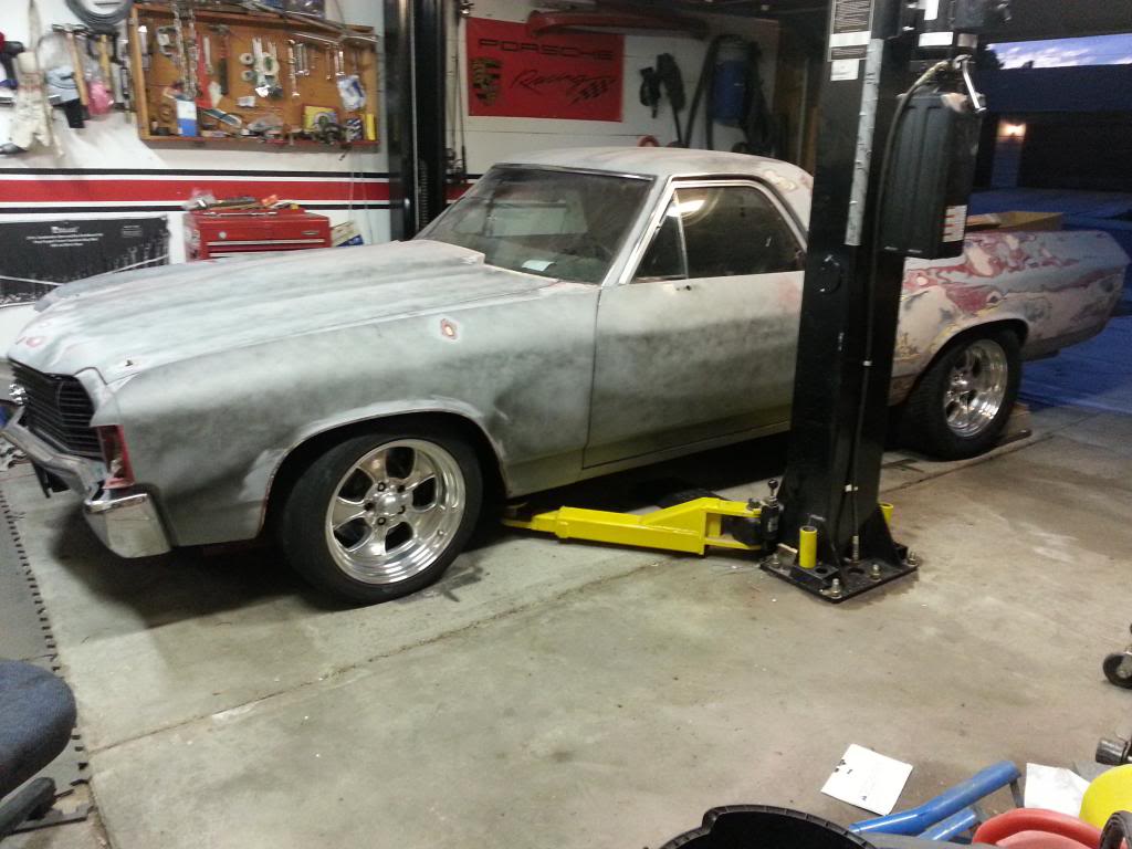

      The body work is underway. Lots of sanding to do. Minor rust re-repair in the RS lower fenders.
      Thank goodness my Son is a skilled welder, I just seem to blow holes in everything.

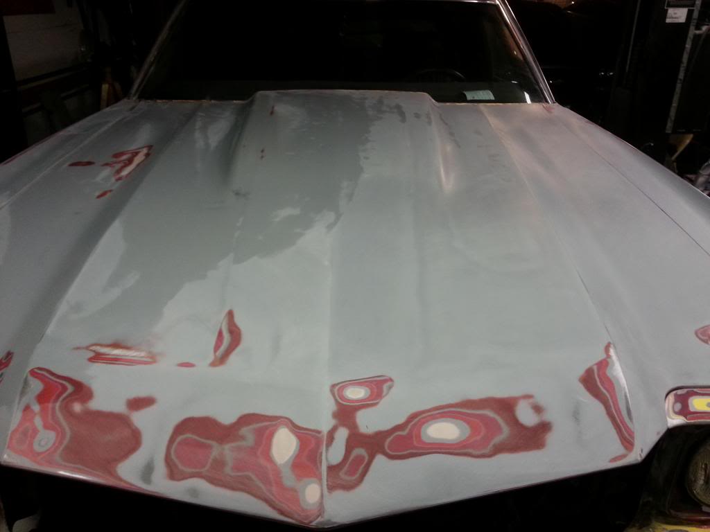

      Sanded the hood yesterday, It came out pretty good, but had some weird lines from old hood stripes I think. Still, it's in good shape. On to other panels.
      So, I'm finally making progress.

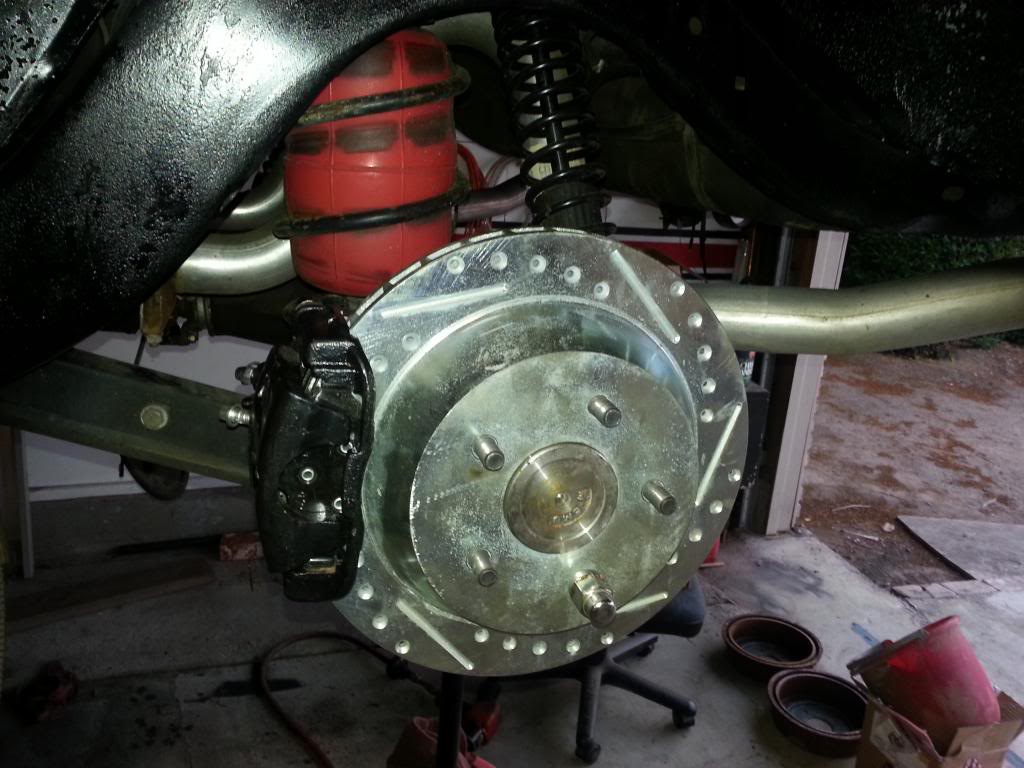

      Some brake pictures. Sorry most of the pictures aren't the greatest...
      Front

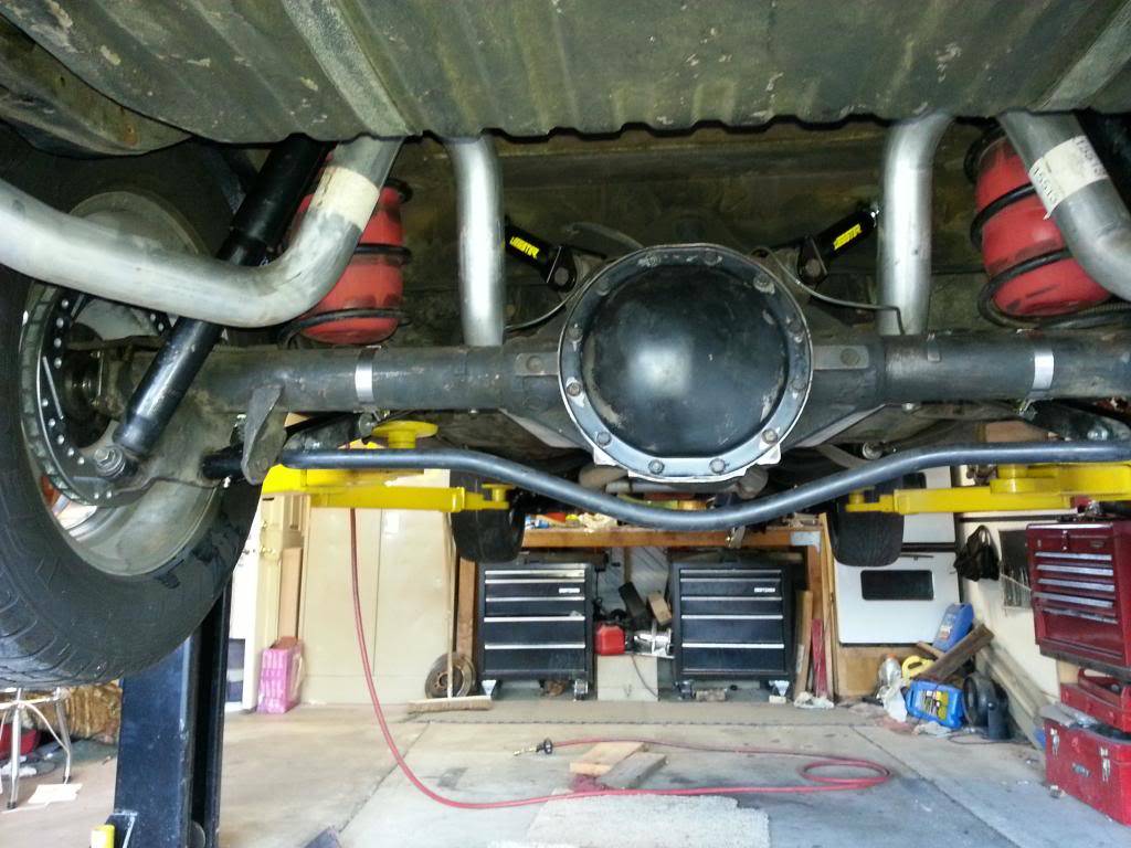

      Rear

      I just did a couple hour stint sanding the front end. That's about as much I can handle at a time. But I have to keep at it, even if only a little bit at a time. I don't want the project to go stagnant again.

      Michael, I haven't towed much, but hauled a bunch. The bags help a lot. I left them separated so I could add more air to the right one in case I did much drag racing. (that hasn't happened near enough). I also had a set of overload shocks on it, but one of the things I'm trying to do is to get it down in back, so they are off for now. I toyed with building a shock mount lower on the axle to keep them, and that may happen. As you can tell I'm on a real budget. Trying to do this rebuild with minimal purchases and my store house of new parts I've acquired over the years.
      These pictures are prior to adding the overload shocks but after bags.
      Oh BTW, this was close to 2000lbs when you add my wife and I to the load.

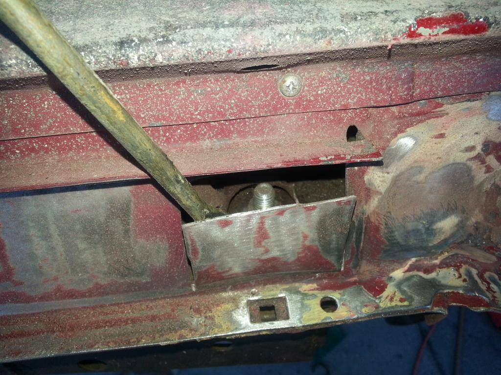

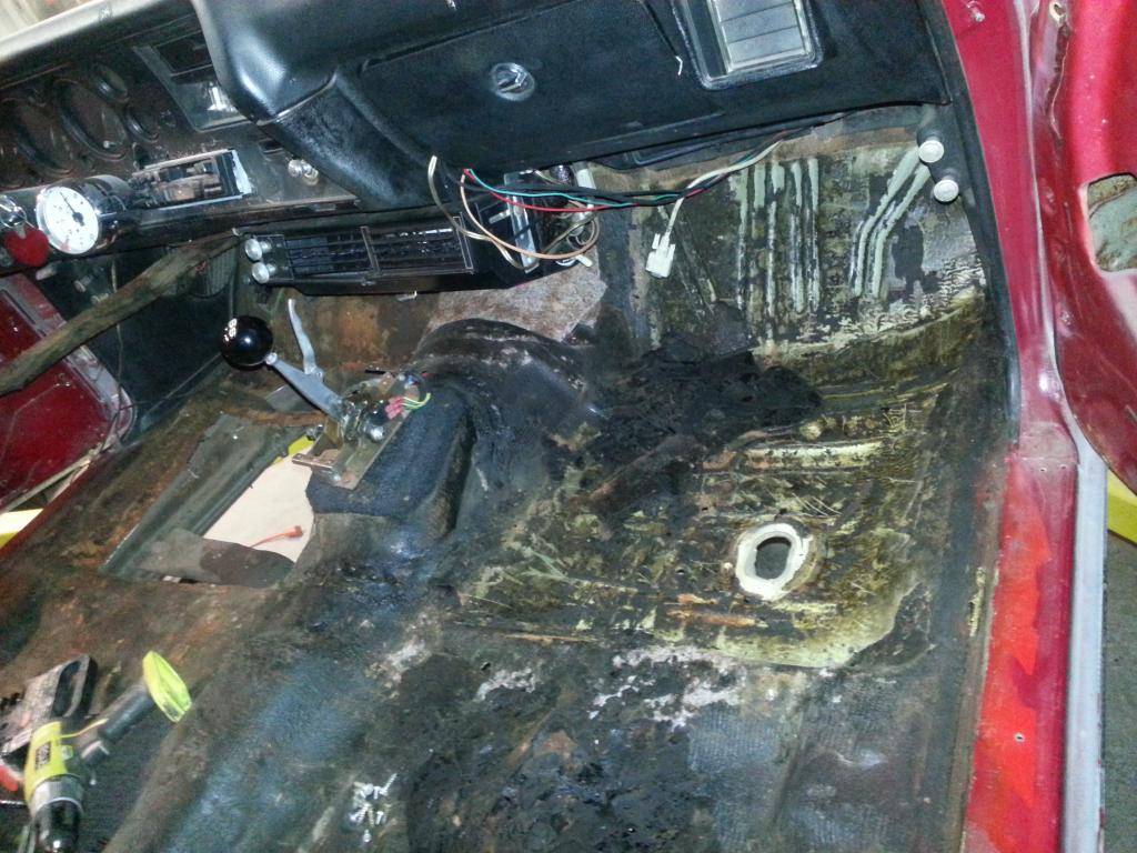

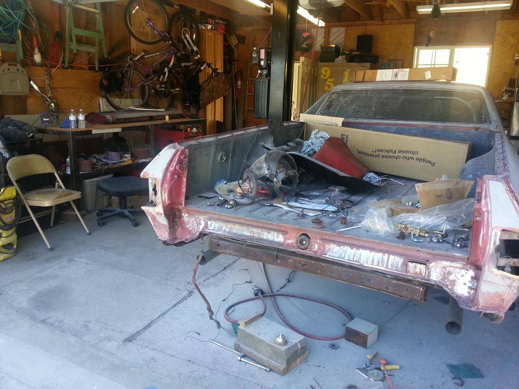

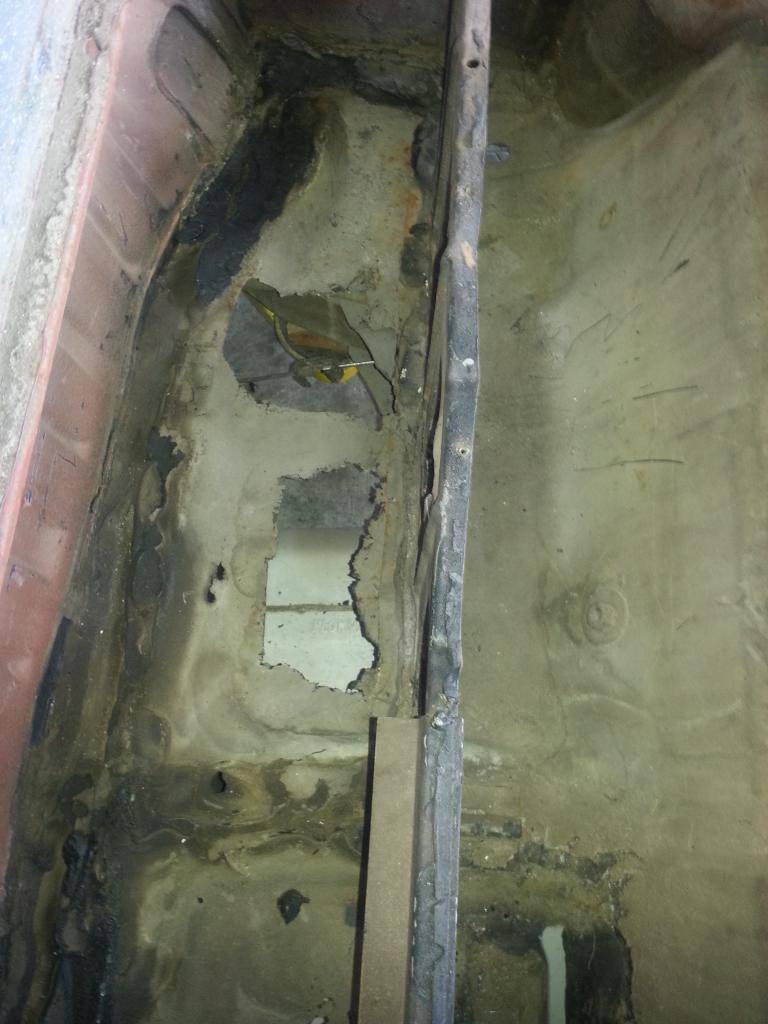

      I decided to take a look at repairing the rust that I could see in the smuggler bay area. It was only visible from the bottom. Many years ago I found the inside looked fine. I took another look at it from the top and found the false bottom pealing away. I dug out a large patch of galvanized sheet metal making it look repaired.

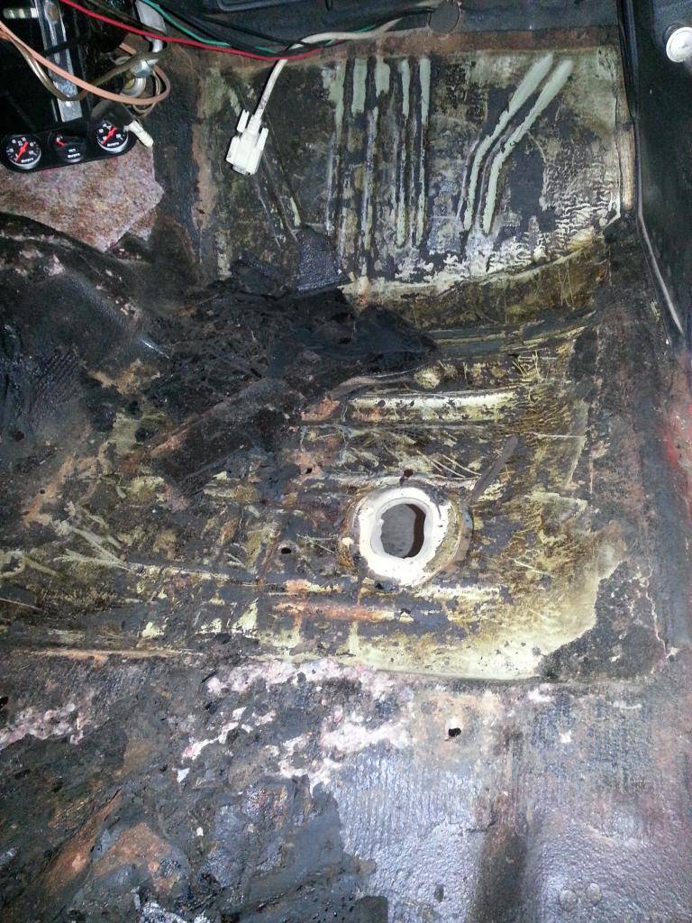

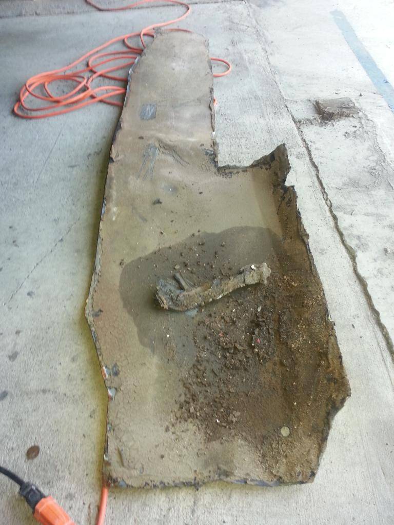

      While I was in a deconstruction mood, I cut away the drivers floorboard.
      The passenger floorboard was covered with a tar like substance that fortunatly came up very easy and apparently protected the area. Not sure why that side was ok and the other was not...
      Much of the interior has been removed so I could repair and confirm that I was getting all the rust. Looks like aside from the know bad floor in the drivers floorboard, there are some rusted thru areas in the back of the seats.
      More cutting to do here. We'll see how much as I start getting into it.
      In the meantime, I've removed the interior (obviously), the front end leaving the fenders. The rear bumper and tailgate so I could repair a bad body bushing.
      I finally found the rear e-brake cables so I moved calipers back of the axles so I could use them and I reinstalled the overload shocks, but modifying the lower shock mount moving the shock inboard and down to get the back down a bit. Did some detail work on the rear end allowing it to look as good as it works.
      I'm hoping this will more closely match the stiff setup on the front.
