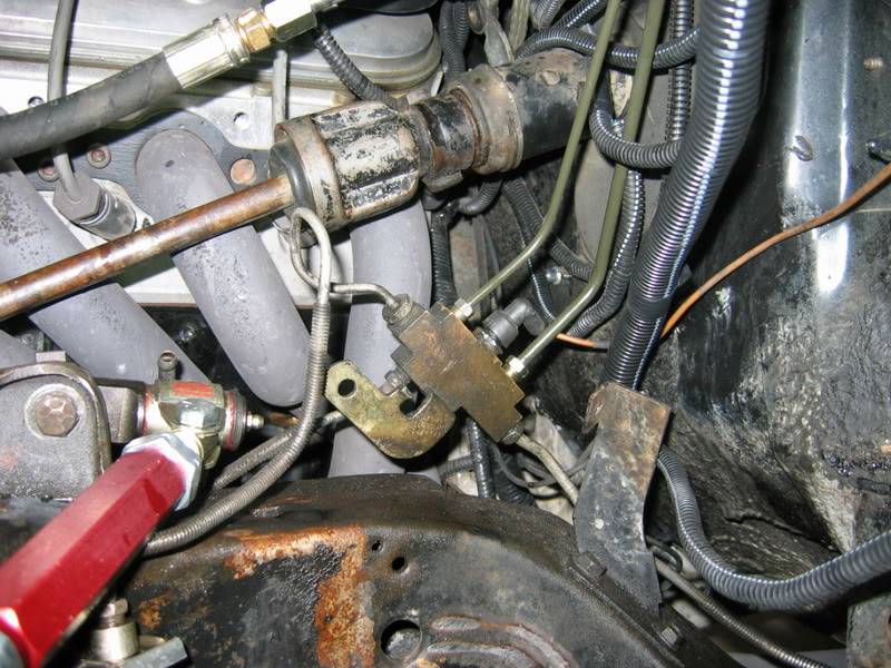

      Hey guys, I really need some help(yes this is like my 4th thread on it)
      I replaced my mastercylinder. Installed line lock and new lines. Couldn't bleed the brakes well at all. The rears would bleed fine and pump up very firm until I bled the fronts and the pedal would go to nothing.
      I pulled the line lock out thinking that was it, but the fronts still do not pump up(the rears do but loose the pressure once one pedal travel happens bleeding the front right)
      Any ideas guys? I really am getting frustrated with this.
      If it matters. 78 Corvette mastercylinder, baer proportioing valve, baer single piston rears, 4 piston fronts.
      Heres a couple pics of my setup. front line on mastercylinder is front, which is also the front on the block on the frame.(front= smaller line)

      2 problems I see. A this loop is a high point where air can hold up in. eliminate this high point. and B this kink isnt helping any. (pic makes it look like a kink may not be)

      Any luck Matt? The loop in the drivers front line is definitely a problem. I would also double check for leaks.

      The loop there is a problem yes, However it beld perfectly fine with the old brakes with that loop?
      Its not a kink but I will change that out. I tried again last night with no luck.
