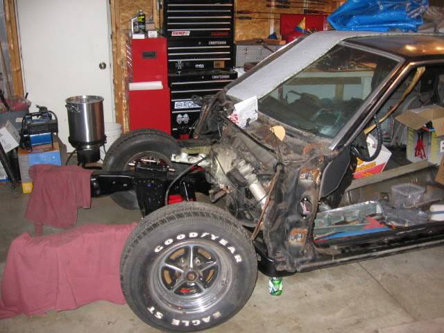

      I put the body back onto the frame tonight. I spent the last couple of days dressing up the floor pans and undercoating. Putting the body on was not that bad. I used new poly mounts to try and stiffen the car up some more. More Updates to come.

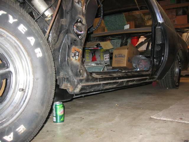

      PS. See the pop can? I stood on the front of the frame and the can got crushed. LOW ENOUGH???? About 4 inches from the frame to the ground at the lowest point.

      Nice work GBGM, I too am a Chevy powered Cutlass owner. You're lookin' good now but dude, your 200+ standin on it ain't gonna mean nothin once you put a motor and the doghouse on there but...still love it!

      Not too low but lower than than just the crushed Mt. Dew can, once you add in the weight of the motor, unless its a all aluminum small block. Hopefully your running shortys or block huggers because full length headers will scrape for sure. Still looks great though.
