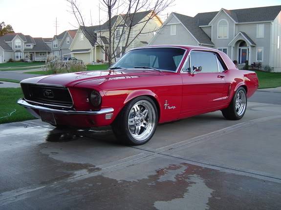

      Just thought you all needed another stang on here. So here is mine. Here is some pics and a run down on what is done to it. I am currently building another 67 coupe for a friend. Should be really sweet. I will post some pictures of it also with the progress on it.

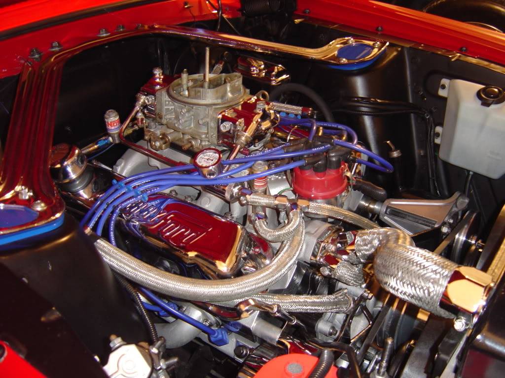

      342 STROKER.
      SCAT STROKER KIT 5.4 FORGED H BEAM RODS AND PROBE FLAT TOP PISTONS.
      302 BLOCK STANDARD BORE.
      10:6:1 COMPRESSION.
      NITROUS OXIDE SUPER POWER SHOT/100HP JETS.
      MELLINGS HIGH VOLUME OIL PUMP.
      PETE JACKSON "QUIET" GEAR DRIVE.
      JAY ALLEN (Camshaft Innovations) CUSTOM GROUND TIGHT LASH SOLID ROLLER CAM
      VICTOR JR.INTAKE
      TOTAL ENGINE AIRFLOW TRICK FLOW TWISTED WEDGE HEADS, FULLY CNC PORTED 205cc INTAKE RUNNERS 60cc COMBUSTION CHAMBERS. 2.02 INTAKE VALVES 1.60 EXHAUST VALVES.
      FLOW SHEET:
      INTAKE: EXHAUST:
      .100 71 .100 52
      .200 145 .200 105
      .300 219 .300 146
      .400 273 .400 180
      .500 305 .500 209
      .600 315 .600 228
      COMP CAMS 1.6 PRO MAGNUM ROLLER ROCKER ARMS,TRICK FLOW PUSHRODS.
      HOLLEY 830CFM CHOKELESS RACING CARBURATOR, HOLLEY 110GPH HIGH PERFORMANCE MECHANICAL fuel pump, WITH ELECTRIC RED HOLLEY STREET PUMP BACK BY FUEL TANK.
      MSD DIGITAL 6 IGNITION, MALLORY DISTRIBUTOR, TAYLOR WIRES.
      JET HOT COATED HOOKER COMPETITION 1 5/8 HEADERS 3inch FULLY MANDREL BENT DR. GAS X PIPE KIT WITH HOOKER MAX FLOW MUFFLERS.
      FEL-PRO GASTKETS, AND ARP FASTENERS THROUGHOUT.
      POWERMASTER 140AMP ALTERNATOR.
      CUSTOM BUILT AOD WITH NON LOCK UP 3000 STALL CONVERTER
      FORD 9INCH WITH 4.11 POSI TRAC.
      CUSTOM MADE ALUMINUM DRIVESHAFT.
      Suspension
      FRONT:
      Total Control Products front coil over suspension setup. 1 INCH FRONT STABILIZER BAR.
      REAR:
      5 LEAF REAR SPRINGS, KYB SHOCKS, 3/4 INCH REAR STABILIZER BAR WITH MIDOLYNE BUSHINGS, AND 1 1/2 LOWERING BLOCKS.
      BRAKES:
      BAER MASTER CYLINDER HYDRATECH HYDROBOOST.
      FRONT: BAER TRACK SYSTEM, PBR DUAL PISTON CALIPERS 13 INCH SLOTTED,ZINC WASHED AND CROSS DRILLED ROTORS.
      REAR: BAER TOURING SYSTEM, PBR SINGLE PISTON CALIPERS 12 INCH SLOTTED,ZINC WASHED AND CROSS DRILLED ROTORS.
      WHEELS AND TIRES:
      CUSTOM WELD WHEELS 17X8 IN FRONT. 17X9.5 IN REAR.
      TIRES ARE MICHELLIN PILOT SX MXX3?S.
      235 40ZR17 IN FRONT.
      275 40ZR17 IN REAR.

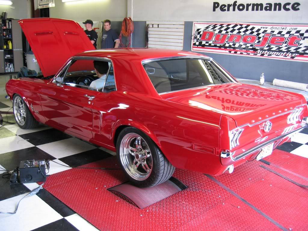

      I have some old dyno numbers but I have changed the Heads over to some Total Engine Airflow CNC ported 205 Trick Flow heads. I have also gone to a custom ground solid roller designed especially for my engine combo just this winter and I still have not even driven it. I also bumped up the compression a little. It used to make 340rwhp N/A and 345rwtq. Nitrous numbers were 431rwhp and 465rwtq. When I ran the nitrous on the dyno it was WAY off. It was so rich it filled the dyno room with black smoke so I knowthere was some tuning there to make more but really it runs incredible just the way it was.
