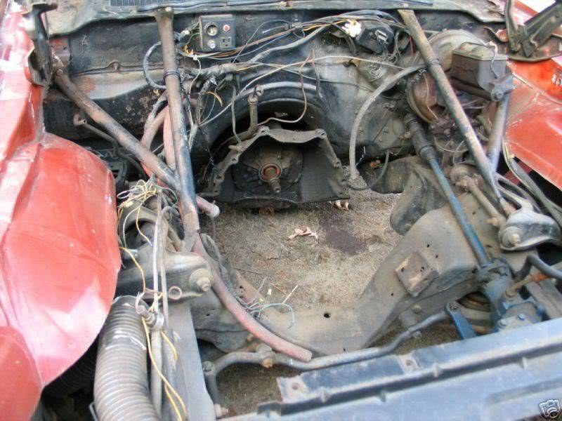

      just wanted to add this pic to see what Im dealing with. I think anything I choose will be stronger than the original peices

      With .065" wall tubing you should be able to bend it +/- 4" radi but it will be close.
      I would not waste your money on DOM tubing. Regular welded seam mild steel tubing will be fine and less than half the cost. Especially for something as simple as a g-brace.
      So I'd go with something like 1"x.095" wall round tubing.

      What is the box with the 120V plug on it?
