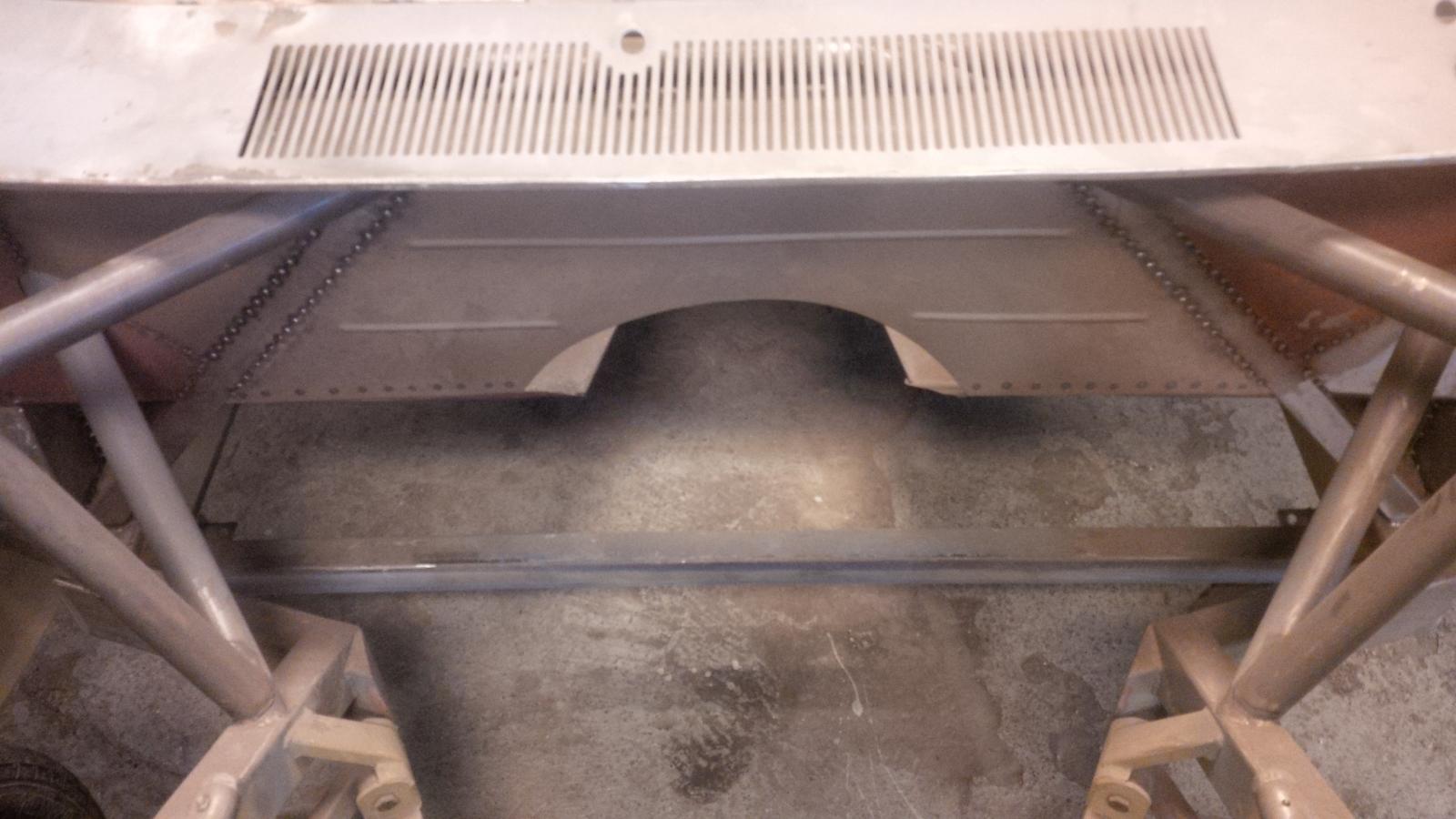

      More Pics
Size:  152.2 KBName:  IMG_20150308_130721.jpg
      As you can see the front firewall has been moved back..alot! Allowing that massive hemi to be moved back even more. The goal is of course 50-50 weight distribution. The other picture shows off some more of Mark Giles genius chassis building work.
