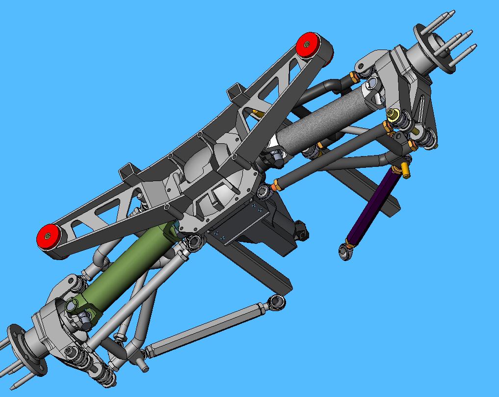

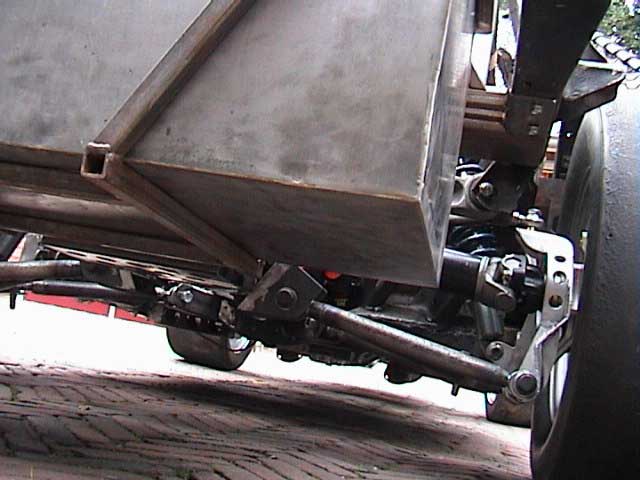

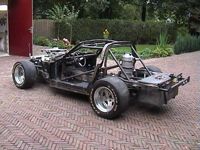

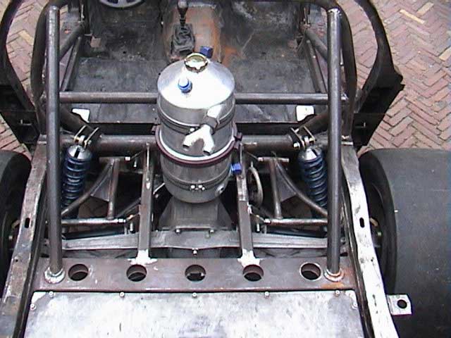

      Still lots of work to do though...in the mean time a lot has changed, I dumped the home made 5 bar rear suspension and built a double a arm IRS instead, figures why not do it right while I'm at it. As nice as the 5 bar with additional upper control rods was the double a arm was really what I wanted all along.
      After coming up with a design:
      I started building the components and this is the result
      Nov 2004
      444
      Country Flag: Netherlands
      It was a lot of work but IMO well worth the effort, I now have a funnly adjustable suspension that on top of being fully adjustable is also easy to adjust and opretty lightweight compared to the stock setup, on top of that the toe contol problems are completely eliminated, this should handle infinitely better

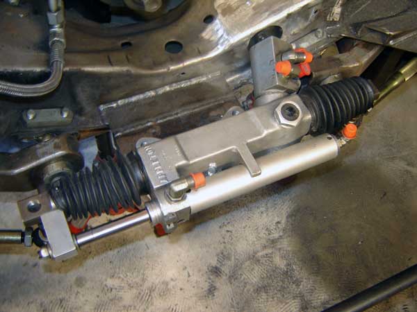

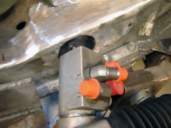

      I also finished the front steering end take off rack and pinion as you can see in some of the above pics, here's some details:

      Hows the scrub radius with such a deeply offset front wheel?
      Nov 2004
      444
      It's worse than stock by about 1/2"... not much I can do about it, don't want to change the kingpin inclination with expensive custom spindles, I could chop and reweld the spindle upright if it's problematic but it probably won't be. Neg. offset wheels don't look right on a C3 IMO and to look good you sometimes have to make a small sacrifice, so what if the steering takes a little more effort, I can easily change the servo to change the assist and I have several rack shafts so I can change the ratio also, it won't be a big problem.

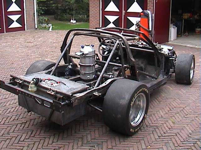

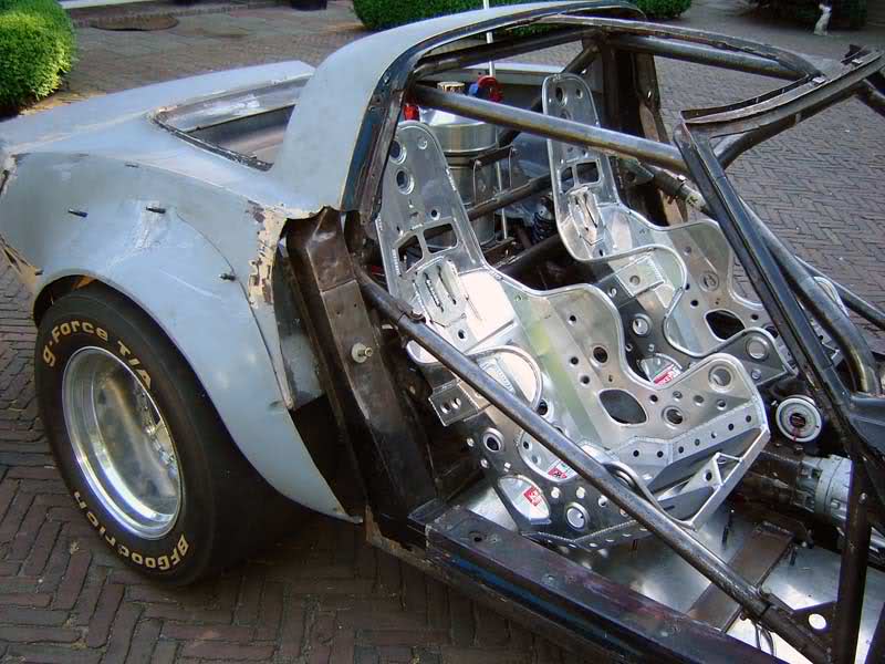

      sheet metal interior. Here's a start. I lowered the floor significantly because I had a hard time fitting in the car:

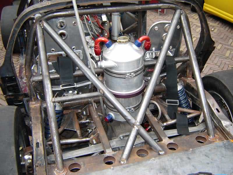

      I have since finished the cage, I'm not adding any more tubes to it. This rear cross is the last section, had to do it like this because of the dry sump tank. I will change the horiz beam for the seat belts to one the same size as the rest (1&5/8) and add one on the other side. The smaller section really looks out of place. Good thing it's not final welded yet.

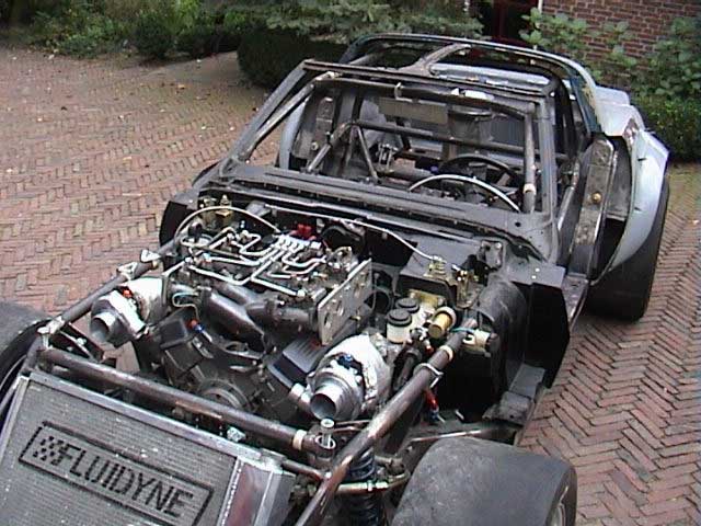

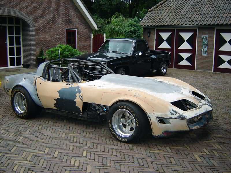

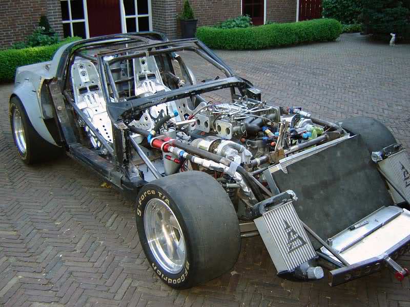

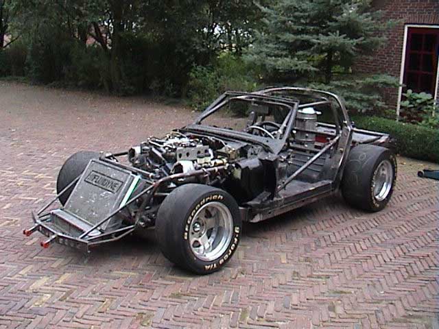

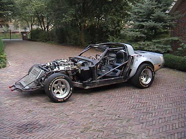

      Can someone move this to the updates section? Anyway, it's starting to look like a car again:
      The front clip is just sitting on there, I need to redo the hinge (it's a large clamshell front) because I modified the front frame extention for the intercoolers and some other tids and bits. Also the front flares have been taken off, they were clecoed on there, like the rears
