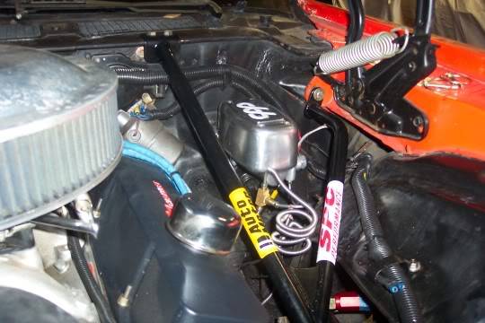

      Installed:
      If you want to get them now, just call Alston Racing.
      http://www.alstonracing.com/
      Scott from NJ.
